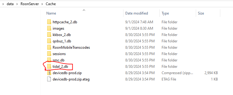

Actually, yesterday everything seems back to normal and without any issue for 3 hours. Anyway, I also did what you suggested (but it was after 3 hours when I saw this message).
I will how it goes later today and thanks for the advice.
