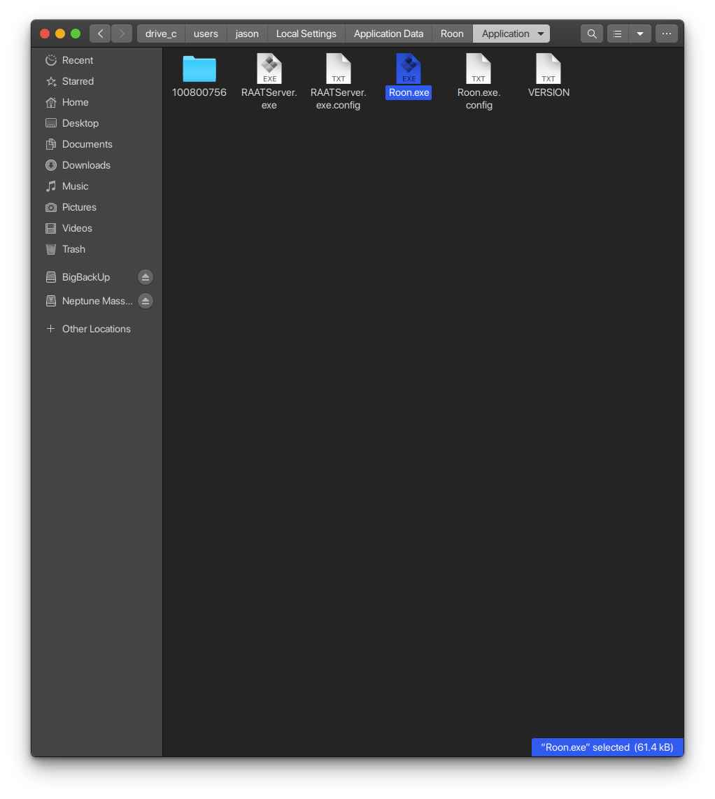

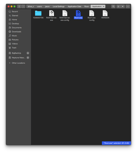

That text editor is exactly how it looked when I opened the .desktop file, all the hashes were there before. The .exe file works fine, I click it and Roon opens fine, but of course a shortcut on the desktop would be easier than digging into the file system each and every time I want to run the Control GUI.
Perhaps it looks different because I did not use the script to install Roon, I did it from scratch. This is where Wine installed Roon. I changed nothing.

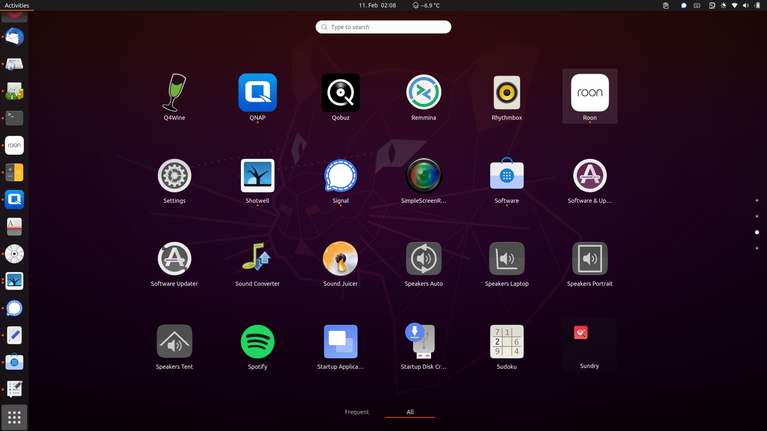

When it is there, it will be displayed like all application launchers in Gnome. E.g. in Activities (top left of the screen) after searching for it:
Or in the applications view (the button bottom left of the screen):
In either place you can right-click it and then Add to Favorites. It will then be added to the dock on the left of the screen, as you can already see in the second one of my above screenshots.

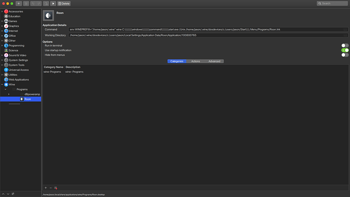

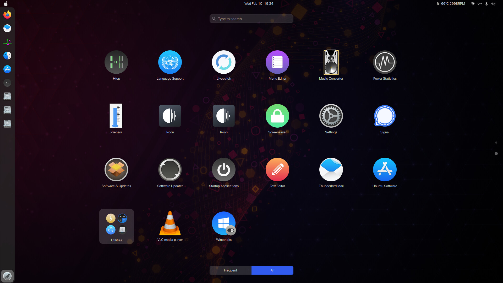

I installed MenuLibre and now I have TWO Roon icons in my applications menu and neither of them work.
That may well be the one from 1.7 and the one from 1.8. This does not hurt but it is not pretty and can obviously be annoying because you never know which one works. It does not matter which one you keep, it just needs to have the correct content. I would use the file manager to search for Roon.deskop in your whole home directory, it should find them all. Simply delete the one you donât want.
When you open menulibre and search for Roon, it would normally also show both, though yours does not. If it does, you can select one and the statusbar of menulibre, at the bottom of its window, shows the path to this particular file (like in your menulibre screenshot as well)â
You donât have to, I just find it convenient. You can also edit the file in a text editor. The important thing is that the file is saved in the correct location under .local/share/applications somewhere, so that Gnome finds it.
If you edit in menulibre, you can click the Play button in the menulibre window title bar to show it as the text version for checking, can be helpful. And after you edit it, you must click the Save button in the window title bar, it is to the right of the â+â button.
Note that in the Command entry in your menulibre screenshot, the path does not point to the Roon.exe but to start.exe which runs the Roon.lnk file (which is basically the Windows equivalent of a .desktop file, i.e. a menu entry definition). Maybe this can work for Wine, but maybe it is the reason the launcher is not working. In any case it seems overly complicated and error prone. I have no idea how it got there, never seen this. I would replace it with the command you had in the first screenshot of the Roon.desktop file on the Desktop (in Exec=)
I am getting an error message that says directory 100800756 doesnât exist⌠(roon updated to build 756)
WellâŚ
What is the exact message? Most likely it cannot find the path to the directory because something is weird with it. Did you test the Working Directory path in a terminal like I asked you to?
(Navigating there in the file manager is not the same thing)
You can also use the âfolderâ buttons in menulibre, next to the two paths. This will ensure that they are right. Keep in mind that this will enter the path to the Roon.exe in the first box, but not the WINEPREFIX or wine command, so copy them back in
