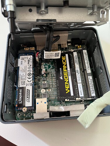

The NUC was indeed very dusty. I vacuumed its cover and opened it up to see if there was any dust there (very little and I can’t see a fan). But when I opened it a strange piece of plastic / rubber fell out and I have no idea where it is supposed to be (see lower right side of image). Also, after I start the NUC, only the startup screen shows (with BIOS keys) and the boot does not continue. Is it possible that something has been destroyed by overheating?
I don’t have a keyboard yet so I can’t go into the BIOS. But that will be my next step. Until then I would be very grateful for any tips:
  • What is this rubber thing?
  • How would I go about to get the NUC running again or find out if some of all of it is wrecked?
My guess is a heat soak. Probably went on the Kingston A2000.
The fan on these things on are the other side (bottom). You have to remove the motherboard to get to the back to blow it out.

I’m not sure how to remove the motherboard without having to remove the silver colored soft parts (heat sinks?) that seemed glued to the casing.

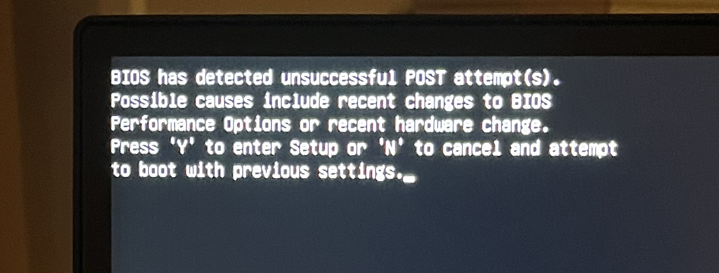

I’m shown the BIOS boot screen for a couple of minutes with the following options
F2 to Enter Setup
F7 to Update BIOS
F10 to Enter Boot Menu
However, the computer is completely unresponsive to key presses. I know that the keyboard works because after a couple of minutes the screen goes black and this screen is shown.
If I press N here, the computer resets and goes back to the previous screen. However, if I press Y, nothing happens, even if I now press N.

  6. Restarted the computer. It started and restarted about 3 times, and then the BIOS screen with F2, F7, and F10 keys appeared again.
However, it is still unresponsive to keyboard pressings. Again, after a couple of minutes the computer resets and the unsuccessful POST attempt(s) screen appears. However, this time it is not responsive to either Y or N keypresses.
I’ve tried plugging the keyboard into all four USB ports, doesn’t help.
So I fear my NUC is fried? Should I try with another keyboard?

  • I bought a new keyboard but F2 still doesn’t work. However, this time I left the computer on when the POST failed message was shown, and after a while it entered the BIOS setup. A quick try indicated that the keyboard works in there. I’ve gone on vacation now and will troubleshoot in a couple of weeks.
