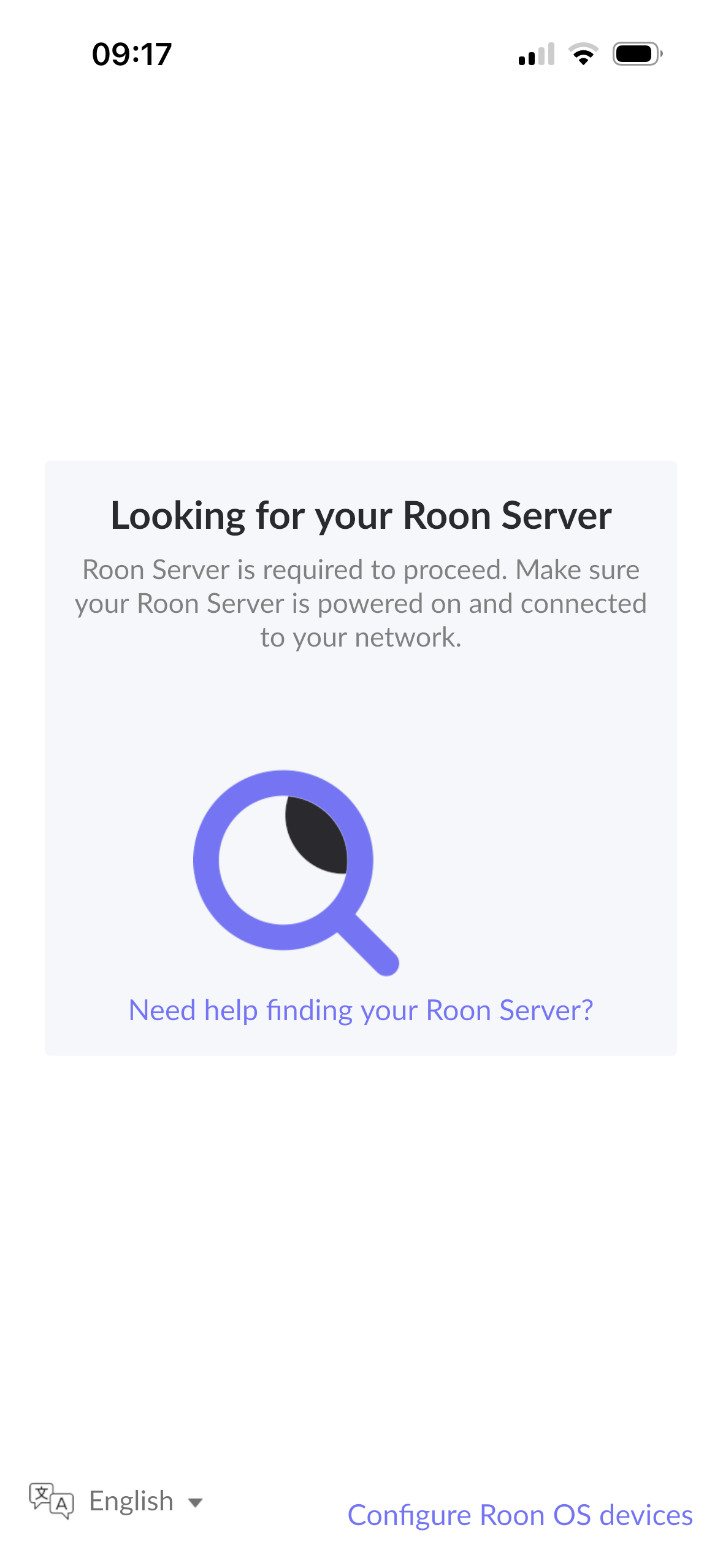

I have been running a Roon core on a QNAP NAS for years, without issue. Recently I noted that my roon app on iOS couldn't find the Roon server. It was also blank on the NAS. I then updated the firmware on the NAS, and the Roon app on the NAS. The Roon core then reappeared on the NAS, but was still invisible to the iOS app. I could connect to it via ARC at that stage, but it is now not connecting on ARC either. The NAS seems to be running fine. I backed-up, deleted and reinstalled Roon on the NAS, and, again, it is visible on the NAS UI, but the iOS app is still unable to find the server, even when entering the IP address manually. I have also reinstalled the Roon app on iOS to no avail. Please advise as to next steps?

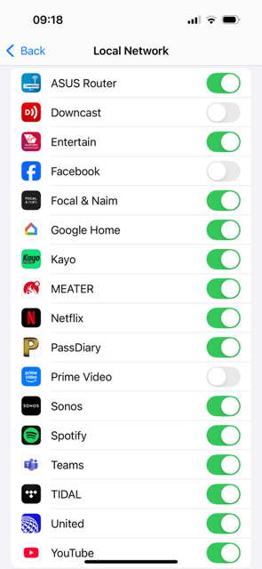

Thanks Vadim. I did as you suggested, but Roon is not in the list of apps requesting local network access, so there is no toggle to switch…
Hello @nickcpw
Thank you for the update. Would you kindly share a few screenshots from the iOS devices?
Hello @nickcpw ,
Thanks for the screenshot. That is very strange, Roon app should most definitely be showing in that list. Is there any change in behavior if you delete Roon, reboot the iOS device, and then reinstall the Roon app?
