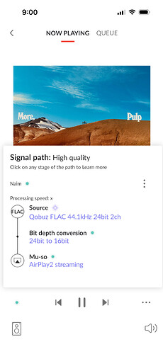

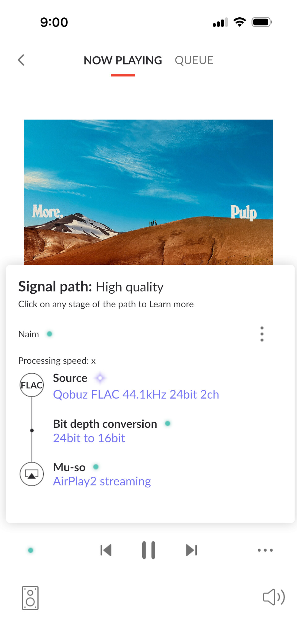

I can play Quboz thru Naim app directly but no Roon option in settings and iy shows playing in Roon app but no sound coming out like in picture below on all Roon Ready Devices . Also ONLY Airplay which is my main reason to use Roon–>for better resolution.

You are connected to the Mu-so using AirPlay, the signal path is correct in this regard.
Please confirm the above–sharing a screenshot of enabled devices. But note the original Mu-so isn’t Roon Ready.

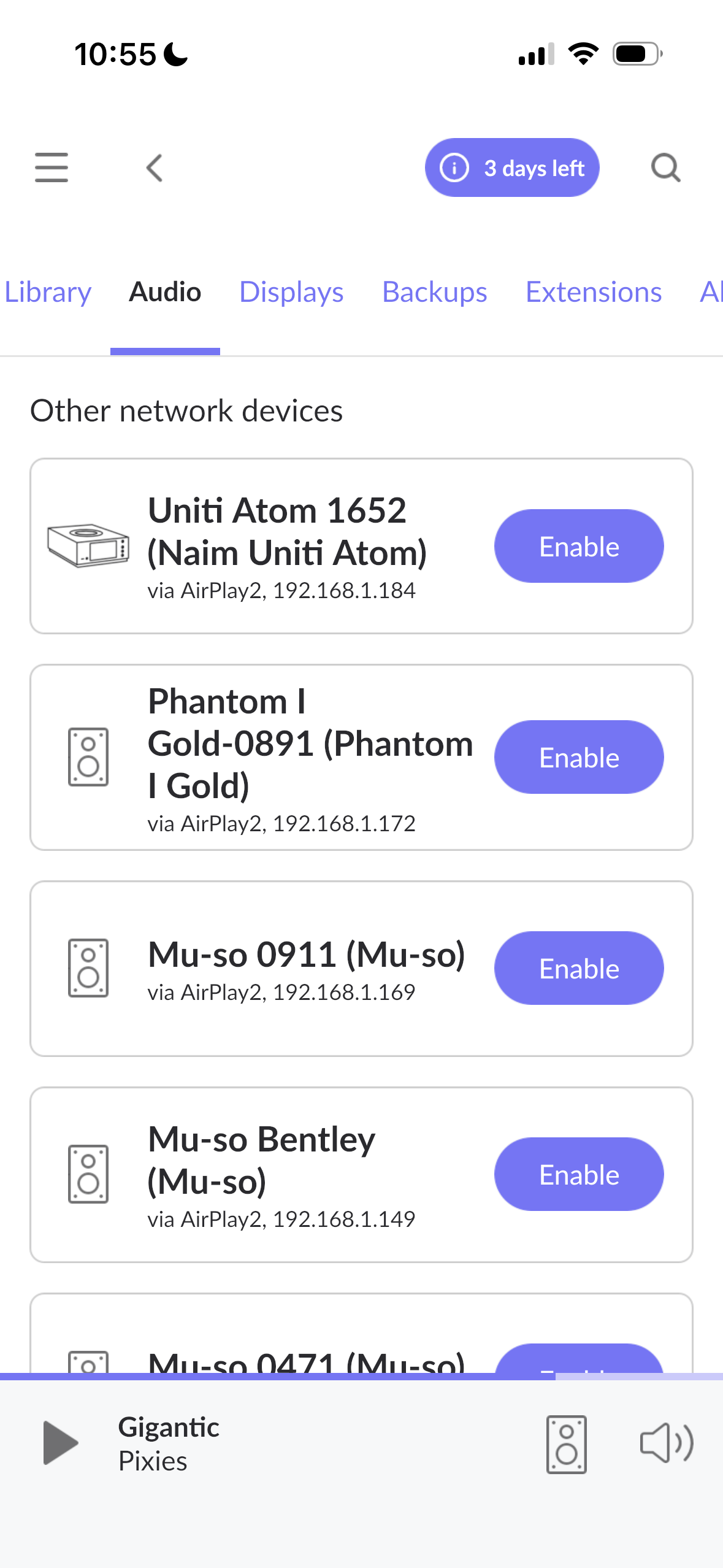

No they ONLY appear under “Other Network Devices,” All apple TVs and Homepods appear under the correct section along with Bluesound Powernodes. To confirm: Naim Mu So Bentley Edition is NOT Roon Ready? Any ideas to test besides adding Roon Bridges to the devives connected ? USB i.e. Raspberry Pi

Thanks for letting us know. Since only the Airplay options appear, I suspect this could be an issue with the firewall blocking Roon from discovering Roon Ready devices on the network. I noticed you also have a Mac registered to your account, is the behavior the same if you try to temporarily host the Roon Server on that device by going to Roon Settings → General → Disconnect → Use this PC as Server? If the issue only occurs on the Ubuntu device, I would suggest checking the Ubuntu firewall settings, the below thread can help:
https://community.roonlabs.com/t/please-help-with-firewall-settings-on-ubuntu/228924
Yes, UFW rules were blocking on Linux Server running Core. Solved and Lifetime Subscribed.
