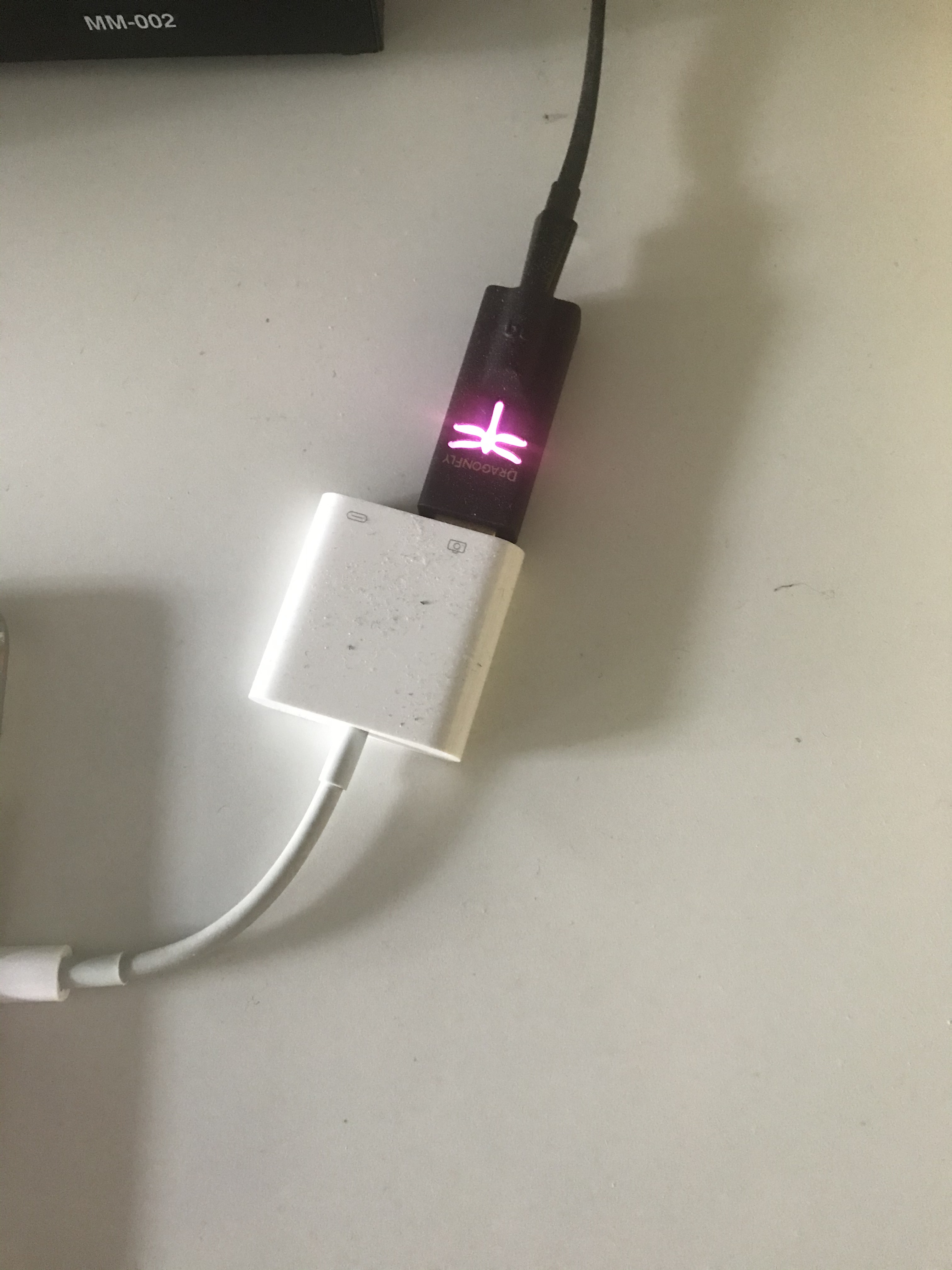

iMac as Roon Core. I control music through iPad.
Wifi Network with Ethernet coming from my Wifi Extender to the Mac.
iPad plugged into Dynaudio Connect box which streams to Dynaudio Xeo2 Active speakers.

Correct iPad USB out to DAC which connects to back of Dynaudio Connect box.

I have a Mac running the Roon Core connected via Ethernet to Wifi Extender.
My endpoint if I’m using the terminology correctly is the Ipad mini with Dragonfly DAC which is connected to the Dynaudio connect box-Xeo 2 active speakers.
