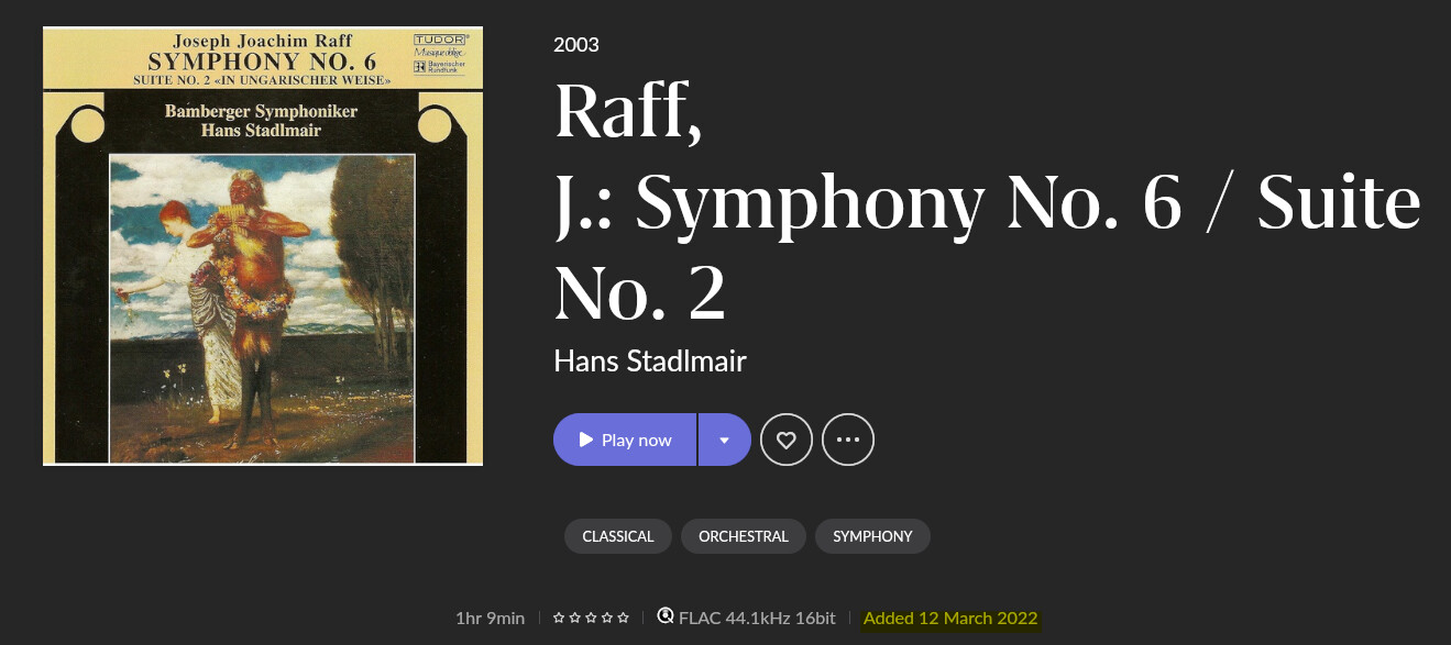

thank you for your support. I have updated to the latest version, uploaded the logs of Roon and RAATServer of the Windows 10 Remote that was crashing to the link you have provided. I have then created a backup of the database (on the RoonServer), renamed the Roon folder on the Roon Remote and reinstalled the Roon App. I have changed the settings as I am used to.
Then I tried to add the album above that repeatedly did not add before and now it added at the first attempt:
I have then searched for the composer that made the Roon Remote freeze and this also works now at the first attempt as expected:
Based on this first two tests I can already say that it fixed both. If you could nonetheless check the logs and I will report any upcoming effects.
