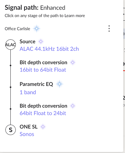

The 720+ is hardwired directly to the router; however the Roon endpoint being used was a Sonos pair of speakers, so wifi. I do have a SoTM Neo endpoint in another setup, this is hardwired, Can also listen there to see if issue persists. Scene shot of signal path attached.

@Christopher_Peterse1, also see if turning off PEQ helps. PEQ is using additional CPU resources that may be limited by the 720.

  2. Using ‘Muse’ (simple low-shelf filter) does not degrade performance. so all good.
