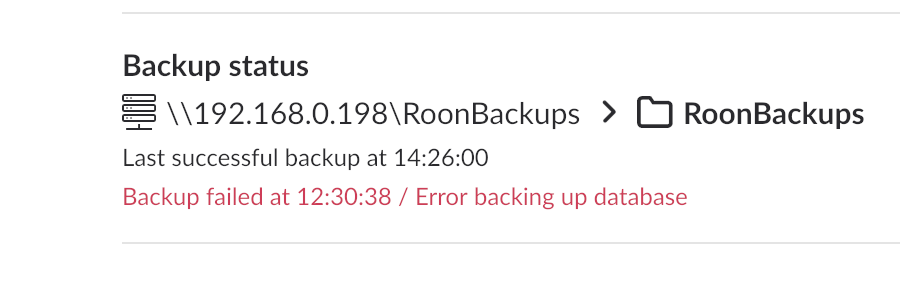

Adding: tried multiple times. The relevant logs (do you need me to send them?) show several failures between 12:20 and 12:30 Pacific Standard Time on Thursday February 5.
I tried restarting Roon and even restarting my Mac Studio M4 running 26.2.
Backup has generally worked will until now.
Web interface for my Titan reveals everything OK. Plenty of room on the target volume (that device’s Macintosh HD): over five TB. Nothing has changed on my Samba settings etc.
Happy to supply any further details. Thanks in advance…

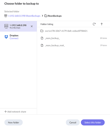

I can’t imagine that 192.168.0.198 is not my Mac Studio as seen from Titan:
Nothing has changed in any of my devices, router (Synology RT6600ax) or Nucleus etc! Not using Arc. All connections Ethenet.

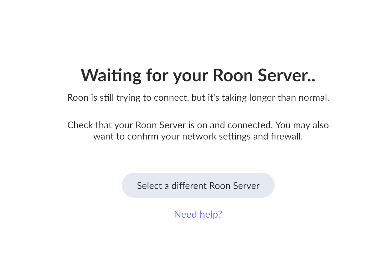

I spoke too soon, @Benjamin :frowning:

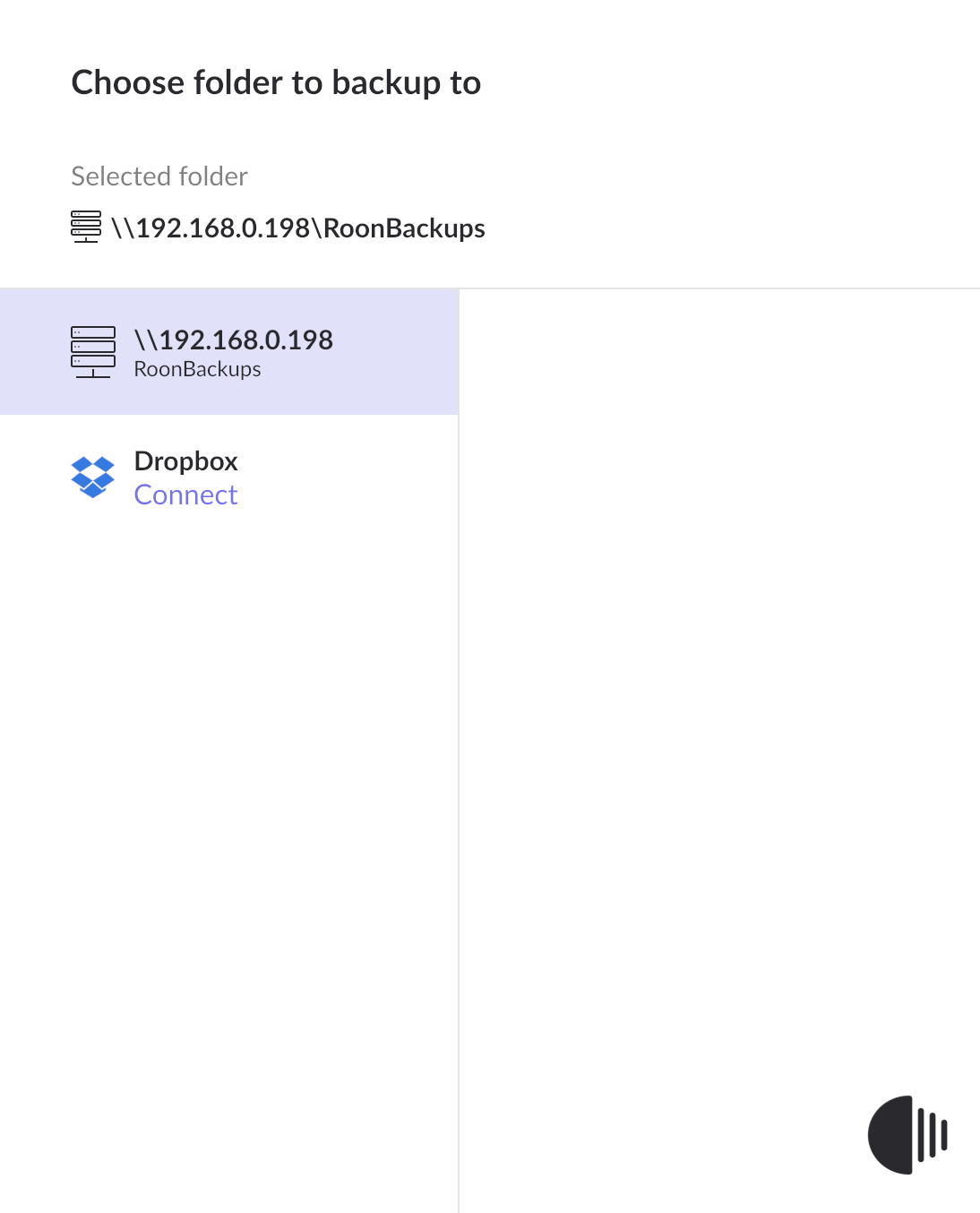

I tried a manual backup again today and Roon was unable to find the target backup folder on my Mac:

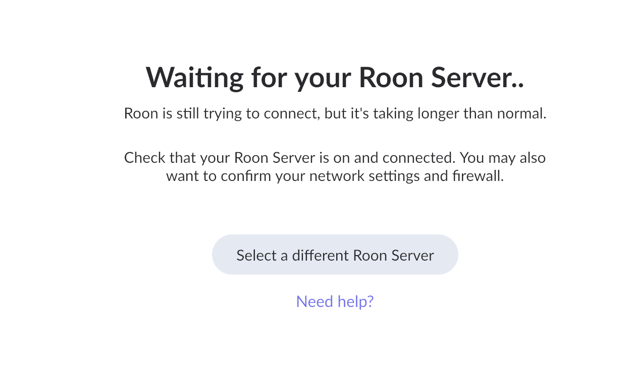

So I restarted the Roon Server on Titan from its web interface. Then I got this:
Neither a (‘soft’) reboot of Titan from the web interface nor a restart of my Mac etc would help.
So I tried a manual ‘hard reset’ of Titan: its push button with a short delay (under four seconds) as instructed previously.
That did not work.
In the end I had to do what I have actually had to do several times recently (but not asked for help with here because I hate to think something is really wrong).
I had to remove the power supply from Titan and re-insert its plug.
Waiting the appropriate amount of time then finally allowed Roon to see Titan. I have been able to see Titan via Samba all along.

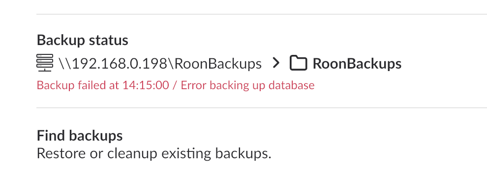

So I tried a backup.
That failed:
I’d really like your help, please, in getting to the bottom of what’s going on here; and how I can fix it once and for all.
The relevant logs will be between 14:00 PST (2 PM, California) and 14:15.
It strikes me (I may be wrong, of course) as though there are two (connected/related, or unconnected/unrelated) errors/faults here:
  1. if it’s the Sentry logs again, what are they? Why do they keep causing these errors? ‘RoonServer/SentryCache/Sentry/8344EDE5E2FA9DB5A6562D82C1517C6FA5F0AE82/1770502499’ is certainly missing. I can see how that might cause an error; but I shouldn’t have to keep deleting it manually, should I? ‘Sentry’ is not something I have installed…
  2. Why does Roon keep failing to see Titan after errors like these; and why doesn’t a reboot etc work? I shouldn’t have to keep disconnecting and reconnecting the power, should I?
Please say if I can help you to fix this permanently, @benjamin and team.

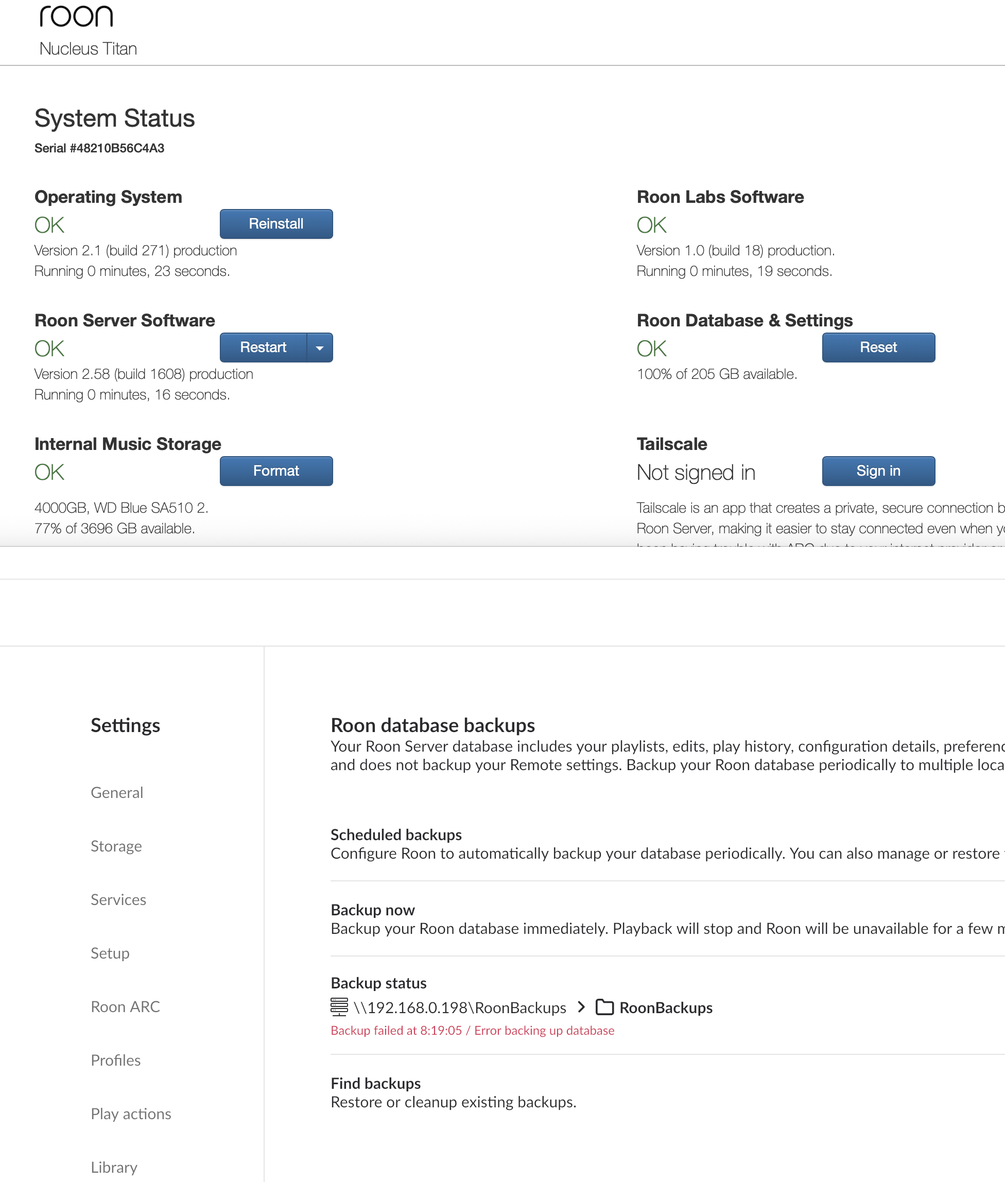

I reinstalled RoonOS thuis morning (relevant log entries will be between 08:15 and 08:20 PST.
But still get the backup error. See grab (below).
Kindly note that this is not the only error; and that rebooting Titan is also problematic… I usually have to physically remove the low voltage power supply cable/plug from Titan’s front…

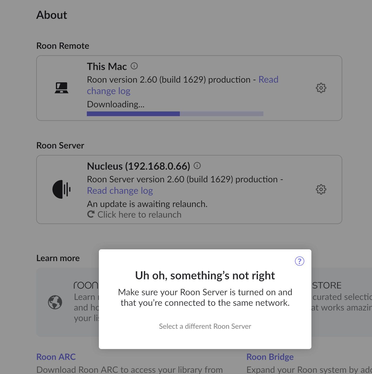

Today - somewhat against my better judgement (this has been going on for almost a month now) - I tried to update to today’s 2.6.1 (build 1639).
I got these errors and had to remove and replace the power cable from my Titan in order for Roon to work at all.
Neither Restarts in the web interface nor indeed Reboots (top right red there) worked, although I was able to see the nucleustitan volume in the Finder after a short wait. Roon was not :frowning: .
You’ll be able to see what happened - in the logs - between about 11:30 and 11:50 PST today.

We have inspected the logs from your machine and can see that after an update, your system placed a lock on the Roon Server process.
This means that another related process, likely an updater, was running in the background and prevented the Roon Server instance from starting.
We can see that later, likely after a reboot, Roon Server started normally.
