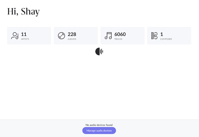

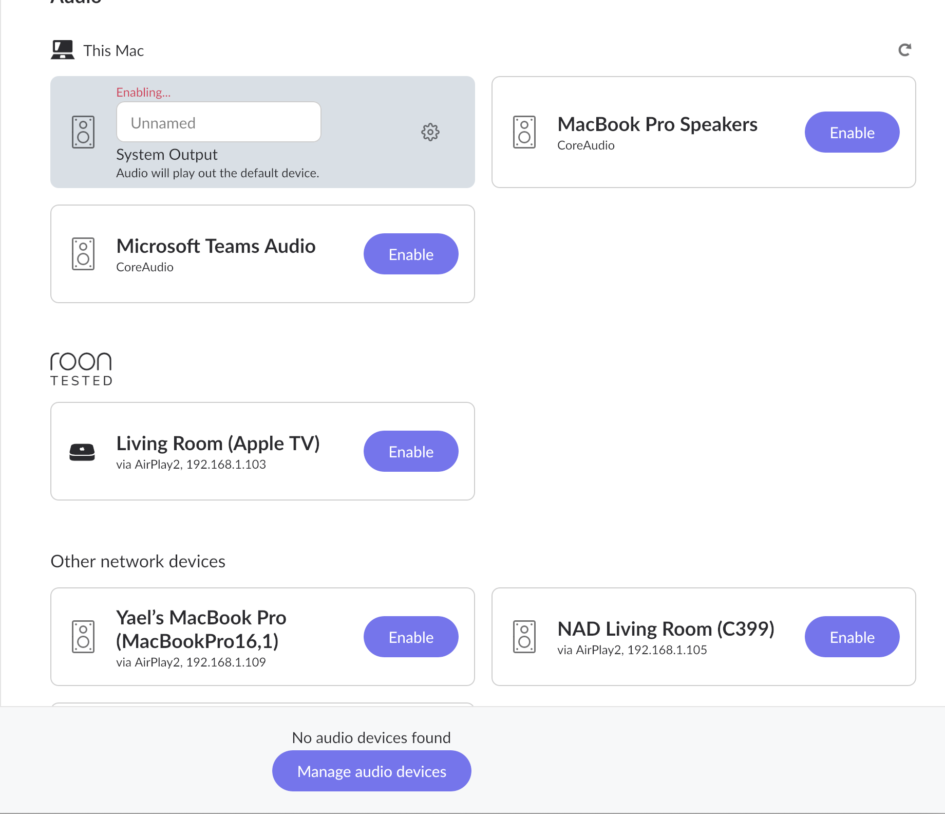

my Roon shows "no audio devices found" and no zone is available. The audio settings seems to be frozen and I can't get anything to work.

Welcome to the forum! Has this been a working setup in the past? Was this a fresh MacOS install or an import from an existing install (from a Mac Migration Utility/Time Machine)?
Can you please navigate to macOS System Settings > Privacy & Security > Local Network , and make sure Roon is allowed. If it is already enabled, toggle it off and on again. Then reboot your Mac, and see if the same issue persists.
If the issue is still the same after, you can try to generate a new RAATServer instance on your device by following these instructions, but please be aware that this will reset your Roon Settings → Audio Tab to factory settings and I would advise making a backup of any custom DSP settings you have:

Hi. It didn’t help. Now Roon won’t show me my albums. The app looks like this
Hi @cusamano ,
Thanks for letting us know. I’ve activated diagnostics for your Roon Server and I am noticing quite a lot of errors surrounding database access, it looks like this might be a permission or a space issue. Does the PC hosting the Roon Server still have adequate free space available? If it does, your best next step here would be to try a fresh install and restore from backup:
