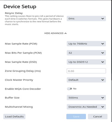

When trying to listen to a DSD 512 file on Nucleus, it only reproduced the sound for 25 seconds after which a message appeared stating “An audio file is loading slowly. This may indicate a performance or hardware problem”. I tried in Device Setup to increase Buffer size to the maximum without success. Will there be incompatibility between the devices or can I solve the problem?

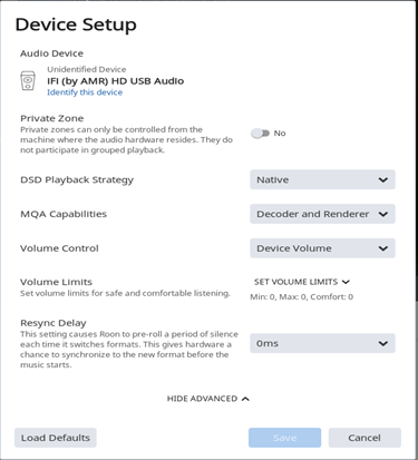

Can you share a screenshot of Device Setup for this Zone?
I didn’t notice anything about my Roon’s operation
I send the screenshot you requested:
Do you have Parallelize set in the DSP DSD Processing Options?
Thanks for the sugestion. It worked perfectly …

Glad to hear that the Parallelize Sigma-Delta Modulator setting has helped! This setting splits up the DSD conversion into multiple threads so that more CPU cores perform this conversion process instead of just one core. Also, to answer your question - no audio quality is lost.
