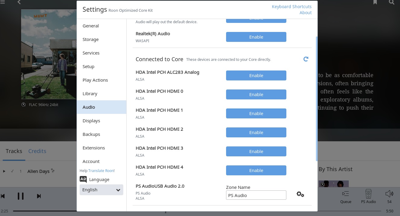

Can you share a screenshot of what you’re seeing when you go to Settings > Audio?

Here is a screenshot as of about the time I did the posting.

I believe the screenshot Dylan was requesting should look something like this. I was wondering if outputs may be disabled in Settings - Audio.
Thank you George. I think that I now see the problem.
Settings%20audio|568x500
Dylan,
After enabling the devices, things are working again.

It doesn’t seem that my screen shot posted properly so I will try again. After I enabled the devices, things are working again. Thanks for the assistance.
Hi @Timothy_Good,
I can’t say for sure what caused them to be disabled, but thanks for the update here and glad to hear that things are working properly since re-enabling the devices. Hope you have a great day!
