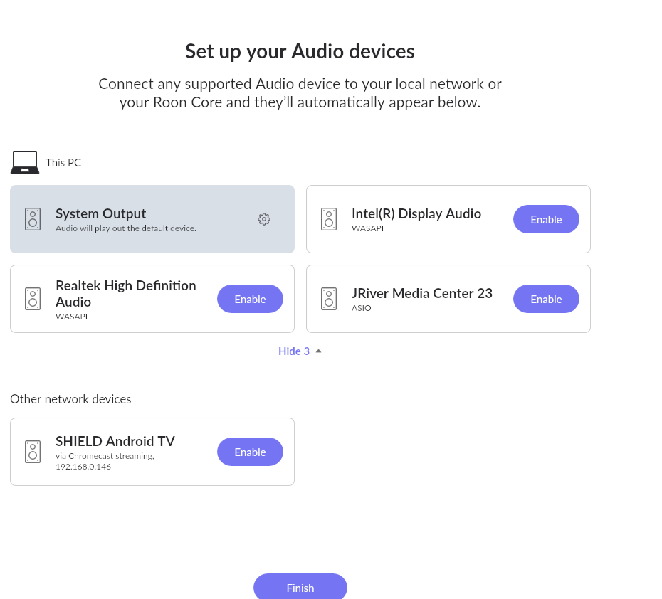

I am in my trial period with Roon and its not working.
I have a Sonore MicroRindo as my end point connected by wire to my network.
I have tried to to connect with both an older Mac Mini and a fairly new windows PC.
But both fail to see the MicroRindu
I have set the microrendu to Roon ready on the sonore site. It had no problem finding the MicroRendu.
I have tried powering everything down and restarting several times - to no better results.

Roon Core Machine that I want to have work is this one.
The Mac Mini is the 2.5 GHz Dual-Core Intel Core i5
  • GB 1600 Mhz DDR3
    running Catalina V 10.15.7
Networking Gear & Setup Details Both the Mac Mini and the and the sonore MicroRendu are connected by ethernet to a Netgear GS305 switch.
Both ethernet wires are new Cat7.
The Mac Mini has Zero tracks saved on board but I have liked maybe 500 tracks in Tidal.
I sent a screenshot of the issue in Roon - if you cant see it its because I may not know the right way to send it
Not sure if this is relevant to you but Roon did not see my microRendu unless the attached DAC was powered on (and set to the correct input)

Hi Jeff thank you so much its pumping out music right now!
Thank you so much - it was the setting on the DAC
