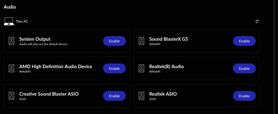

When i launch Roon on PC i can only choose network devices that are all in same network as PC but i cant see any PC audio output device.

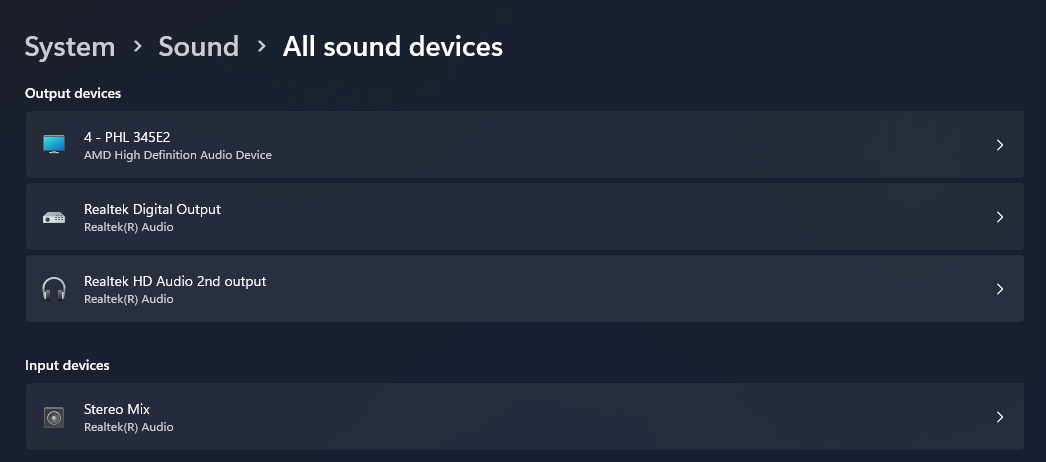

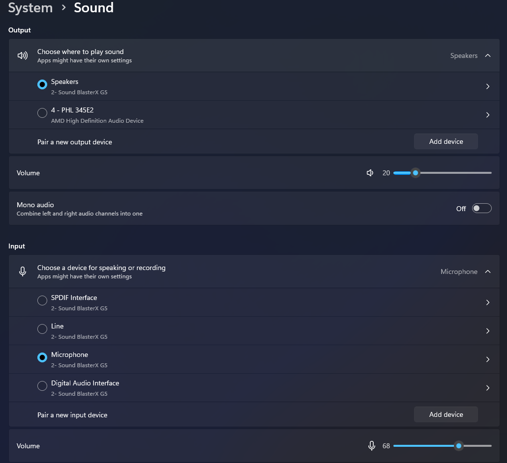

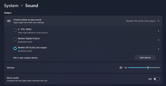

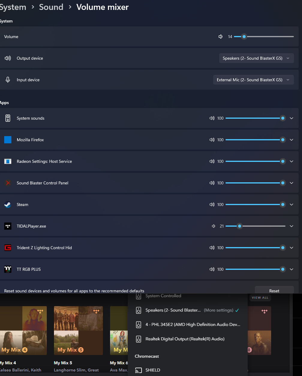

Following up on this thread, are you still running into issues getting your system output to play audio? If so, can you share a screenshot of your PC system sound settings?

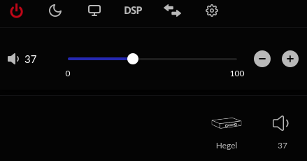

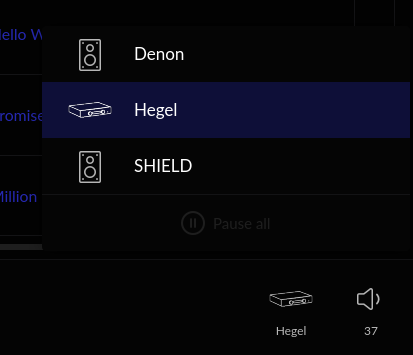

With that, I’d also love to see a screenshot of your output selection on your roon remote screen (bottom right-hand corner of the app, to the left of your volume icon) please click the speaker icon to see what options you have :+1:
Hi. Yes i still have this problem.

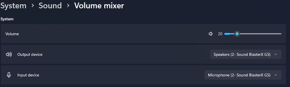

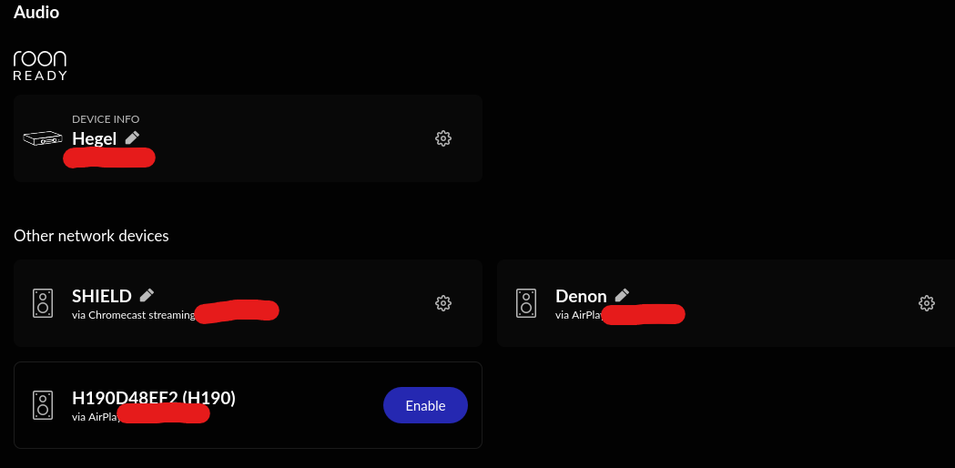

Here are screenshots. Hopefully what You asked. Clicking speaker icon shows the integrated amp setting only thou.
2022-11-13 120236
2022-11-13 120045

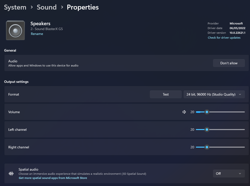

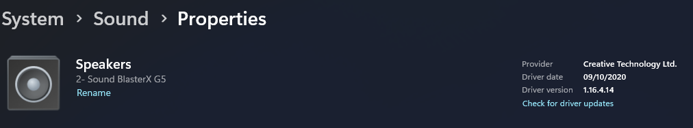

I even tried to use windows own driver update, it installed older Soundblaster driver but issue didnt go away. So i’m confident its the Roon app issue that doesnt see G5 sound device. Playing from Tidal app directly sees PC sound device.
Here is older driver i tried also.

From the screenshots you’ve provided, it appears as though the SoundBlasterC G5’s are acting as the soundcard for your PC. What happens if you disable them and unplug them from the USB port on the PC? Do you see any options for system output after that?
It’s odd to me that even under your system sound preferences, there is no system output option displayed.

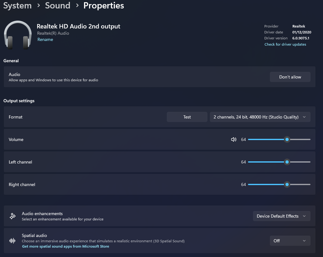

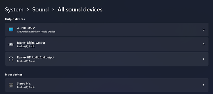

SB G5 is actually sound card device its just external version via USB not the pcie version. I tried also disabling and unplugging G5 and enabled PC internal realtek sound device. It seems same issue, Roon cant see device even its working and sound is working elsewhere in windows or games/other software.
It seems when i disable all output devices on PC it doesnt change nothing. Roon app wont change in that regard. My assuption is that, something is wrong with app not able to see any PC output whatsoever.
Roon app just doesnt see any sound device from PC.

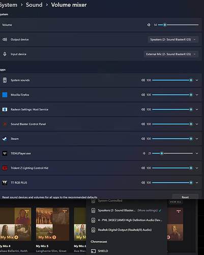

Tidal example sees PC internal device fine same as was with G5.
Tidal shows system as well RealtekHD

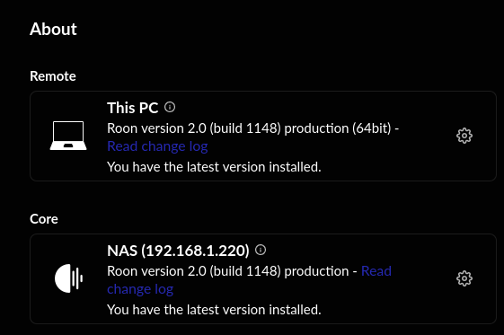

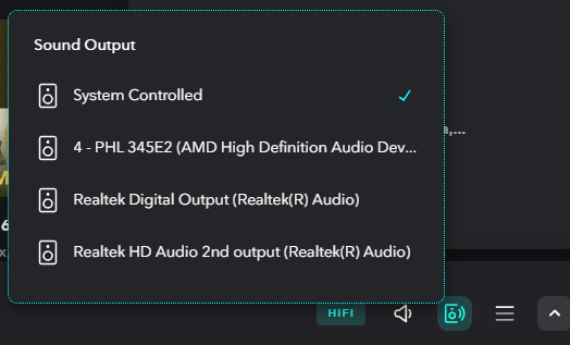

2022-11-15 110754
Latest version installed.
2022-11-15 112403
And all sound devices enabled. Tidal app shows sound.
