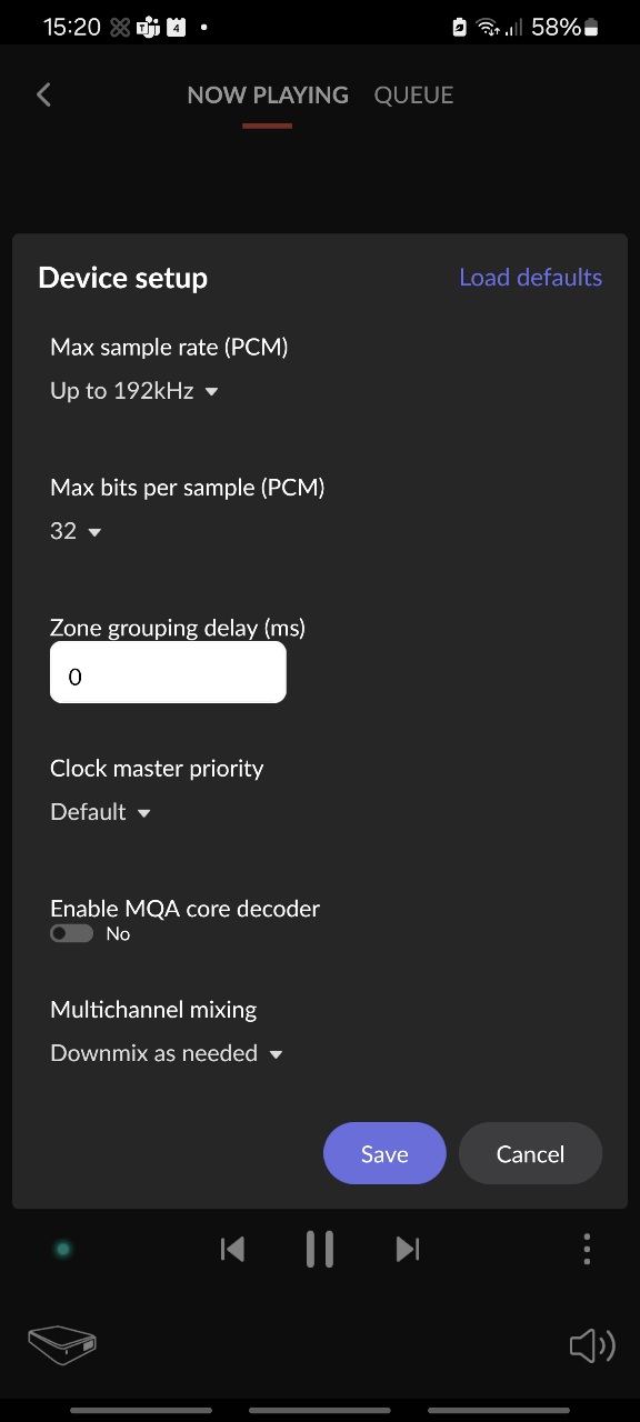

I bought the Hifi Rose RS130 streamer prior to Roon finalizing it’s certification and were under the assumption all things Roon would be running smoothly. However, I’m experiencing the following setbacks when wanting to play higher res files:
  • DSD files higher than DSD64 are being downsampled
  • PCM files higher than 24/192 are being downsampled
    Both by Roon before feeding them to the streamer. This is seen in the Roon app, on the streamer. On the dac and when trying to play DSD256, the screen is sometimes showing consecutively and continuously: DSD256 - 705.6/01 - 705.6/24. Other times, it just shows the resolution Roon’s providing.
    The result is indifferent from selecting native DSD, DoP or even DSD to PCM on the RS130.

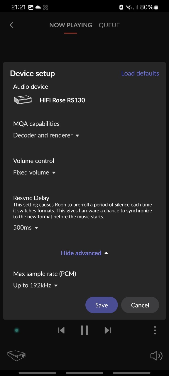

    BTW, in Roon’s device setup DSD isn’t shown and the max sample rate is 192 kHz and the max bits per sample is 32 (see images below).
Strangely, this doesn´t happen playing the same files using a USB cable, instead of the I2S.
When using the I2S and playing the same files using Rose’s own app, they are played in their native (mostly DSD256) res. So, it’s neither the streamer, nor the dac.

In the device setup - advanced - what is the max dsd sample rate set to?
That’s one of my points: there’s no such option - at all.
