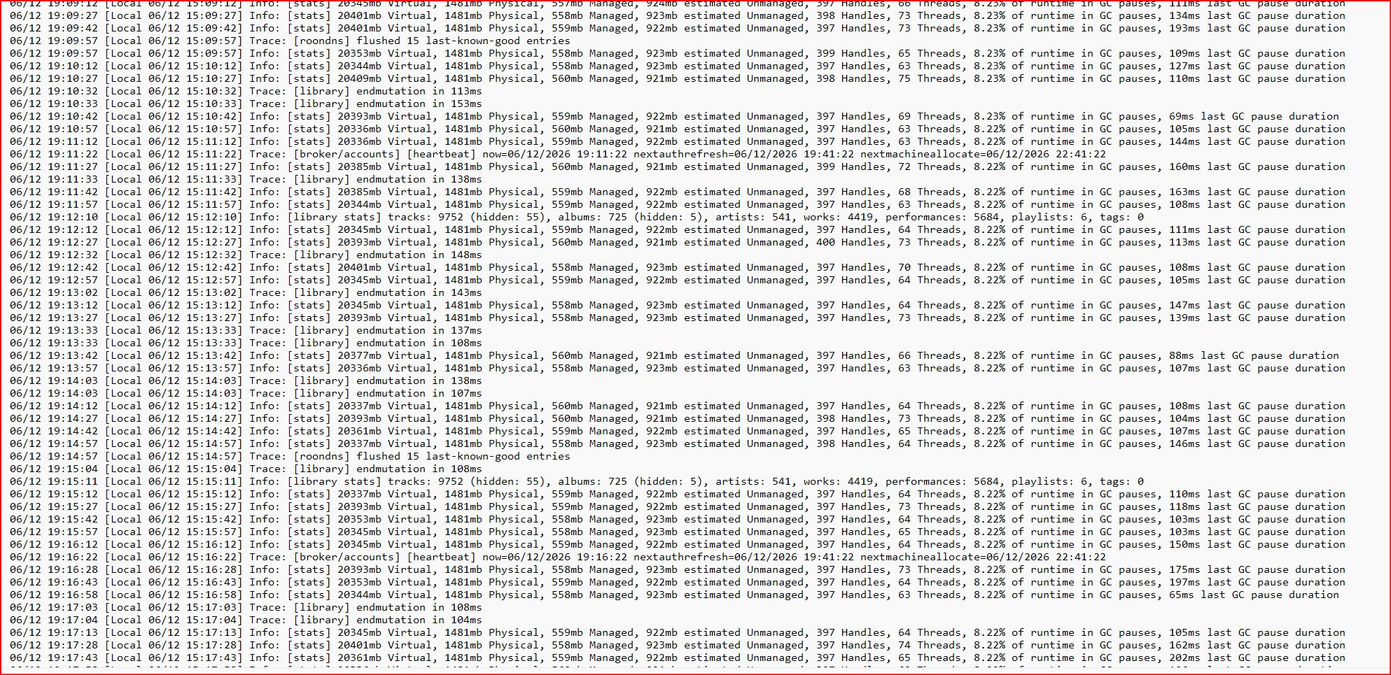

· Early Access 2.7(B1665) stopped playing. there were many log entries showing GC pause every 15 seconds
· Wired network, FIOS internet, Rock EA on NUCi7
@Steve_Richards Roon normally manages memory with a garbage collection sweep every 15 seconds. What is not normal is Roon hanging/waiting over 8% of the time it’s running with each pause taking over 100 ms. Those are numbers that you will feel as sluggishness in the UI and observe as network related failures: audio endpoints disappear, music playback pauses/stops, slow syncing to Room Labs API services and Tidal/Qobuz. For less beefy computers the pauses will cause Roon services like RAAT server, to crash and restart. Essentially Roon Server is slowing down and not keeping up with many background processes it needs to coordinate.
