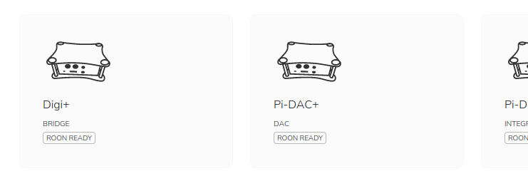

Although the Raspberry Pi is not Roon Ready, it should be noted that a number of Raspberry Pi hats from Allo, HiFi Berry, and IQaudIO are. These are only complete products when combined with a Raspberry Pi and Roon Bridge–a DIY project.
So, to answer @Oliver_Buxton’s question, yes, a Raspberry Pi running Roon Bridge is an officially supported Roon endpoint AKA network streamer.
They are not Roon Ready they are still classed as just Roon as they are bridges, they do not come under Roon Ready section they are just known to Roon they do not contain any Roon API/SDK its just Roon Bridge. Roon Ready has its own complete section and they do not show under this. I have had Hifiberry for many years, they just get nice artwork like Roon tested devices.
I think you’ll find that they are Roon Ready …
I see the error of my ways, mine has never shown as Roon Ready as its an Amp2 which isn’t in their list although drives for it are same as DAC+Ropieee identifies as DAC+/DAC+Pro/Amp2. Roon sees it as an unidentified DACplus for some reason. It is the DAC+ with extra amp bit.
Screenshot 2023-11-13 at 16.59.30
What is the link to this information out of interest. Thank you!
See this …
https://roon.app/en/partners
… and …
