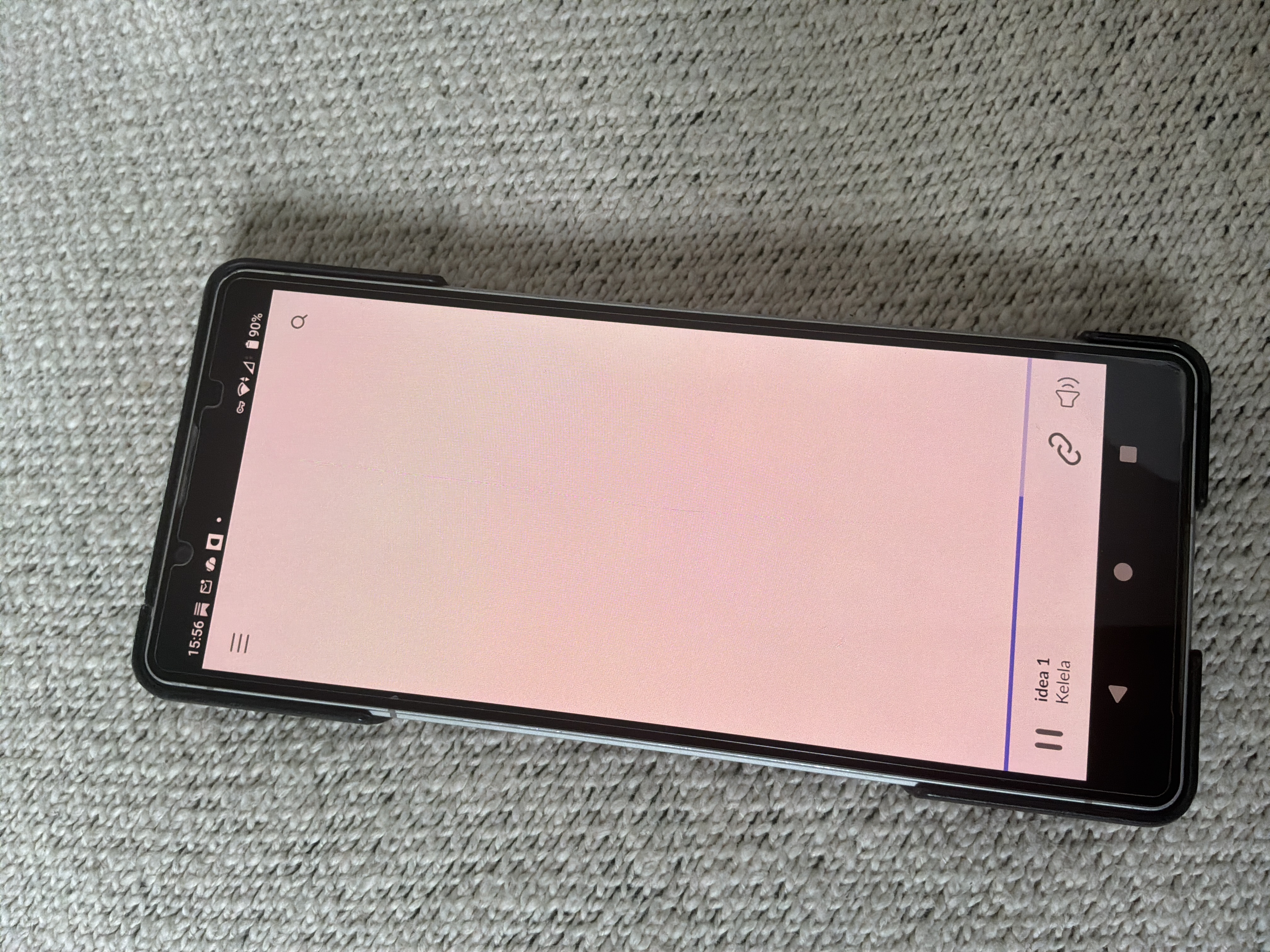

roon is slow lately in many things like searching, loading albums, showing artwork,...
main isp fritzbox router with wifi, added asus wifi router connected to rock
maybe i should have explained better, my set-up has not changed. it has been working for years. the slowness appeared in the last months, it has been worse.
