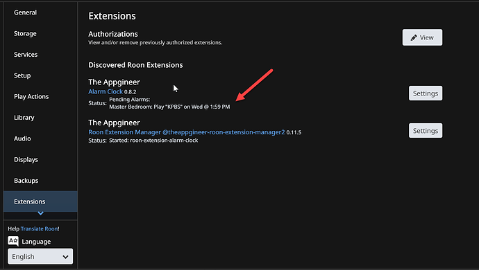

My Roon core is on a Synology NAS. I have installed the Roon Extension Manager in Docker on the NAS and set the environmental variable TZ to America/Los_Angeles.

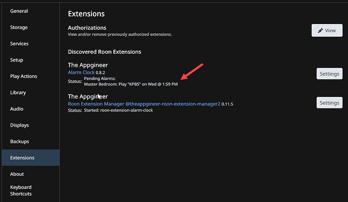

I then used the Roon Extension Manager in Roon to install Alarm Clock. It appears to work with the exception that it doesnât use my local time - it would appear to be using GMT. Am I missing something or is this a known issue?

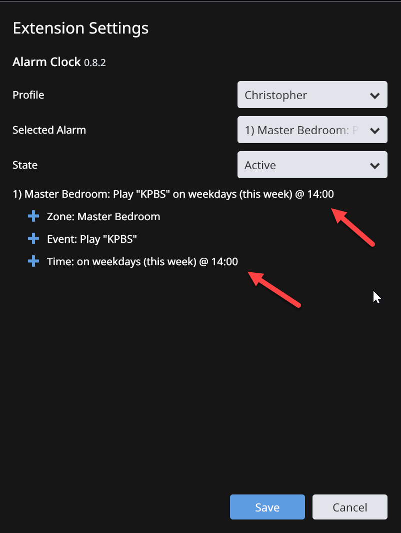

In the example below, the alarm works, but note that to get the alarm to go off at 5:59 AM, I have to set the alarm to 1:59 PM. This is an eight hour difference - the same as between my local time and GMT.

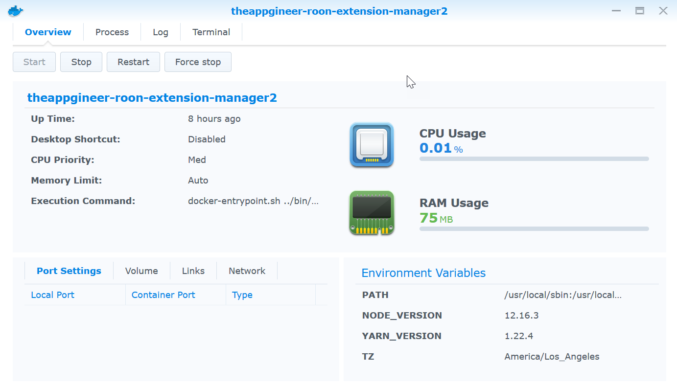

The image below shows the TZ variable in docker for the extension manager. It would seem that the TZ isnât getting picked up by extensions loaded into Roon with the extension manager.
Thank you in advance for any help or ideas.

Thank you for the reply. I have the TZ environment variable set in the container (per the SongKong example), I think itâs a problem in the Alarm Clock app not picking this up.
You have set the TZ variable for the Extension Manager container but when you install the Alarm Clock from it the Alarm Clock ends up in its own container. The TZ variable isnât transferred between the two containers (maybe something I should look into).
You can set the TZ variable for the Alarm Clock during installation, the option is in the Docker Install Options:
Interesting, my extension settings appear different. Following what I read as the recommended method of install, I installed the Extension Manager in Docker then I used it to install Alarm Clock from within Roon. There appears no place to set docker install options for the Alarm Clock Container. In fact, when I go to docker, I donât see a separate container for Alarm Clock, only the extension manager.
I presumed Alarm Clock was running inside the Extension Manager container.

In your setup it indeed is. While creating the container for the Extension Manager you did not make the Docker daemon available to it. This means that you cannot install the Docker based extensions, but not a problem if you want to use the Alarm Clock.
Back to the time zone issue. The TZ variable you set should end up in the container and then be picked up by the Alarm Clock. I see in the screenshot that the Synology web interface has a Terminal tab, if you open that and give the command:
echo $TZ
Do you get the America/Los_Angeles
value back?

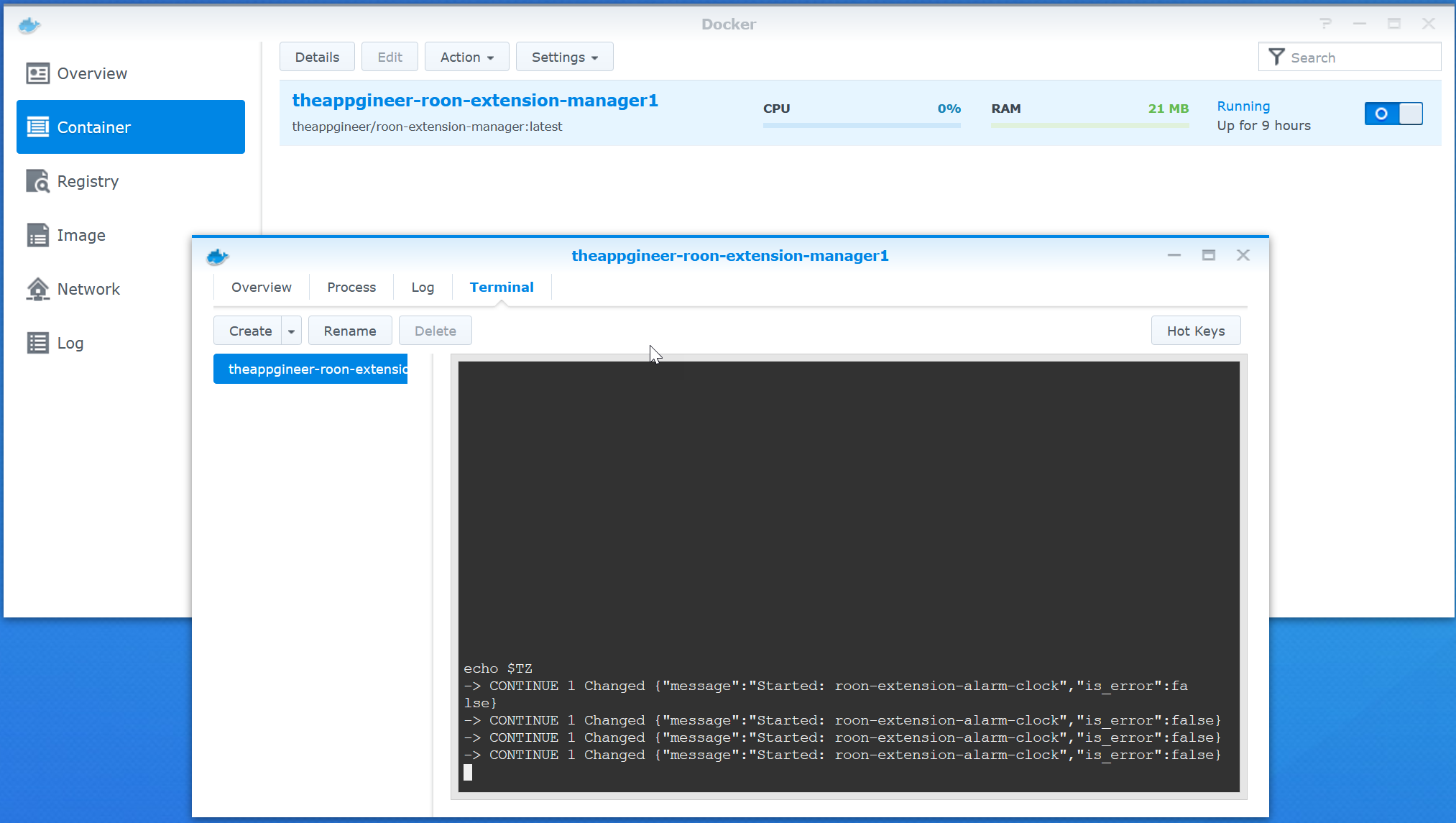

Does this terminal window give you a prompt when you press Enter, i.e. some string ending with a #
If not then you can try to connect to the Synology over ssh, when that is done you can get into the container with:
docker exec -it theappgineer-roon-extension-manager2 bash
On the prompt you then get you repeat the echo command:
echo $TZ
Good call, the terminal window in the synology docker app did not offer a prompt.

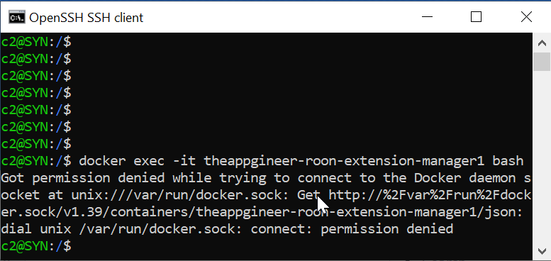

When I SSH over the run the command you suggest it gives me a permission denied error (see screen shot). The account I am using has full access to everything and is in the Admin group.
This could all be related to Synologyâs specific Docker implementation.
AlsoâŚanother feature request: It would be nice if alarms had a duration. For example, I would like to set an alarm that goes off at 01:00 and plays for X minutes then shuts off. This would be much more manageable than creating a separate stop event or having to turn off manually.
I donât know if this Admin group also provides the necessary access rights for Docker, Docker normally requires that the user account is a member of the docker
group. Do you get rid of the permission denied error f you run the command with sudo
I do get the same error with sudo.
However, it seems to be functioning correctly now with the exception that on a full NAS reboot, sometimes the Alarm Clock extension is properly loaded by the extension manager and other times it is not - rather itâs simply missing and must be reinstalled through the extension manager.
I appreciate all of your help. The extension is very useful and Iâm sure it will become less finiky over time.
Best.
The Docker integrations on NASâes seem to cause more issues than plain installs on Linux Systems (it also doesnât help that I do not own such a NAS).
A last thing you could try is create the Extension Manager container from the command line over ssh (hoping this doesnât give permission errors). The required options are described here.
