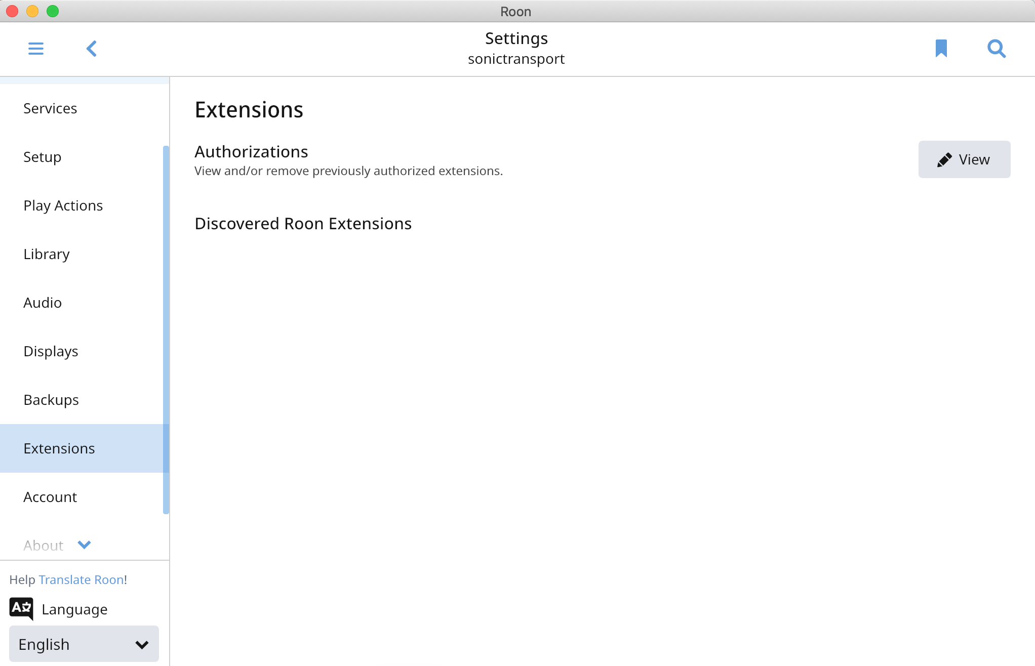

I’ve installed Roon Extension Manager on my sonicTransporter i9.
Now, what if anything does one do to expose available extensions?
After opening Settings/Extensions, this is the view:
Shouldn’t a list of available extensions appear?
Or do they need to be installed one by one outside of Roon?
I’ve had the same issue on my SonicTransporter-AP since early January. One day, the extensions simply disappeared though the sT showed the Extension Manager as installed. According to @agillis a fix is in the works but with no projected time frame. Frustrating, as I had been controlling the volume on my Marantz AVR within the Roon app on iPad…
Bump! Is this still “non-functional” as I see the same empty screen after installing the Roon extension app on the sonictransporter i9! Looks like it would be cool to try that extension!

It’s working now but you need to upgrade to 2.8
