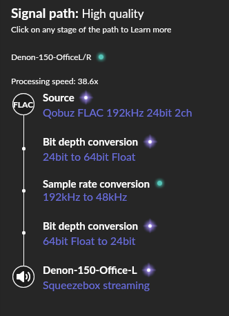

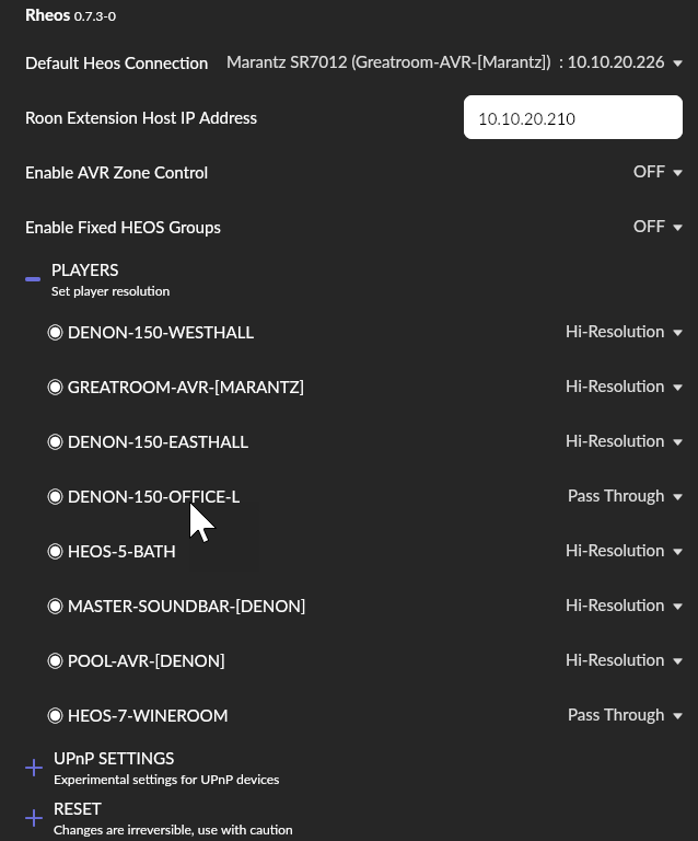

I am not sure if I am creating the issue OR there is a bug in .3-0…
I cannot get the speakers to hi-res, the settings UI say they are at hi-res (also tried pass-thru with same result) BUT when I play [PINK FLOYD - Wish you were here - Qobuz FLAC 192/24] it goes to GREEN on signal path (takes it down to 24 bit).
I was mucking with the config.json volume mapping and saw the issue…SO, I deleted my entire Portainer Stack and all rheos images, removed ALL volume mapping and rebuilt the image… same issue…
something weird in the config.json (I copied this from a bash console into the image since I cannot map the file at the moment) - strange the repeated listings for CD, HR, THRU in the file (well, maybe its correct, just seems its repeating something) - at the bottom is a screen shot of the roon-ui for your extension

Thanks Patrick.
Interesting as I haven’t changed any of the code that deals with this - I will see if I can replicate.
Are you launching with the command line I suggested or that used previously?
I am wondering if I created this with the change in command ?
Check the settings in Roon are set to 192/24 for the zone. This sounds like it’s defaulted to something different if I remember I had to set that. You will need to check each zone in Roons device settings/advanced.

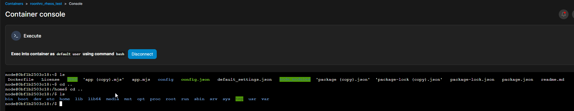

So I created an empty config.json on my NAS and put the following in my Compose file:
  volumes:
    - /volume1/docker/roon_rheos_extension_label_test/RHEOS/home/node/config.json:/home/node/config.json:rw
I deleted the current Stack (test image file, running container etc)
Rebuilt the Stack: re-pulled image and rebuilt container and it starts…
this is what I typically see every time I re-deploy an image:
  1. I have to remove the older RHEOS extension
  2. enable the newly discovered rheos image
  3. after your code finds the devices I have to go into settings and re-set everything up (default connection, hi-res or pass-thru etc)
Ok, so I did this and am able to play music
However:
  • if I go look at the config.json file on my NAS, its still empty
  • if I bash into the container I land here:
  1. the CONFIG.JSON file is there but empty
  2. the CONFIG is a folder - going into it, there is a CONFIG.JSON folder! weird
  3. your config.json is no where to be found
  4. if I change directory UP twice I am above “home”
  5. I am not a Linux person but I traversed around and cannot find the correct config.json file
I suspect its the way the docker image is built and the config.json file is in the internal portion of where docker keeps the rest of the container files - and hence why I lose my settings each time.
PS - I did add text to the config.json file mapped and it does show when I run CAT command on the file in the console…

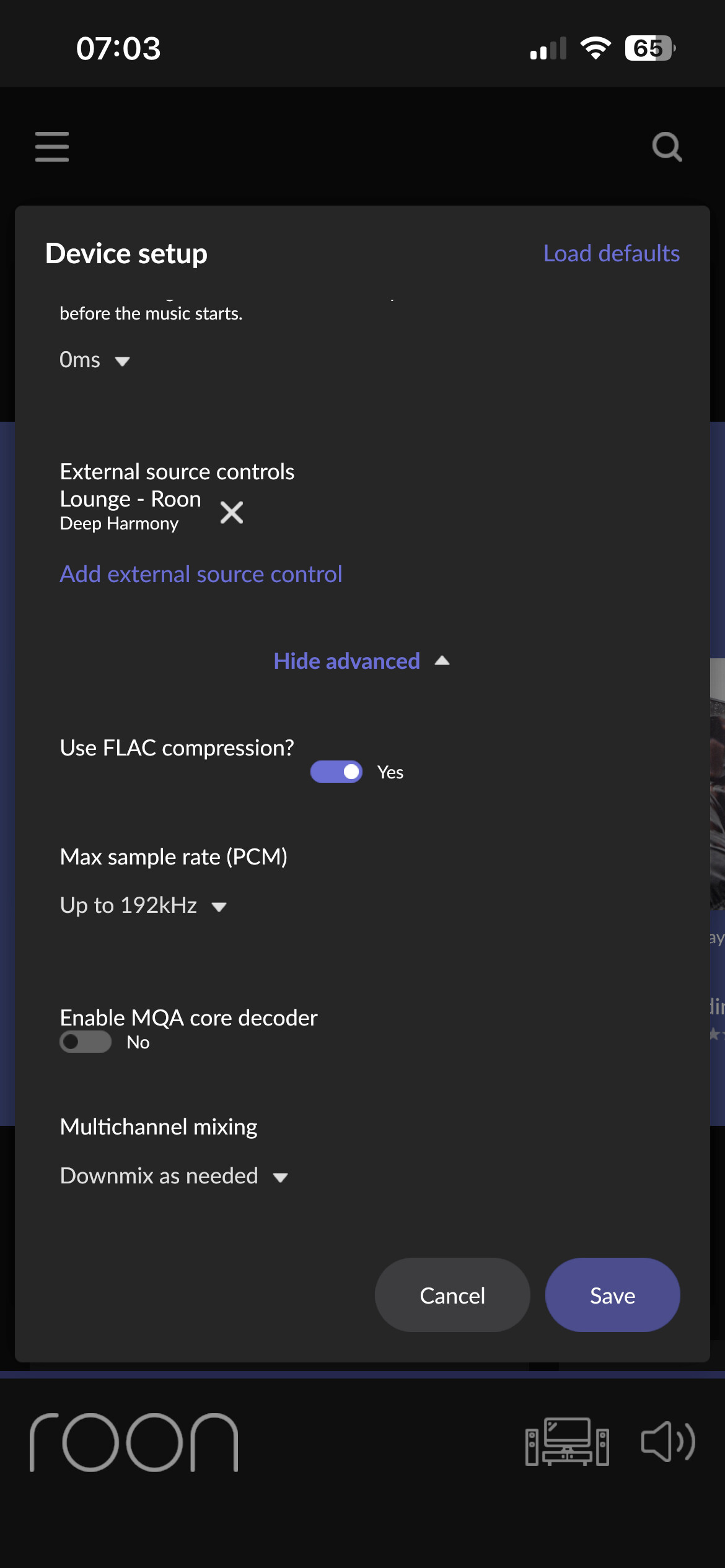

@Simon_Arnold3 I could not find any place on the Audio Settings for each device to change it to 192/24. It does appear in the thead below Peter has found a bug for this issue. I was just curious if I am being dense and not able to find the setting you describe.
thanks,
Patrick
Max sample rate in advanced section of Device Setup.
Thanks for the reply and screenshot…my devices, via the squeezebox setup of rheos does not show that option. I guess it’s controlled in the rheos settings only.
It should mines using Rheos and all devices in Roon should show it. This is in Roon not the extension. Rheos doesn’t give options other than pass through hires or cd quality.
The only other place to control the quality is in the Heos all device settings where you can choose high or normal resolution.
