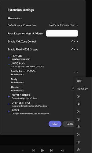

A NEW FEATURE, as requested by crystal_gipsy, is to allow a time delay to start playing from powering on a device with an on off switch (I have tested this on my receiver and a Denon Nework player). This avoids the skipping of the first part of tracks while the device powers up. In the extension settings I have replaced the ability to set a default sound mode for receivers (this now gets detected on start up as whatever the last setting was) and added an auto_play sector for devices that can toggle power.
The dropdown auto-play menu will show the devices and allow you to select a delay of between 0 and 20 seconds, after which the device will play the present selection. Or set to β€œOFF”, the default, and you can just use the normal play button.
Please let me know how this works in your systems and continue with feedback.

@peter_richardson it seems the now playing bit in the extension doesnt show at all now is that intended/ Not sure its actually needed anyway what was the reason for it in the firstplace? The delays seem to work ok but had to make it 10 rather than8 as it is in the Harmony. Maybe it has extra delays that take it more that is just the power on delay.
Glad it’s working. I thought a drop down choice would be fine. Not surprised the timing may be different from your harmony - I’d hope you could control all you need via the RHEOS app eventually.
The now playing is just for my benefit when exploring what is possible in the interface. Was working for me so I’ll see if there’s any reason it might not show for you. As you say - not critical. I’d rather make sure it’s stable and user friendly.
I did notice when it was there it repeated the now playing in Roon logs including the play icon you used. Again not sure it’s an issue but it just seems to spam extra stuff. I’m a less is more kind of guy so like it as it is now in the gui side of things. Took me a while I had to setup the AVR control though as not having an AVR I didn’t expect it to be there.
Humor me … it’s a very small load!
What is in th AVR control that you expected elsewhere? I put the auto play on its own menu …
