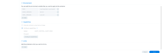

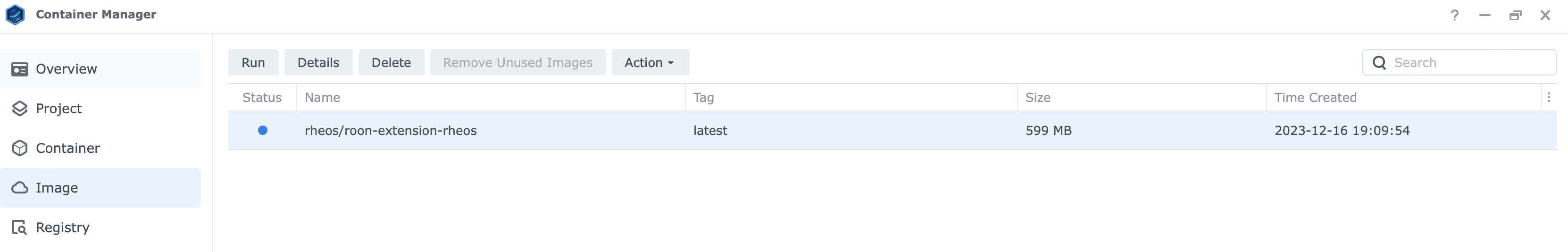

After the latest update Rheos keeps crashing on my Synology (DS220+) - any suggestions? Thanks!!
rheos-roon-extension-rheos-1
date stream content
2023/12/17 22:40:17 stdout Node.js v19.9.0
2023/12/17 22:40:17 stdout }
2023/12/17 22:40:17 stdout code: e[32m’ERR_UNHANDLED_REJECTION’e[39m
2023/12/17 22:40:17 stdout [UnhandledPromiseRejection: This error originated either by throwing inside of an async function without a catch block, or by rejecting a promise which was not handled with .catch(). The promise rejected with the reason “No devices found”.] {
2023/12/17 22:40:17 stdout ^
2023/12/17 22:40:17 stdout triggerUncaughtException(err, true /* fromPromise */);
2023/12/17 22:40:17 stdout node:internal/process/promises:289
2023/12/17 22:40:17 stdout :warning: Please ensure RHEOS is enabled in Settings → Extensions
2023/12/17 22:40:07 stdout STARTING HEOS
2023/12/17 22:40:07 stdout 172.17.0.2,Linux,rheos-roon-extension-rheos-1,linux,x64 Version : 0.8.4-5
2023/12/17 22:40:07 stdout INITIATING SERVICES
2023/12/17 22:40:07 stdout 12/17/2023, 9:40:07 PM STARTING ROON
Try powering down and reinstalling if this persists. For some reason the start up is failing. Are you able to share a copy of the log fike?

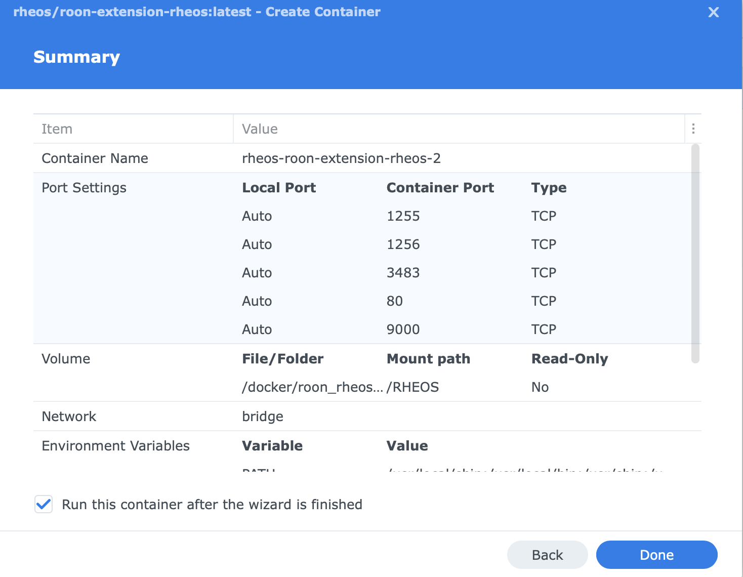

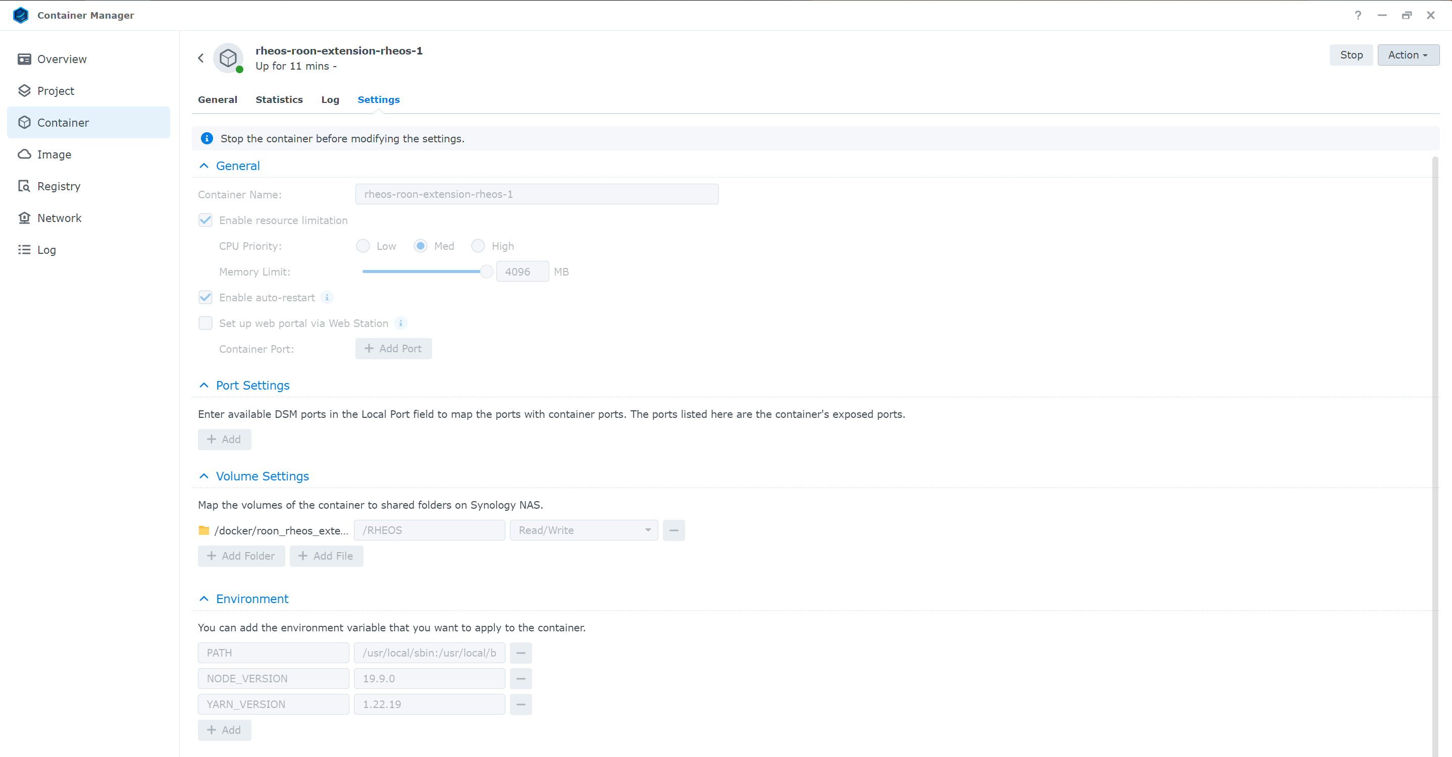

how are you creating the rheos docker image - can you share the details (are you using the container UI, container projects or ssh compose or…?)
Thought I had it working again, but unfortunately it keeps crashing again. I am installing the container in line with the instructions in this thread. I have this issue since the last update.
Try changing the file path to read/write and execute permissions. You may want to try running as sudo.

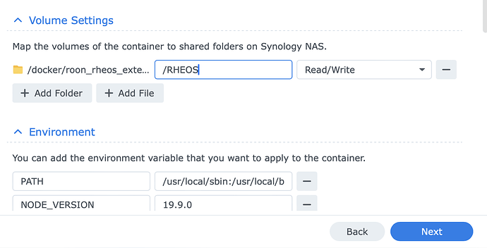

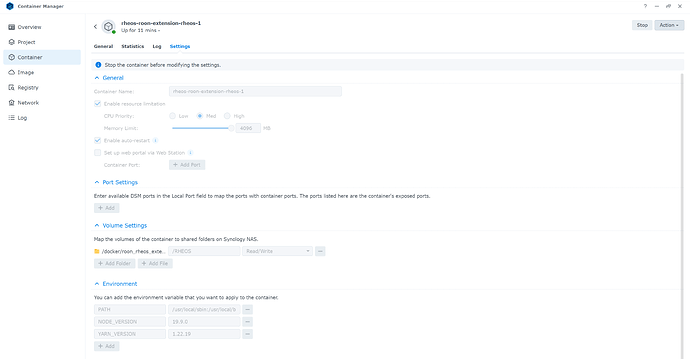

Peter, is the node version 9.9.0 ?
  • in my ‘latest’ docker pull, i still had 9.2.0
  • but in my ‘test’ docker, i commented it out completely
  • also, there is no need to map any folder to the image - its not used in this setup – you would do it only if you manually install his program into an image… - I would take it out for now…
  • now, i DO map an rheos folder into peter’s container as a sub folder to the home / node directory of the user running his app… I do this so i can bash into it and copy his config file to my subfolder and then fetch it from my synology NAS… no need to do any of this of course… here is my mapping
/volume1/docker/roon_rheos_extension_label_test/rheos:/home/node/rheos
Lastly, Peter, Bas has his docker in BRIDGE mode - any issues - its been so long since I didn’t use macvlan’s for this I have forgotten if he should use HOST or BRIDGE is ok…

I have the docker in host mode, bridge indeed did not work
Thanks. I always use host.

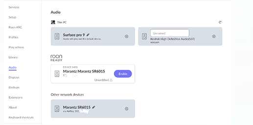

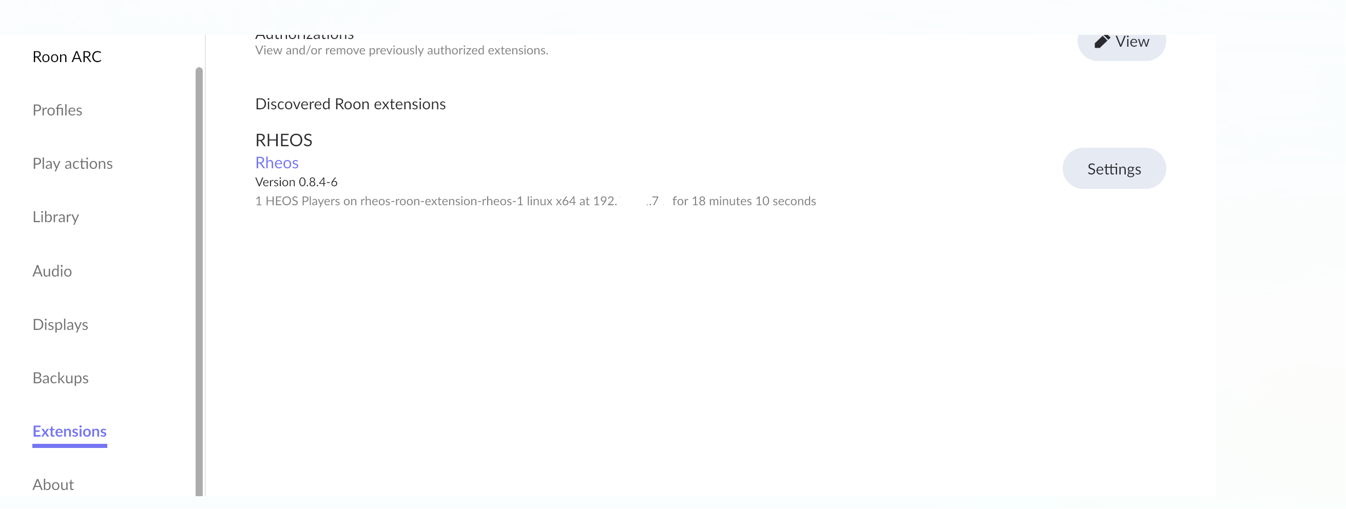

I’m new to this app and have tried to install it yesterday on my Synology DS923+ (which is my Roon server).

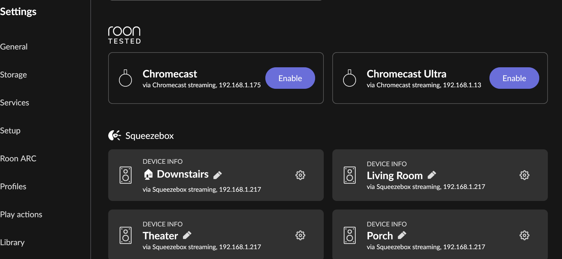

I installed the image in the Container Manager, and I can see RHEOS and enable it on my Roon > Setting> Roon Extension. And it correctly showed 1HEOS Player on rheos-roon-…

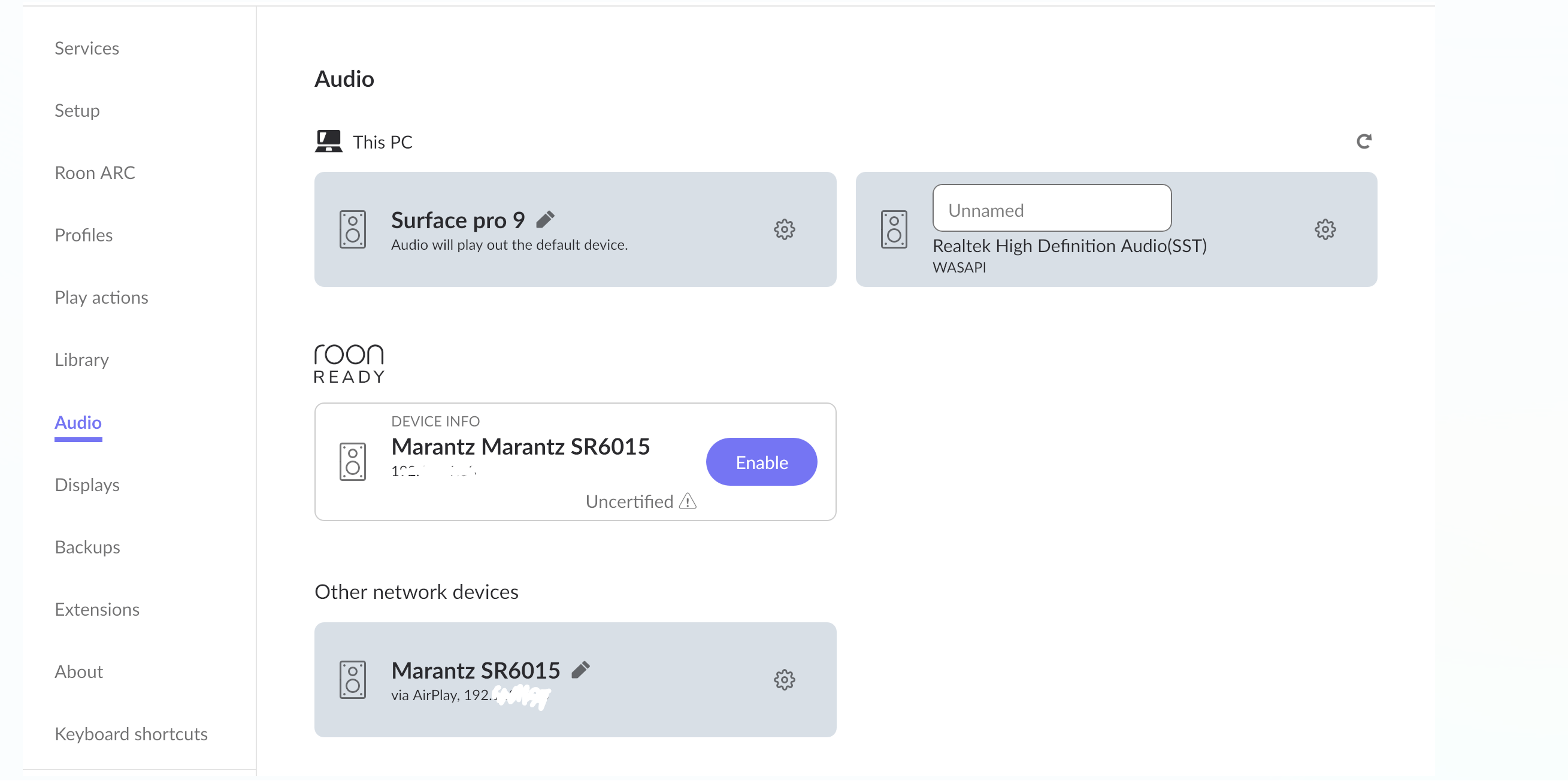

However when I go to my Roon > setting > Audio, nothing seemsed to have changed.
I can only see my Marantz SR6015 (via Airplay) and everything was the same as before I install RHEOS. When I tried to play the music, it’s still via Airplay ( 16bit/44.1 kHz)
May I know if I have missed something or have done any steps wrong?
Thank you so much in advance.

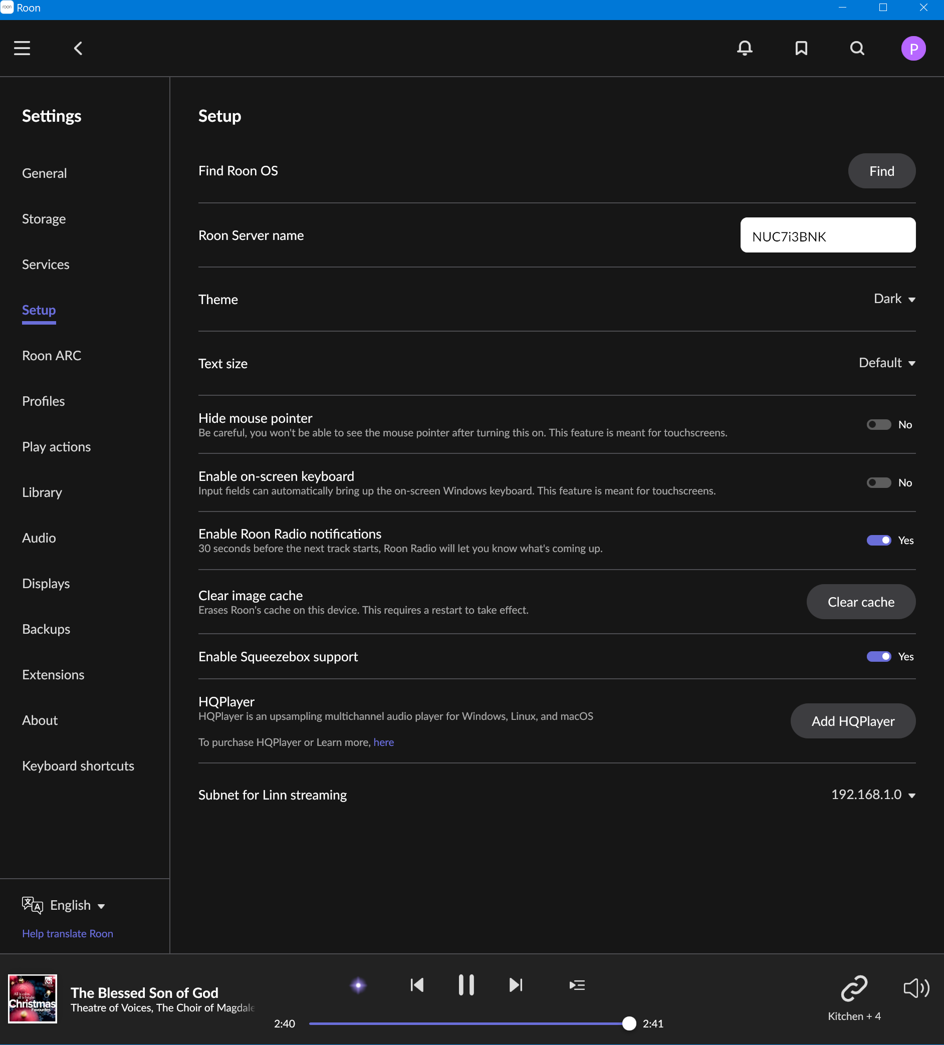

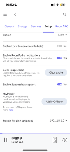

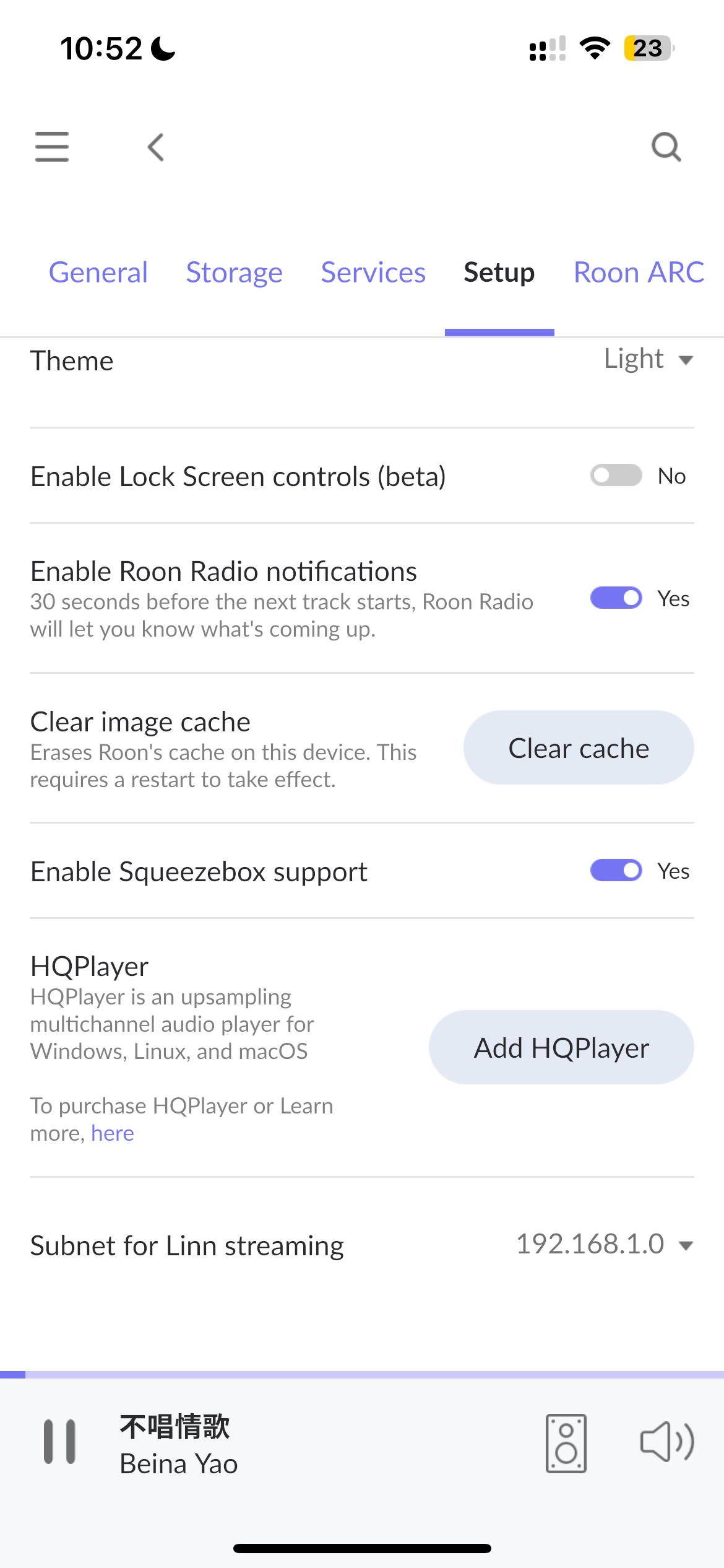

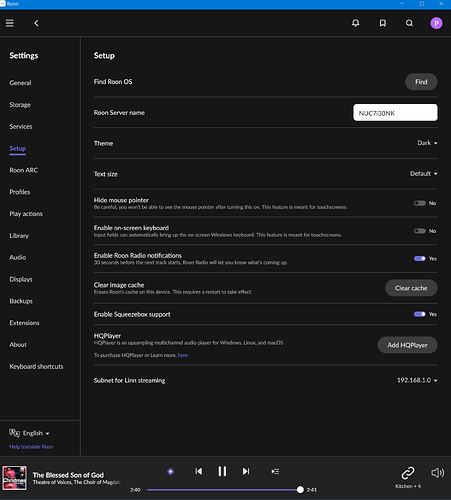

Did you enable squezeplayer support in roon? Settings → Setup → Enale Squuezebox Support
If you do this the HEOS device will show in Settings → Audio → Squeezebox
If not we need to see if theres anything unusual with your system

It turns out the problem was that I didn’t enable “squeezebox support” in Roon setting.
After doing so it works!
