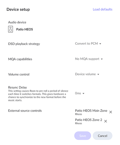

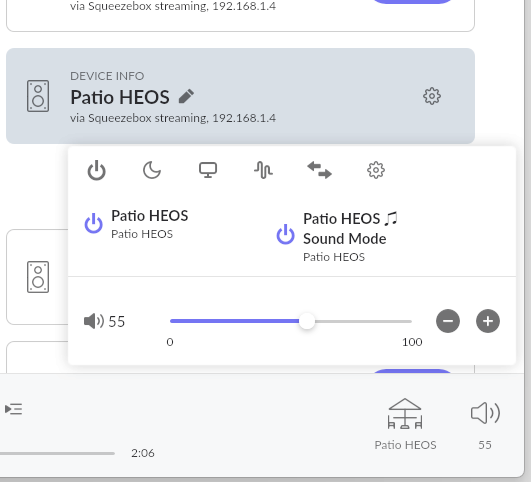

Hmmm… I’ve tried so many combinations, I’m confusing myself. Ok, I setup the controls on matching devices only. No luck.
patio

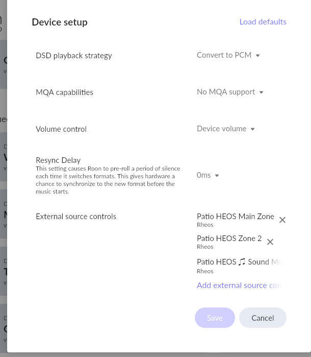

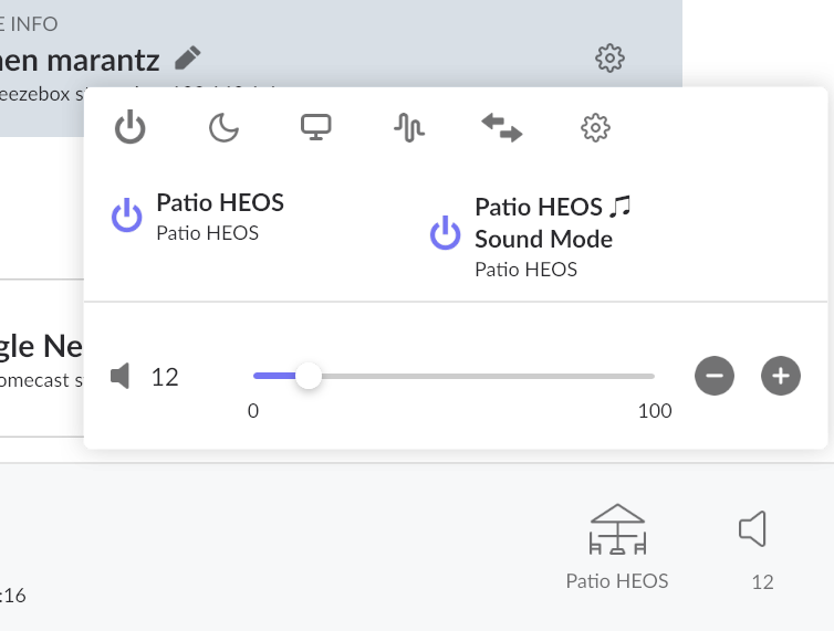

Try clicking on the on off (the colored one) for the patio HEOS. This should turn on the receiver and show both zones grouped as zone 1 and zone 2
And just in case load defaults and add again the Main and Zone 2 controls (source control is optional)
I’ll see if I can post a video over the weekend …

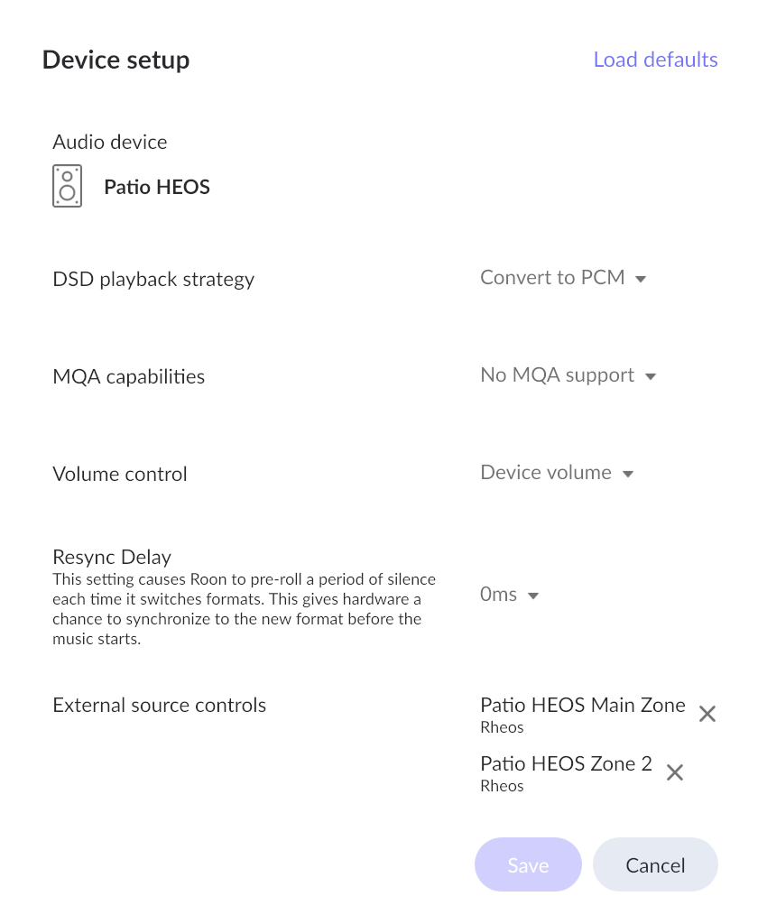

Edit. Two way control still doesn’t work. Same when using the remote control. Roon also doesn’t pause it keeps going but timer is frozen so it doesn’t move along. Have to stop in Roon wait for signal path to close then restart via roon.

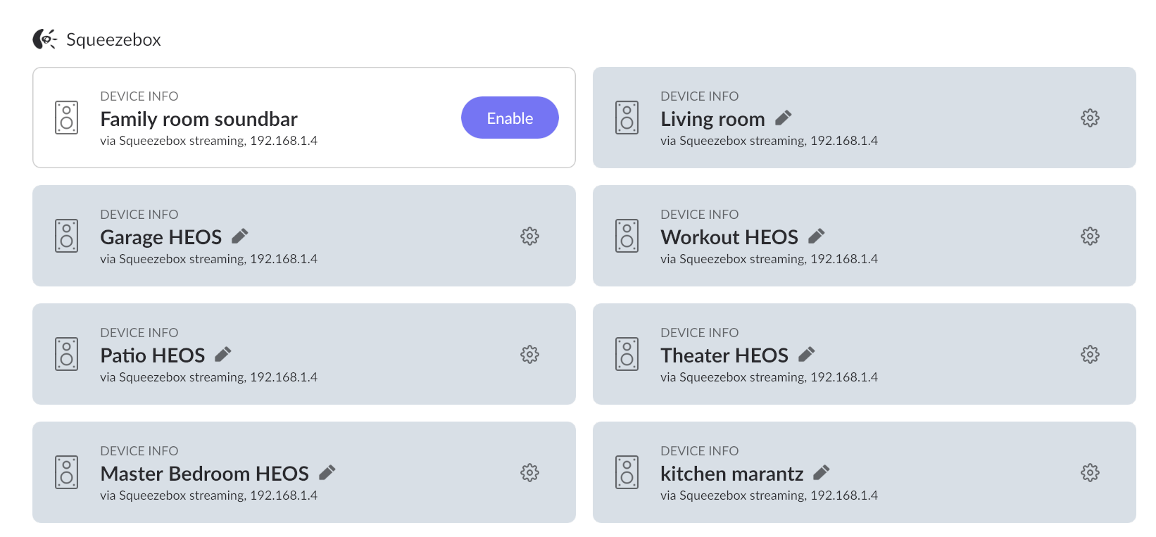

All of my audio devices have friendly names. The one in question is called “Patio HEOS”
