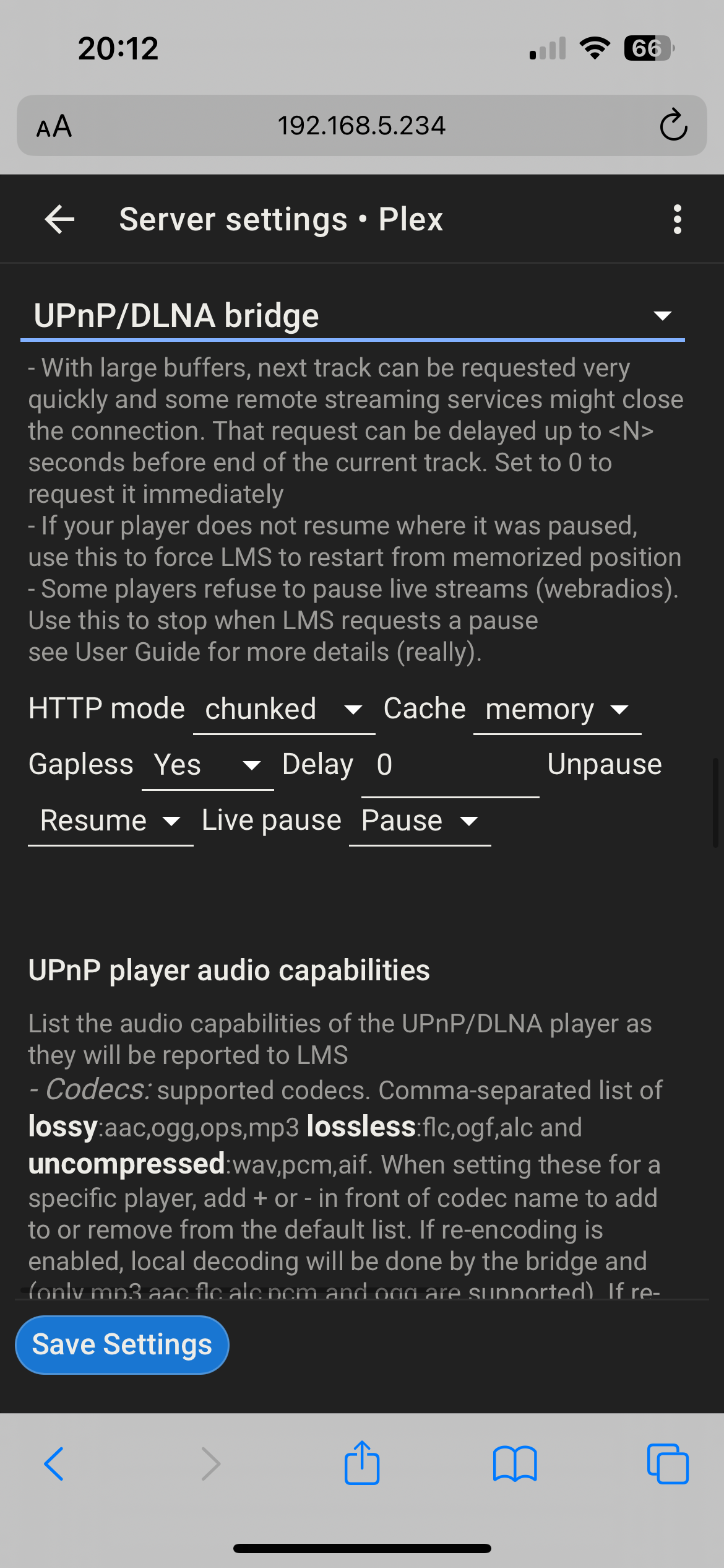

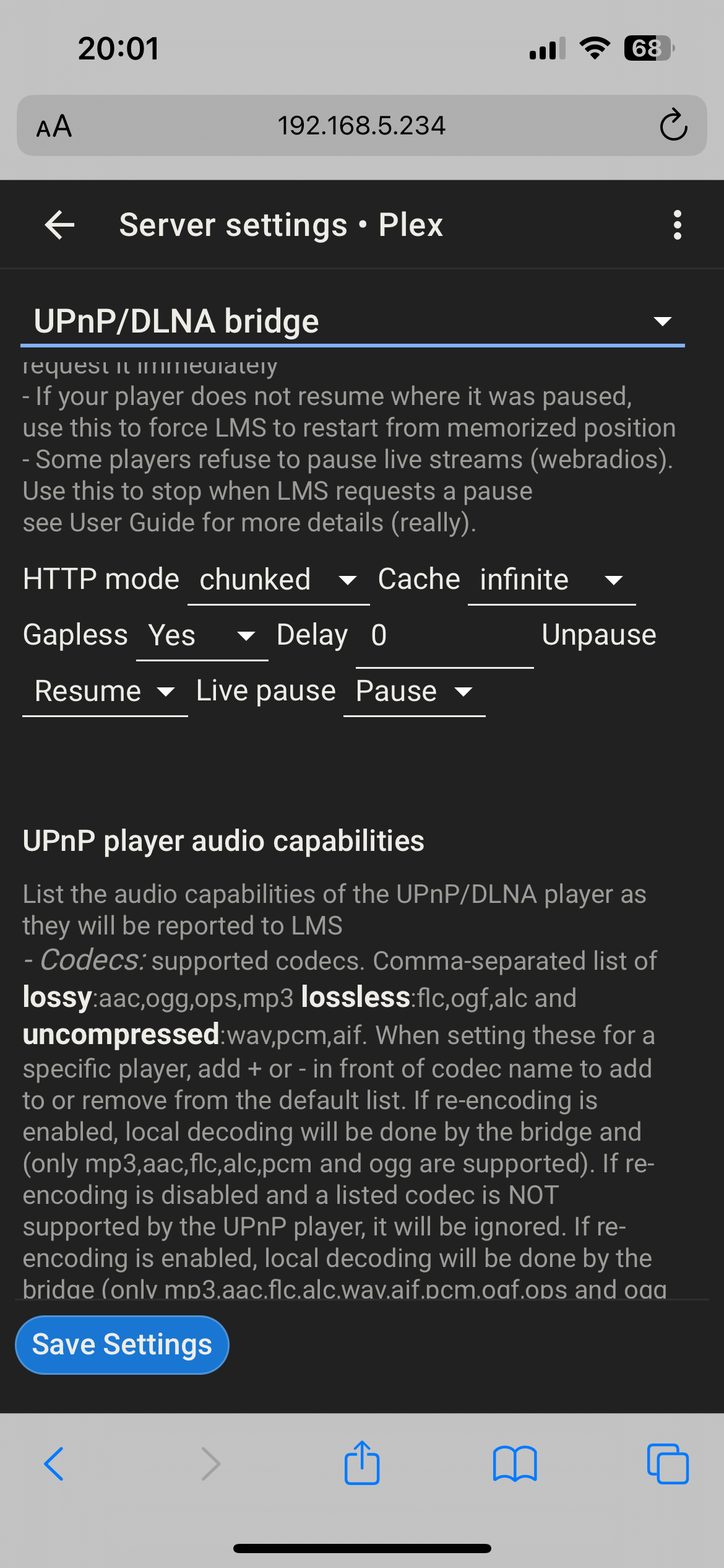

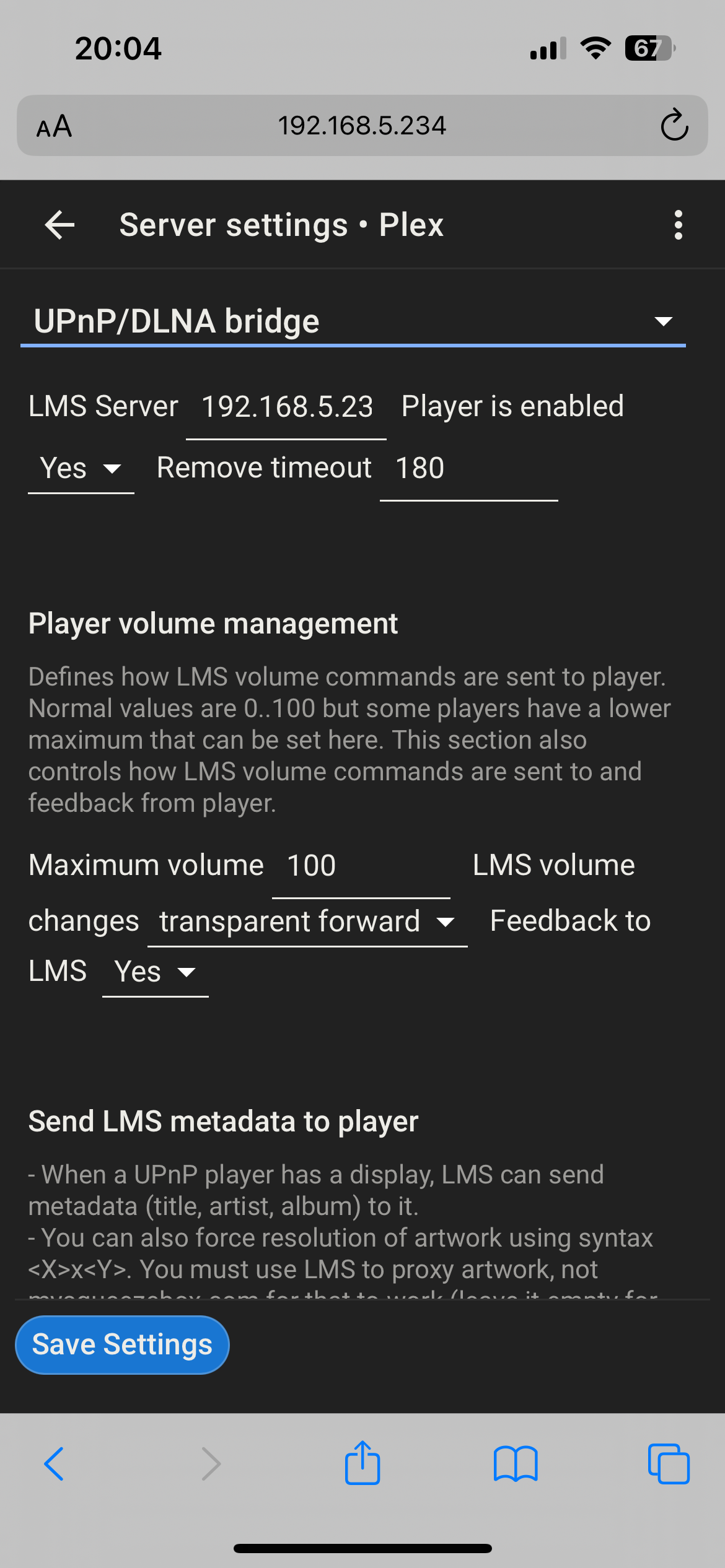

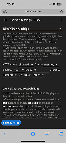

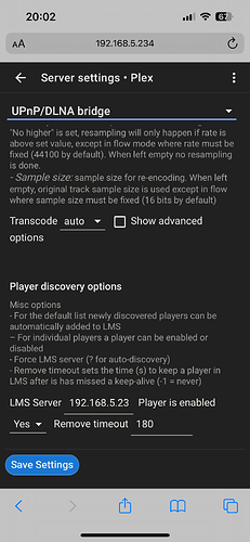

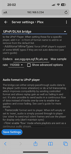

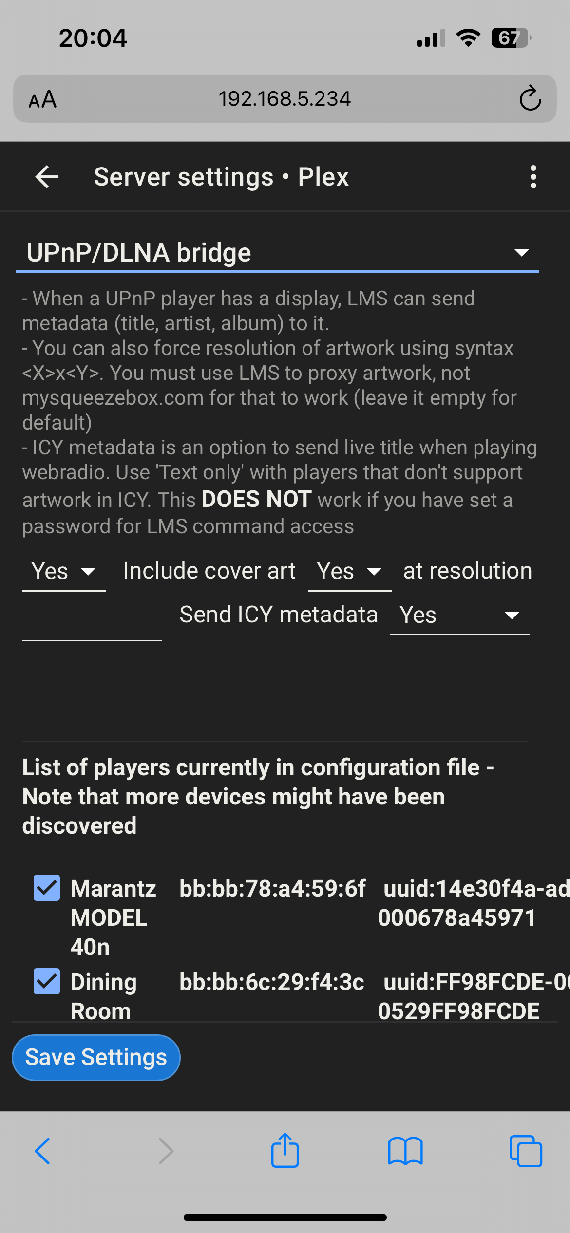

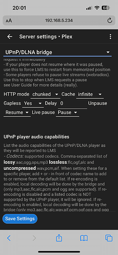

I have it working in lms to the marantz using its plugin. Will send the config.xml when I can. In the meantime here are some screen grabs.
Also worked changing the cache to memory which looks to be new.
Thanks. All is helpful. Nothing obvious above what I’ve been trying but I will review carefully.
If set the settings in Rheos as close as I can to those in lms and it won’t play more than 2 gapless and the 2nd track will always plummet in processing speed. All tracks played gapless in lms and those settings.
ase share the lms config file. I will make sure we can fully duplicate in RHEOS.
