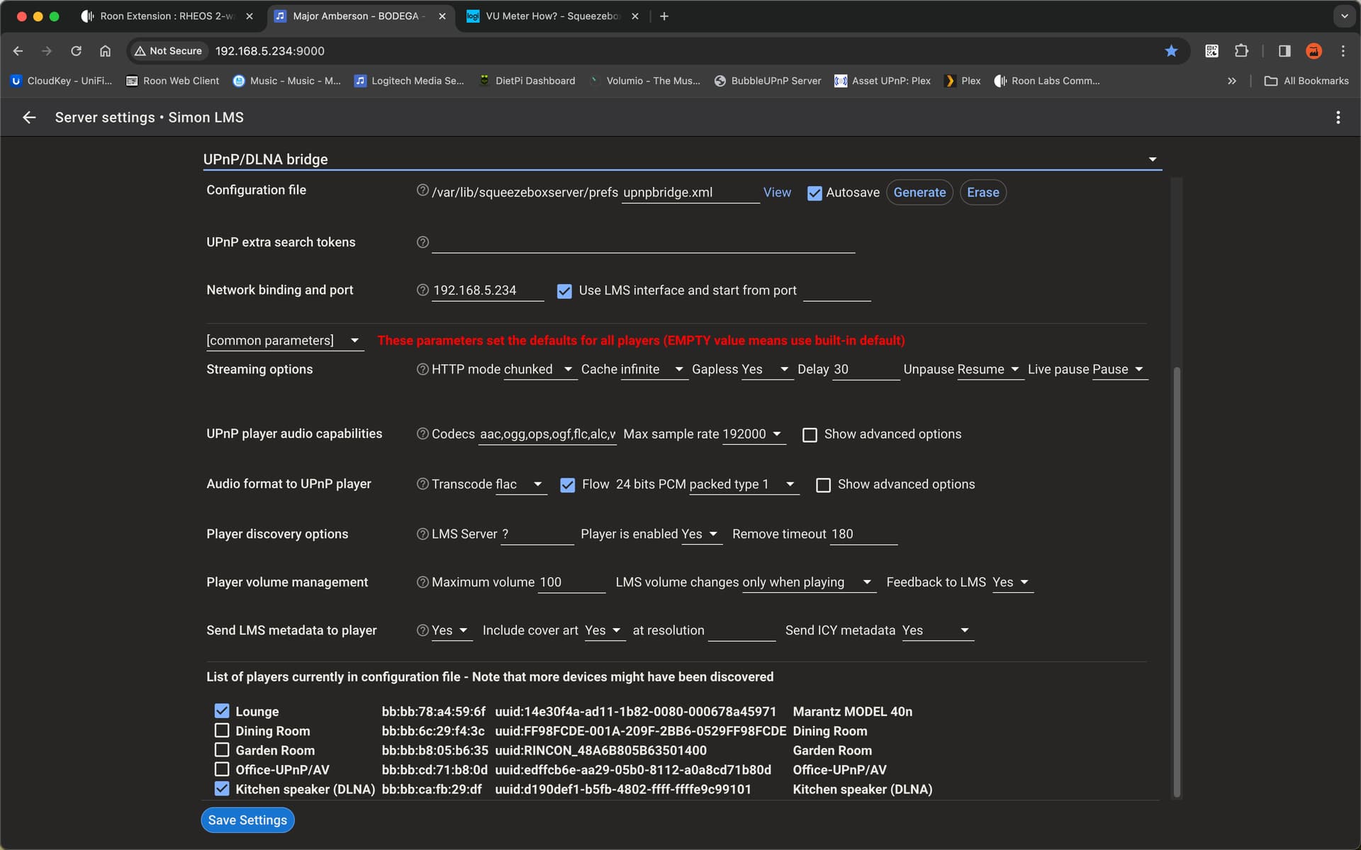

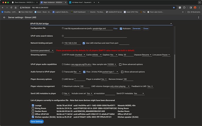

Share the LMS settings xml for the marantz please. I couldn’t get it to work and gave up - but I think I too have lost touch with an old friend in LMS…
And strangely I never seem to get crashes. - unless I am testing some novel code.
I could not load in the presets, doesnt seem to work. But I just used the basic settings it loads with and it works.
