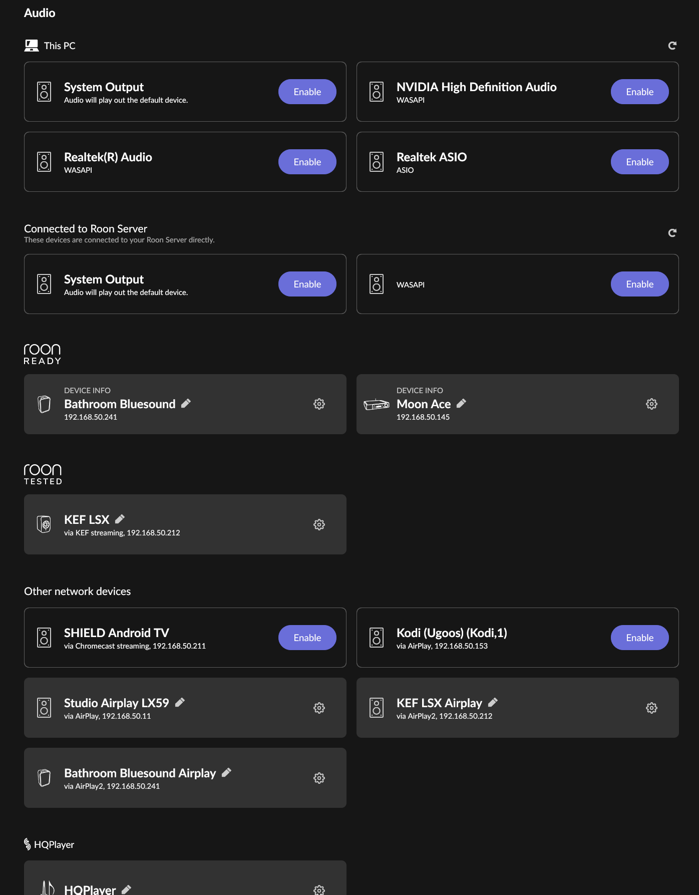

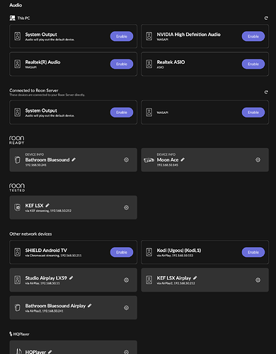

I’ve been fighting with this thing for several months (on and off) and finally today it seems to have installed. I have installed it completely by accident, no clue how I managed it.
However, it seems to be appearing in my Extension manager and the speakers are showing there, but not in the Audio options.
Here’s a list of my available audio options
There is nothing beneath the HQPlayer option. Any idea what might be wrong?
This is the closest I’ve been to getting my HEOS speakers working with Roon in the 18 months I’ve been trying

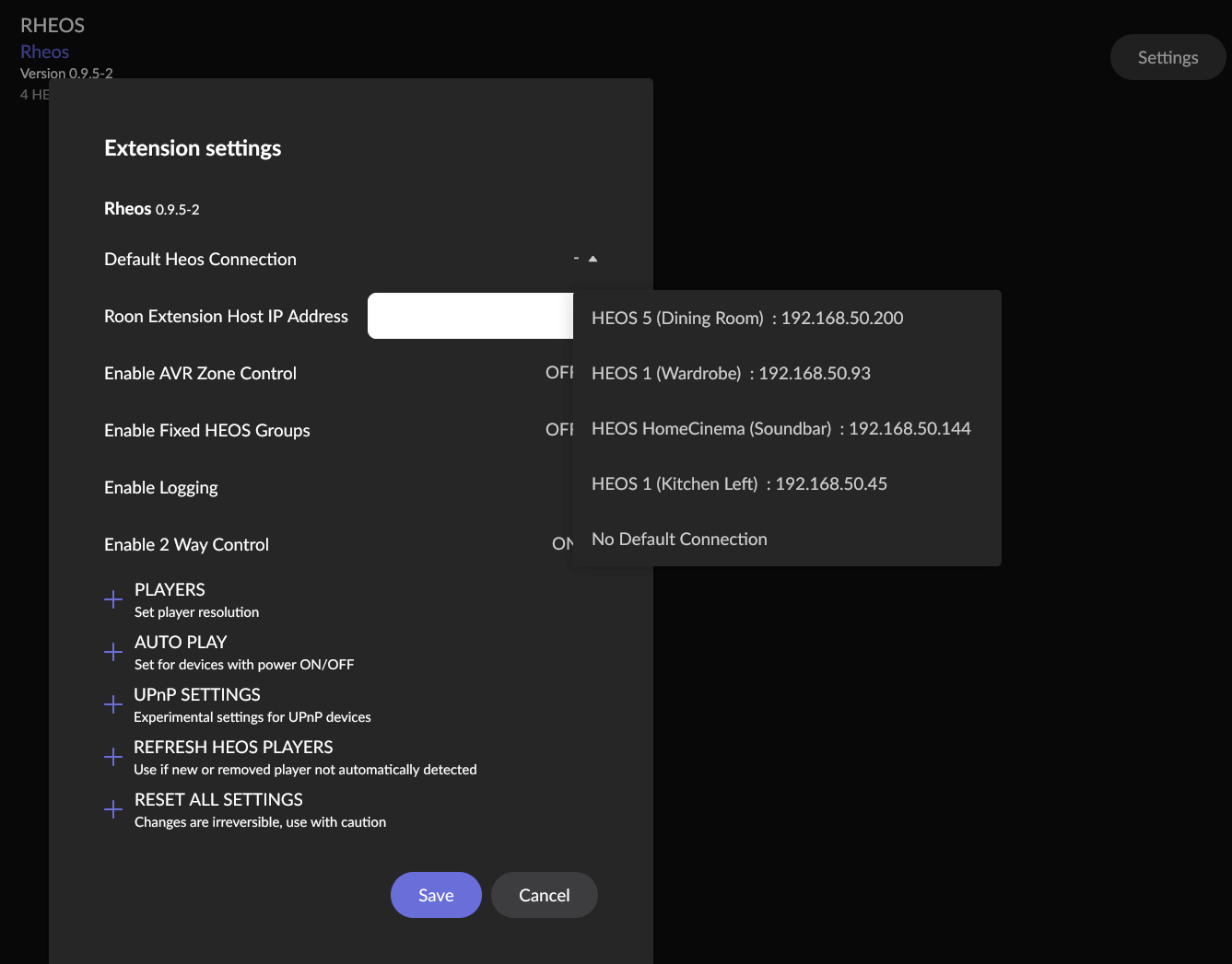

Look under settings → setup and check you have ‘enabled squeezebox’ support.
This needs to be enabled fun or the discovered players to show up as squeeze players. You then need to activate each of them in settings → audio.
That was it!! Thank you! :smiley:

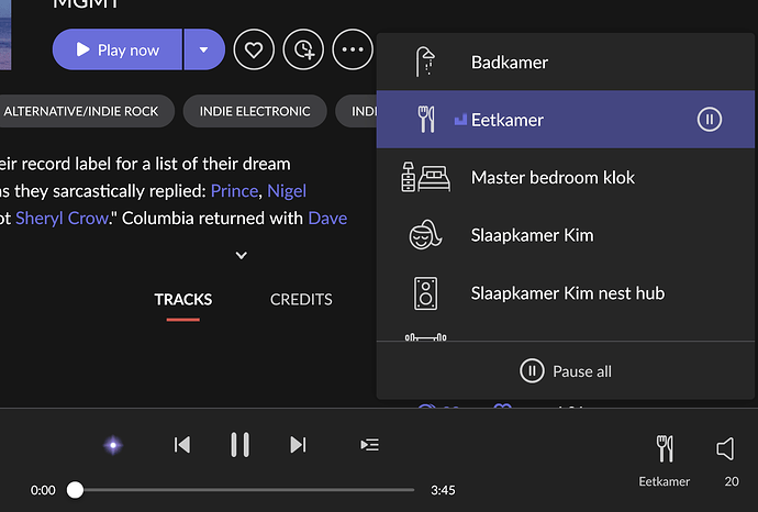

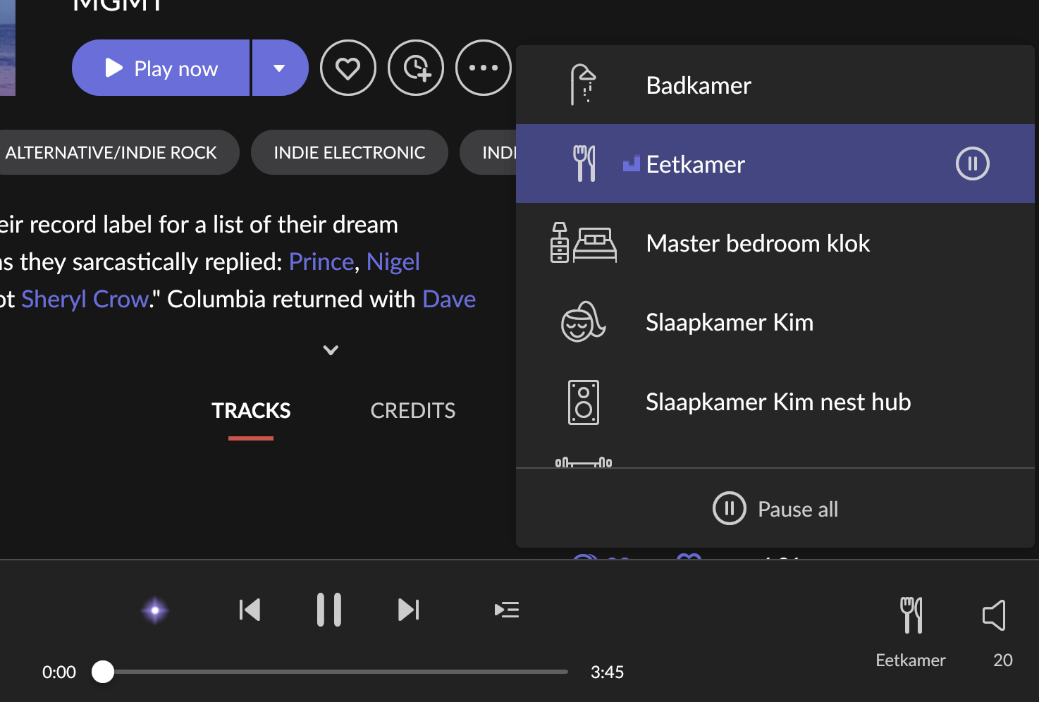

I am using this extension for quite some time, but lately I have a strange issue. If I push play in the Roon app the music is not playing and stays on 0.00. However the audio device seems to report that is is playing: see image on the right of “Eetkamer” bars are going up and down.
I then have to push on pause and again on play to get it working. My ‘non Heos endpoints’ do not have this issue.
I do not know when this started happening, maybe a couple of weeks ago after an update of Roon.
I have the
Any ideas?
This is the issue I have had for a while - I usually have to move the play off of zero (move a few seconds) then it starts playing - sometimes I have to do that and adjust the volume up or down one - happens with my older heos items (heos 1,5,7 and marantz avr) - but the M1 works perfect everytime (just jinxed myself I suspect :wink: )
another thing I have to do is change the resolution in the extension for the player off of pass-thru to something else then back…
I suspect the code that is always poling for devices etc, sometimes gets the device ‘locked up’ – in a few cases I have had to soft reboot the marantz sr7012 to get rheos to let go…
