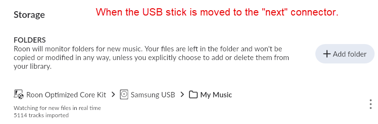

Lastly, if you could please share a screenshot of your Roon Settings>Storage that would be helpful as well. Thank you!

A2) I alway turn of my NUC when I not listening to music. Please find my uploaded log files named [moderated: private email address removed].
A3) Storage information
