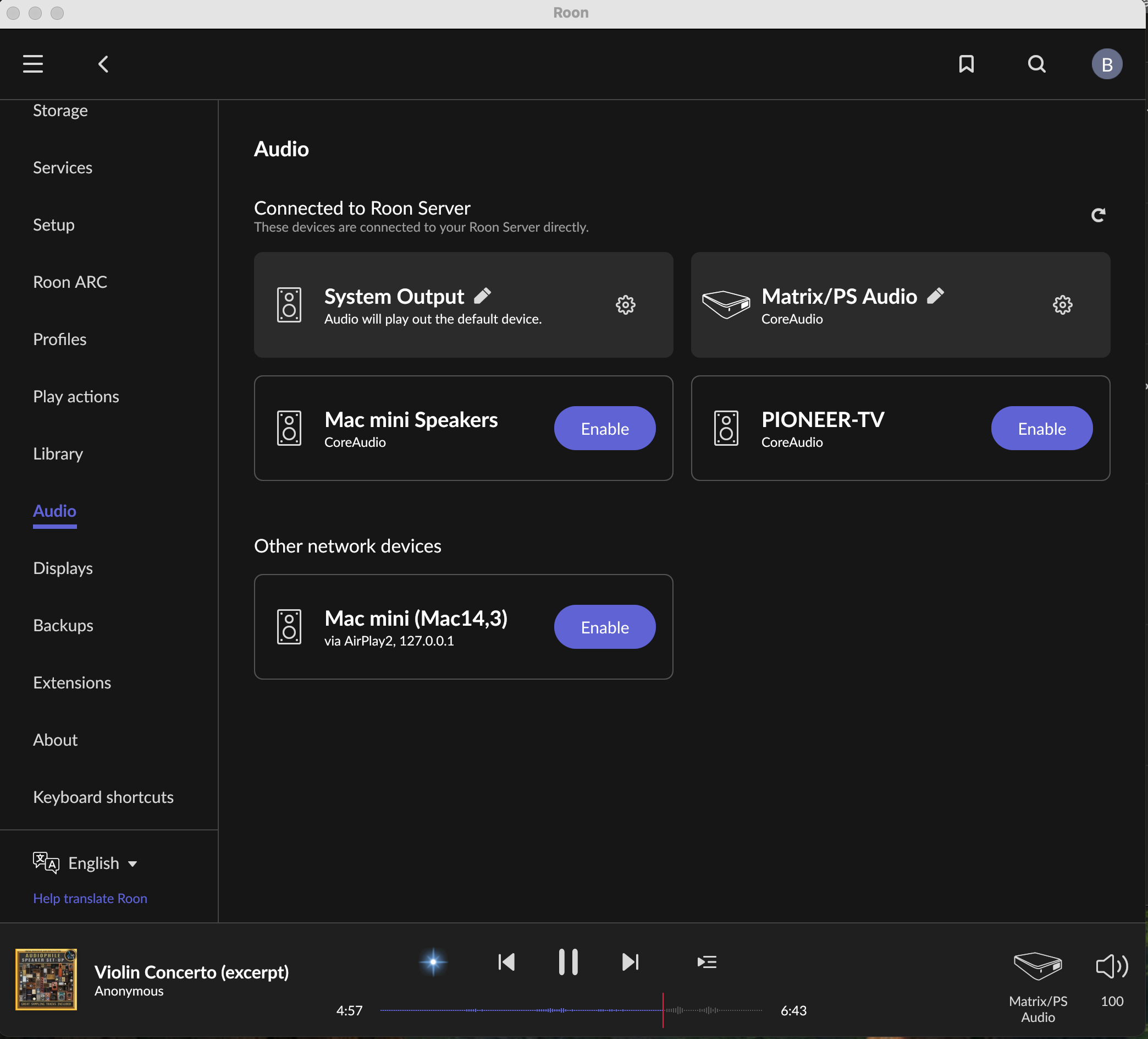

Roon doesn't recognize devices after the last firmware update. Roon core is running on my Mac Mini. My other devices are running on my Macbook Pro (the laptop itself, and my Focal Arche headphone amp). They worked and were recognized in Roon "Audio". My Macbook Pro does recognize these devices, but Roon no longer does.

I spoke too soon. Although my Focal Arche now shows up and I can select it, Roon is doing something bizarre. In the Album view where it shows the Tracks playing, the little EQ bar beside the name of the song shows that the song is playing. However, it plays for about 30 secs and then skips to the next song. But, on the bottom bar, where it shows the progress, it shows that it is not progressing, although the presence of the pause button suggests it is playing. Nothing is coming out of my headphones, even though I have the Volume cranked. I tried repeating your last instructions, as well as re-started Roon several times, but the problem continues.

Hi Benjamin: I went to that section under Audio, but couldn’t find anything on bit depth or sample rate. So, I tried something I do on another machine, when it fails. It tells me to unplug the accessory, wait a few seconds, and then plug the accessory back in. I did that with the Arche, after it was turned off. I also shut down Roon and the computer. I then re-attached the cords, rebooted and turned Roon on again. This time it worked for a while. Then Roon told me it “Failed to initialized the device.” So, I turned Roon off, unplugged and re-plugged-in the cables again. Now it works again!
Should I hold back on trying to make any further changes to see if this setup continues to work?
Hi, Benjamin and Suedkiez: it looks like there is a handshake problem with the Arche, since my iFi Dac and amp work just fine. There also appear to be a lot of disgruntled owners of the Arche online. And I’ve had no luck in getting any response from Focal about my issues with the Arche. So, I’m dropping the attempt and using the iFi, at least for now.
