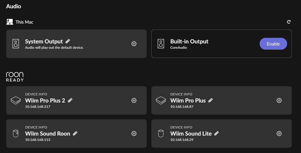

I’ve paired the Wiim Sound and Wiim Sound Lite speakers in the Wiim Home App and assigned each a channel (L + R). The stereo pairing works when using the Wiim App to play music but not with Roon. Roon continues to see each speaker as an individual endpoint.

Thanks for laying that out, and for linking back to the earlier thread as well. The difference here is how the speakers present themselves to Roon.
Sonos creates a virtual single endpoint at the system level, so a paired Sonos setup appears as one speaker to Roon and handles the left and right split internally. WiiM, by contrast, uses RAAT through Roon Ready, so Roon sees the two separate hardware endpoints by their individual IP addresses. At the moment, WiiM has not implemented a way to present that stereo pair as a single RAAT endpoint to Roon.
There is a manual workaround in MUSE if you want to keep them paired within Roon and preserve the Roon Ready bit-perfect path: group both speakers into one Zone, then in the MUSE settings for the Right speaker add a Procedural EQ or Mixing filter and mute the Left channel. Do the same for the Left speaker, and mute the Right channel.
It is a manual workaround, and you will need to disable it if you ever use the speakers individually, but it is the current way to get discrete stereo output across two separate Roon endpoints. Let us know if you want us to clarify any part of that.

The workaround using MUSE to mute channels is working. It took a bit to figure out but I finally got it. Thank you so much for the suggestion. Unfortunately, I am not making any progress with WiiM support. I will post a feature request here and keep my fingers crossed!
