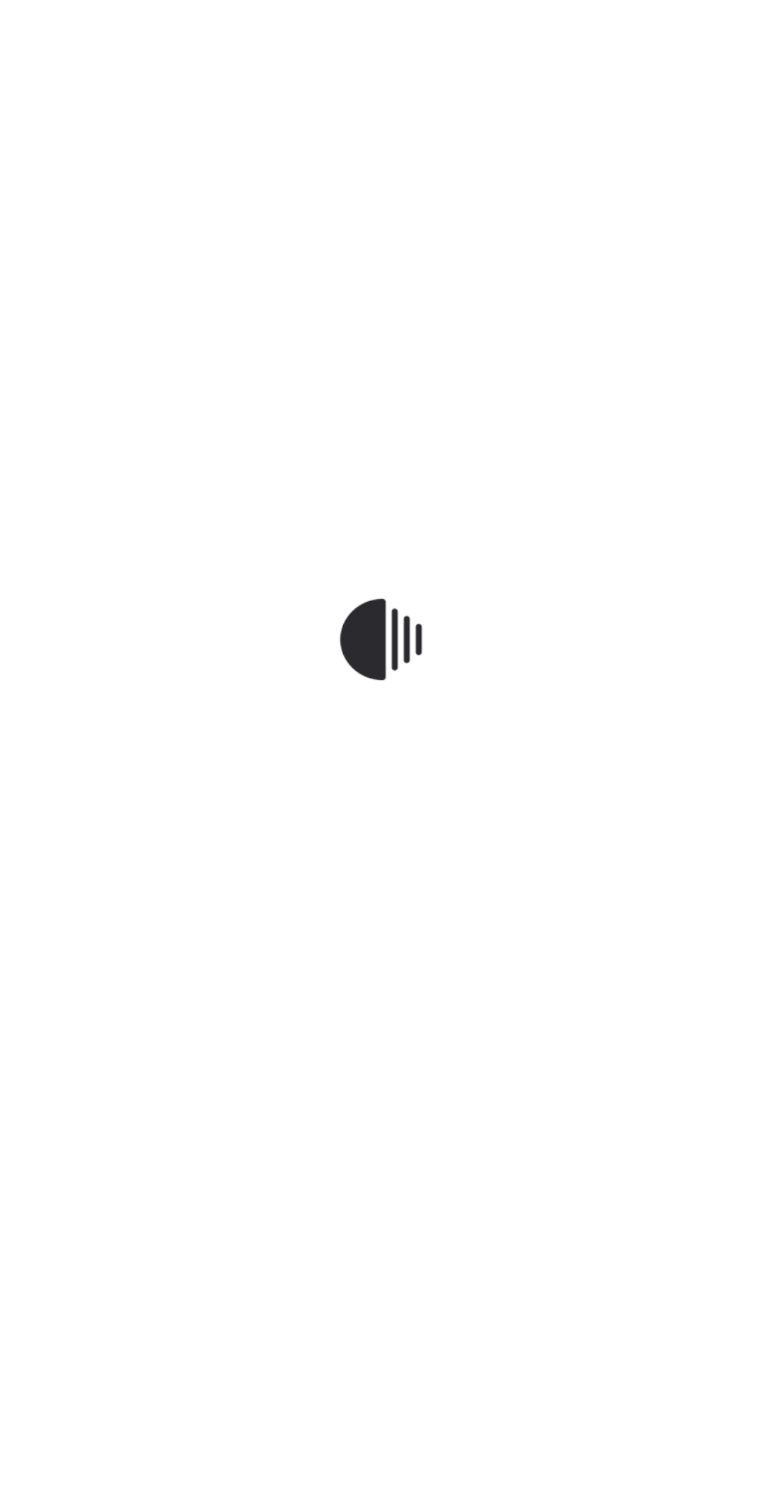

After latest update Roon no longer starts on any device. I have Roon Controller on both a Mac and my Samsung phone. I also have Roon ARC on my phone as well. When starting the Roon apps all that shows is a white screen with the "working" icon.

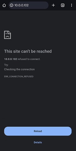

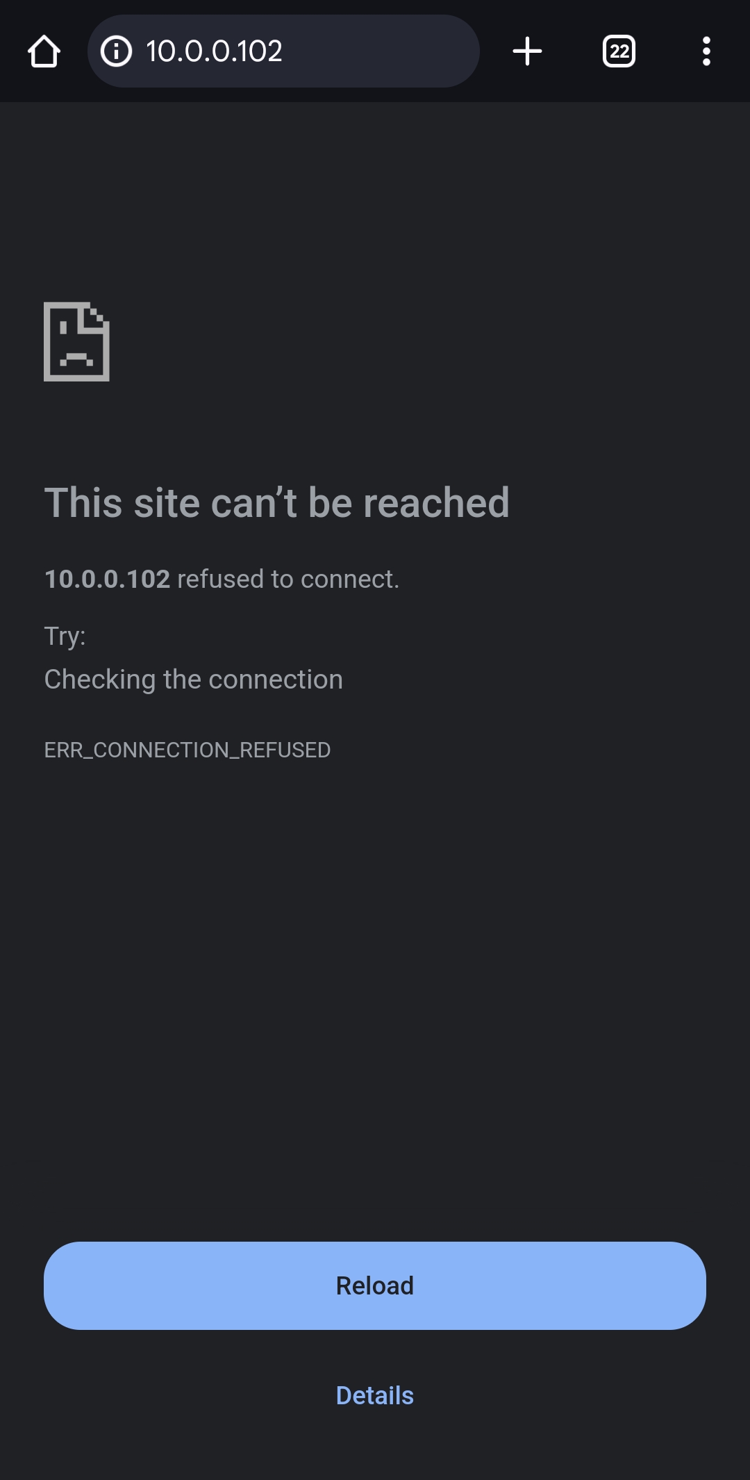

Hi Vadim,
I did attempt that but the web UI that I had been using is giving an ERR_CONNECTION_REFUSED error message
Hello @Peter_Rodriguez
Based on the diagnostic data collected from your account, the IP address of your NUC appears to be 10.0.0.104.
Could you please try accessing it using that address and let us know the result?
Thanks. That did the trick. Why does the IP change without any notifications?
That’s related to your router giving out a different IP address and nothing to do with Roon.
Generally it is recommended to give it an IP reservation on your router so it doesn’t change IP address.
