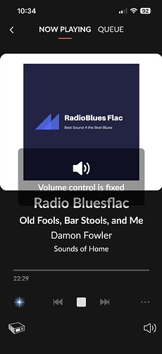

Description of Issue:

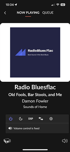

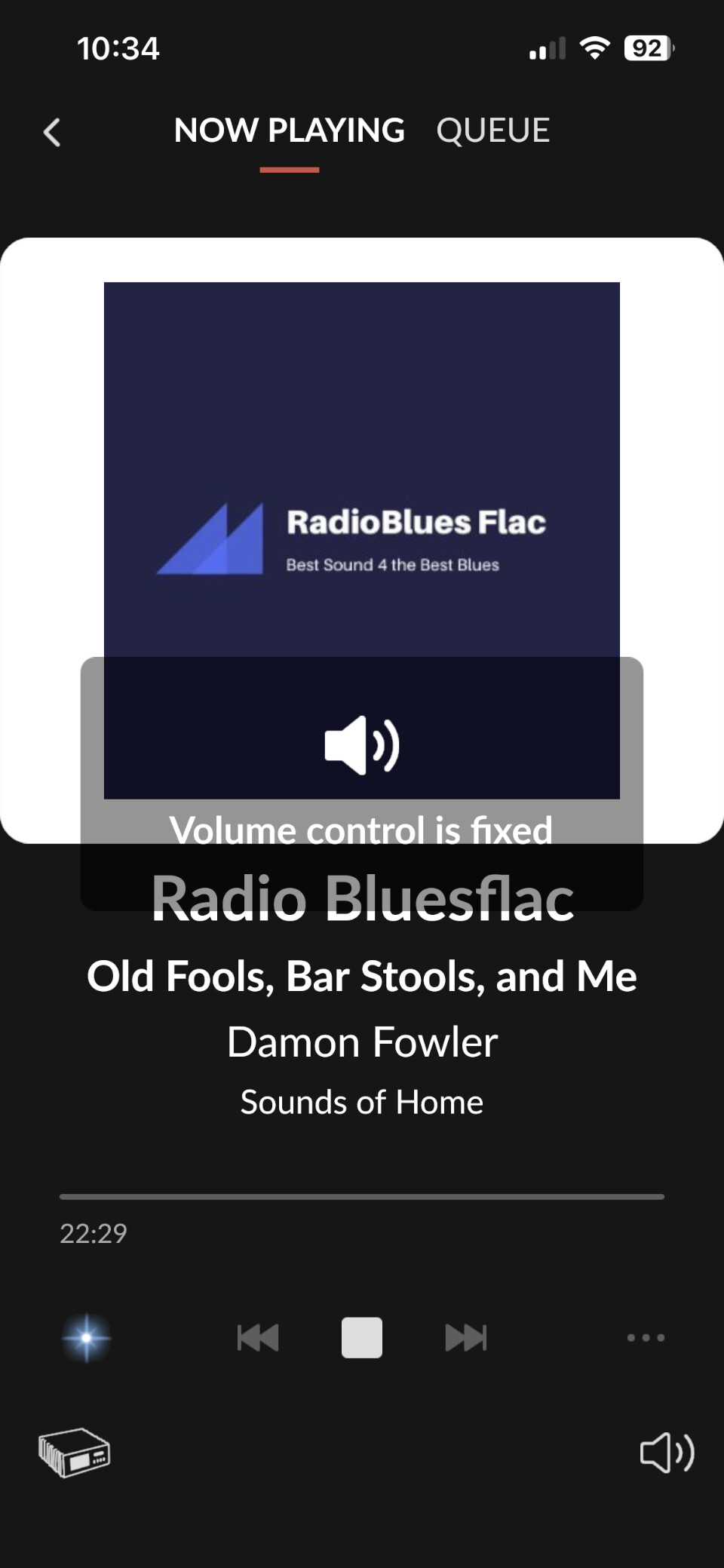

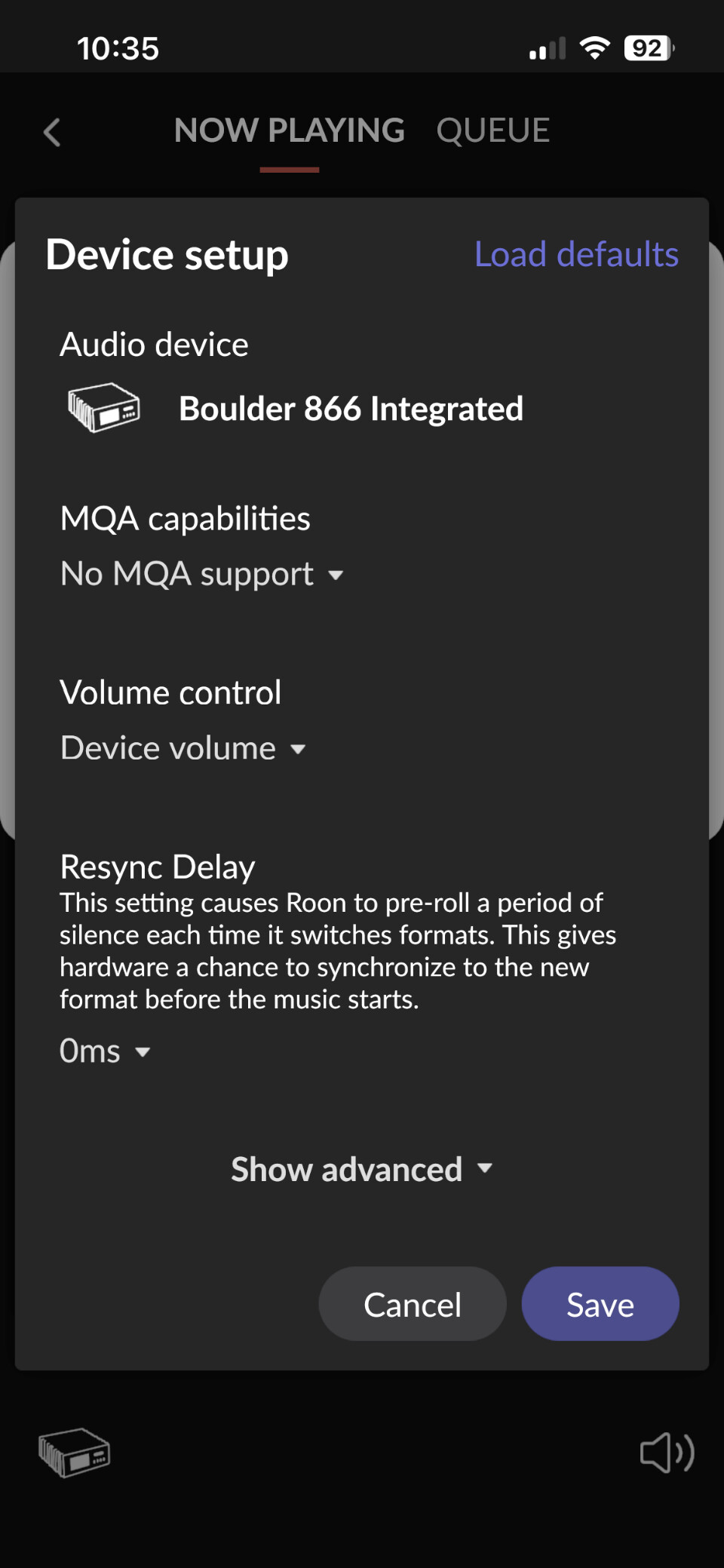

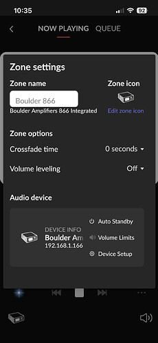

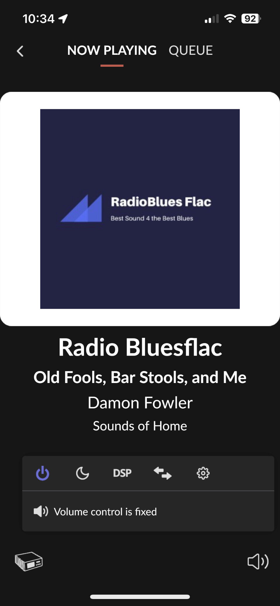

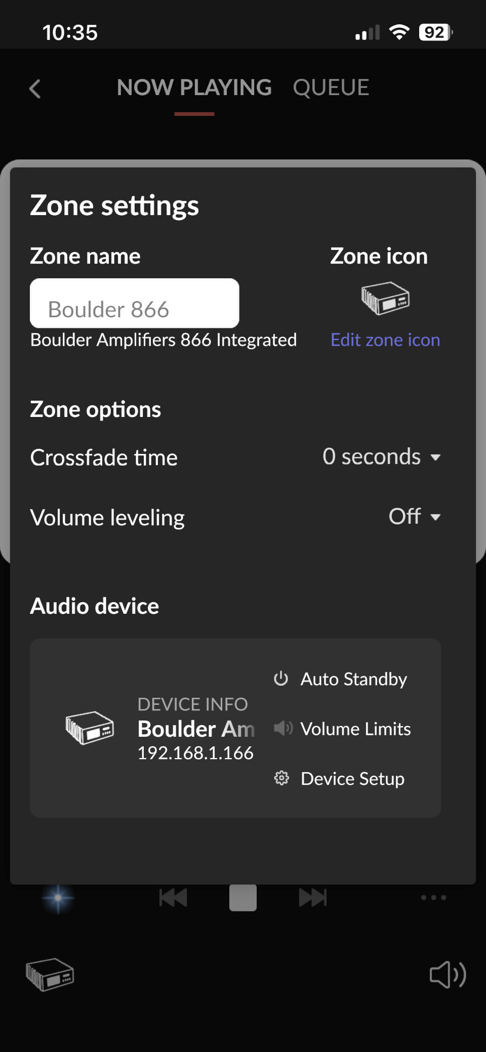

Roon is stuck on Fixed Volume. I’ve rebooted my computer. Turned off & unplugged my Boulder 866. All the settings show that the Boulder 866 is set to Device Volume, but the Fixed Volume problem remains.

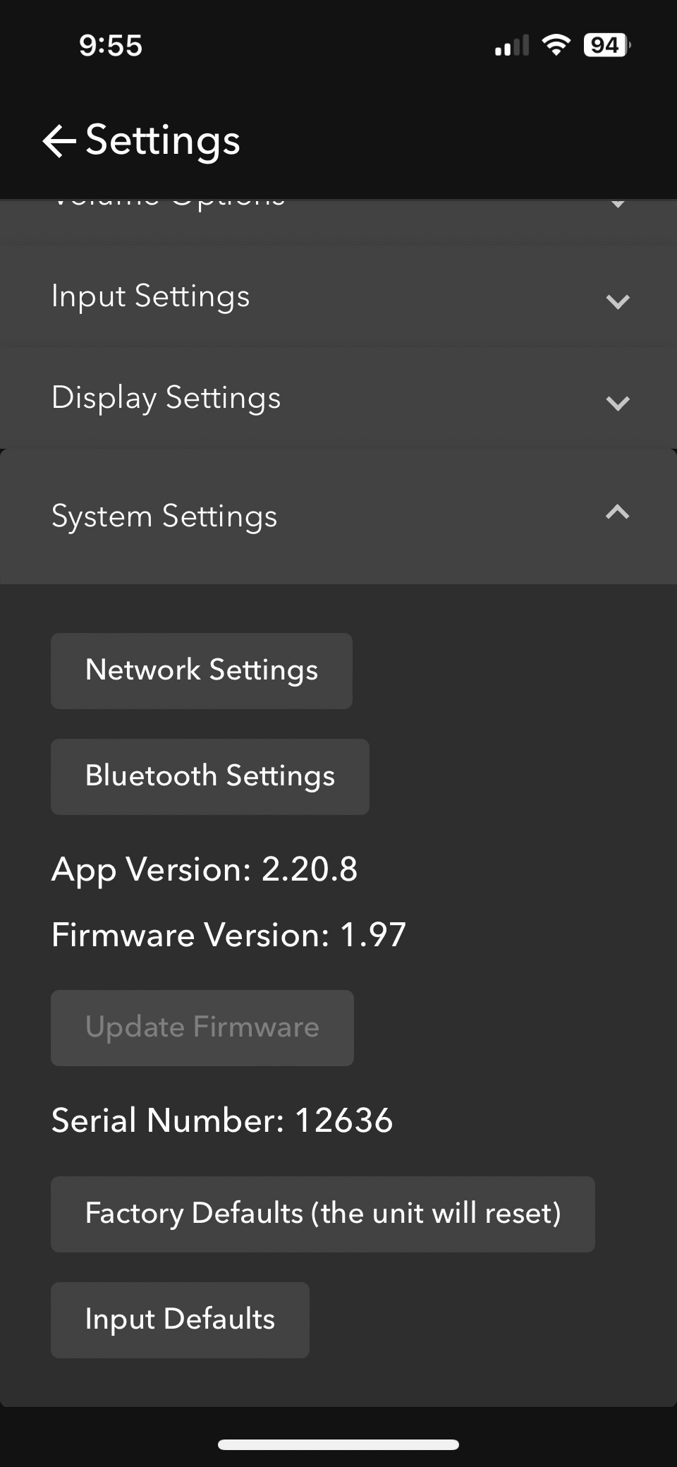

Do you run some beta firmware on the Boulder (their documentation stops at 1.91)?
Did you potentially set the network input into Theater Mode?
No. The firmware update was just released. I had been using 1.91 since I got the 866. I had the same volume problem with 1.91. I thought updating to 1.97 might help, but nope. Looks like Boulder just hasn’t updated the documentation on their site. The input isn’t set to Theater Mode.

I did a factory reset on the Boulder 866 and that fixed the problem, but now it’s doing it again. Not sure if Boulder isn’t keeping their firmware up to date or some other issue causing this problem. I have other ways to control the volume though so it’s not a huge deal. Just more of an annoyance at this point.
Hello, I have exactly the same issue.
So far the only thing that has worked for me is a factory reset of the Boulder. I feel the problem lies within the Boulder somewhere at this point. Not sure if a firmware update or rollback is needed. I have to reset my Boulder again because it’s back to the same problem. Kinda blows because I have custom icons for my inputs so I have reload them every time.
