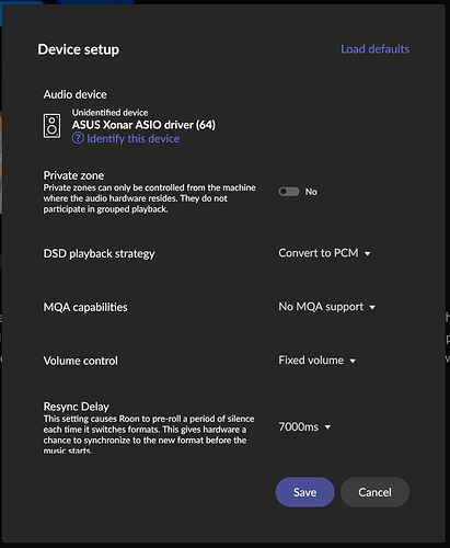

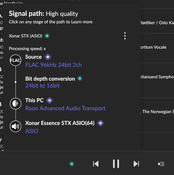

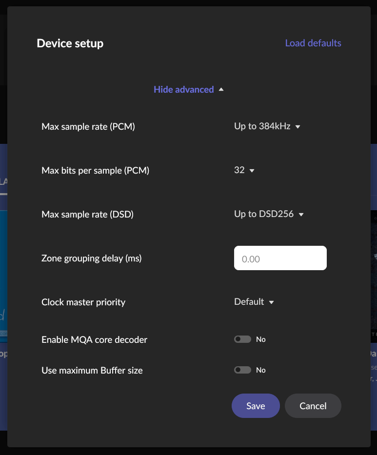

I was using my Asus Xonar STX Card on my PC and it was working fine on Windows 10 but after switching to Windows 11 I don’t get the option to set Max bit per sample (PCM) anymore. The option is simply gone. and now every time the song’s bit rate is higher than 16bit it is downgrading it to 24bit. I have tried reinstalling the driver and also tried other Uni drivers for Xonar STX nothing seems to work. Previously default Asus Windows driver for Windows 10 use to work just fine on Windows 10. Also there is no official Windows 11 Driver for Xonar STX card so am using the Windows 10 64 bit version on Windows 11.

@Satyajit_Dey, welcome to the Community. I don’t have a Xonar ST, but have you tried seeing if you can set the bit depth and sample rate by going into the W11 Control Panel and see what options exist for the Xonar under Sound? This is not the Windows 11 Settings menu, but the legacy Control Panel app? Also, while it is not visible in your screenshot, is your Xonar set to Exclusive mode in Roon?

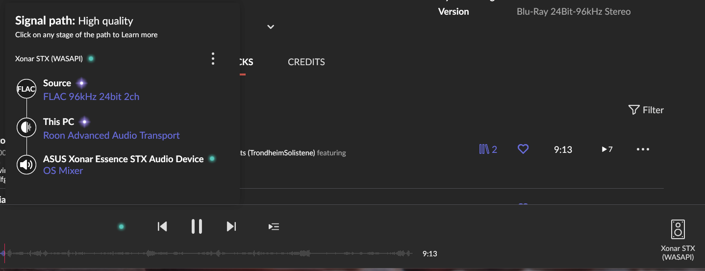

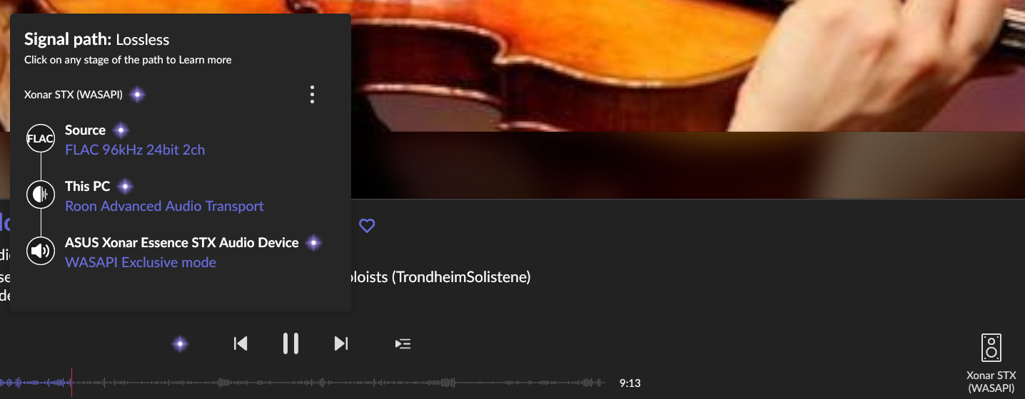

  2. There is WASAPI option but when I play through it the light is green.
  1. I didn’t find the Exclusive mode option for Xonar STX in AISO mode.

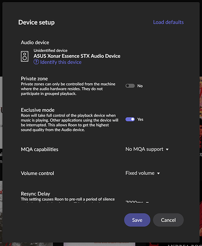

  1. I did enable the WASAPI mode for Xonar STX and I found the Exclusive mode option and turned it on. Now it worked. :smiley:

The problem lies with the default ASIO bit rate set by windows 11 after installing the Xonar STX drivers in windows 11. As there were no option in the Xonar control panel to set the bit rate for AISO I stumbled upon a small module “asioconfig.exe” in the [UNi Xonar Drivers 1.81] (UNi Xonar Drivers official page) page, as I was trying to use UNi Xonar drivers instead of official ASUS drivers previously to solve this issue.
I downloaded and ran the “asioconfig.exe” file and wala… the AISO bit rate was set to 16bit by default.
I quickly changed it to 24bit and applied.

Immediately went to roon and ran a song and finally it ran perfectly.
(I turned on a few EQ and volume normalisation options after it ran smoothly so that is why the screenshot has those shown in the processing part)

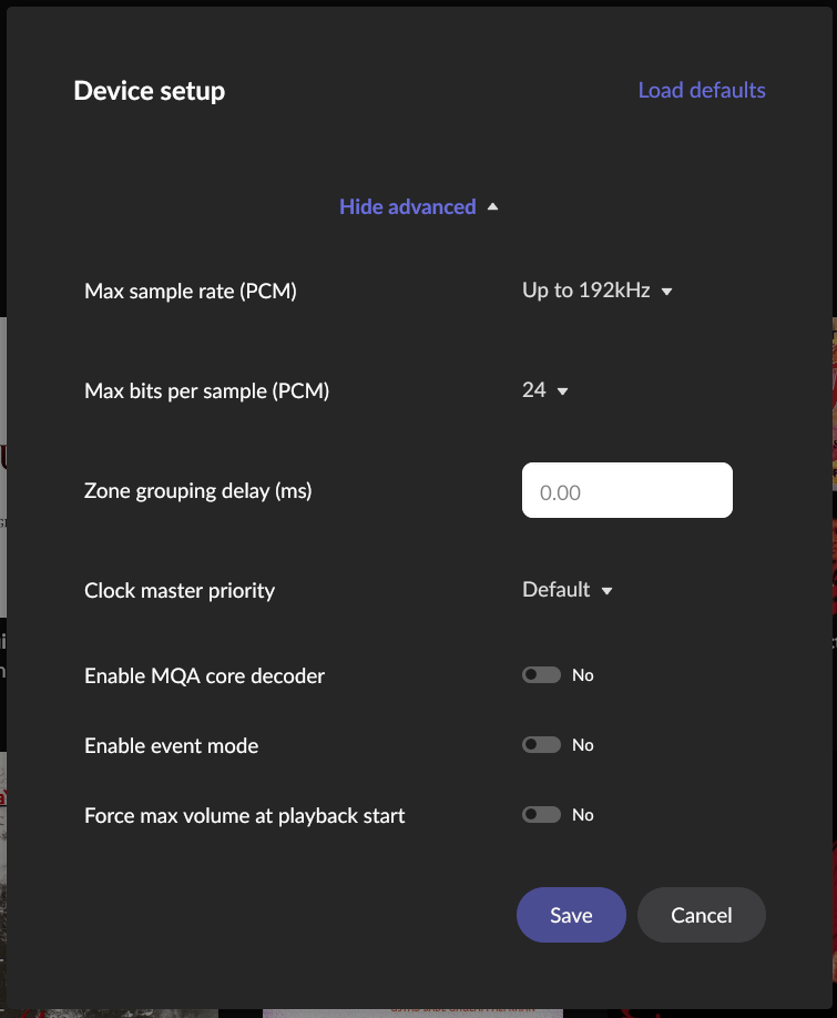

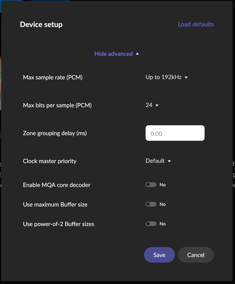

Then I went into the settings for Xonar STX ASIO and found that the option for setting the bit rate and more options like MQA, DSD, etc. also showed up along with the option to change bit rate just as it was in Windows 10.
Previously before issue was resolved, bit rate was not showing (for reference):
I dont know how the “asioconfig.exe” fixed the issue and let roon get the proper ASIO info from the Xonar STX device but it worked for me.
