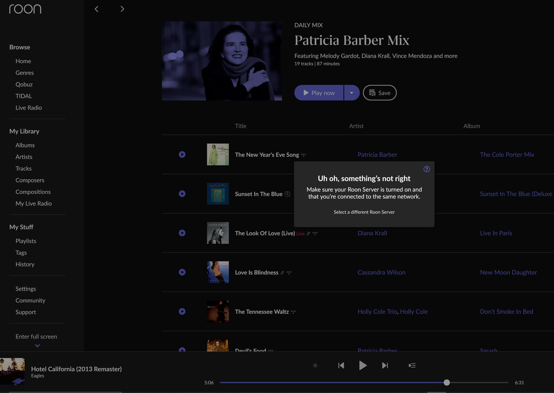

I rebuilt the NUC (nuc11pahi7 - 11th gen, 32GB RAM, nvme Samsung 980 pro 500gb) with Archlinux (Audiolinux V3 verison), set up Roon Server logged in Roon and Tidal + Qobuz (small library of them)… and no local library or NAS…
It has frozen and lost connection 4 times since yesterday for no apparent reason… just playing music with no additional filter or anything else. With no network issue ro something like that.
I restar it and play again… it run for intermittent time… sometimes 1hr, another 4hrs with no problem, or just 30min and freezes again.
How can I investigate it?

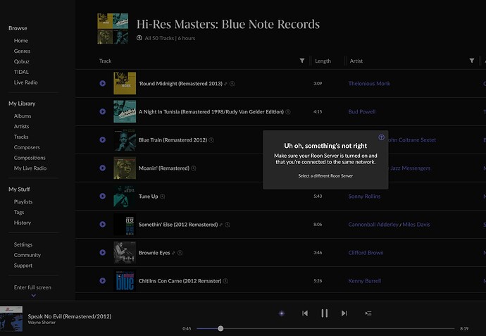

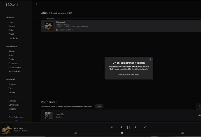

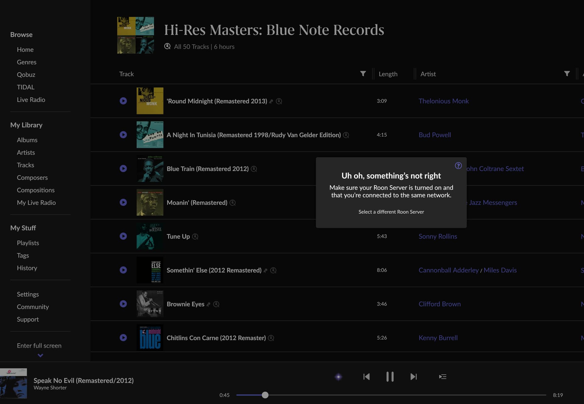

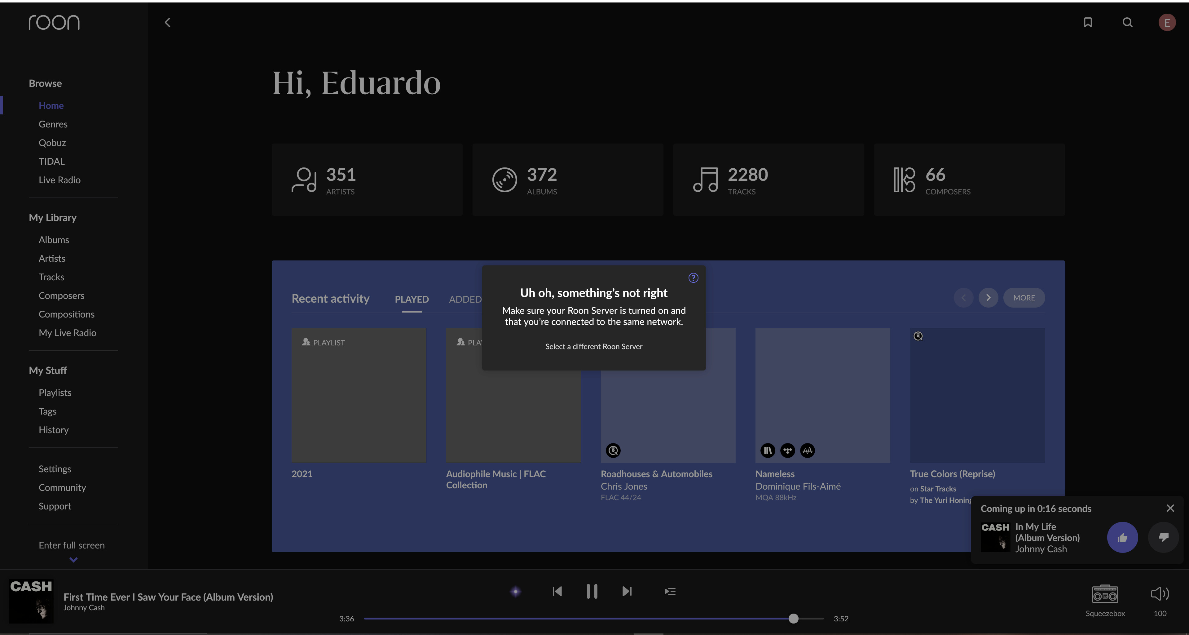

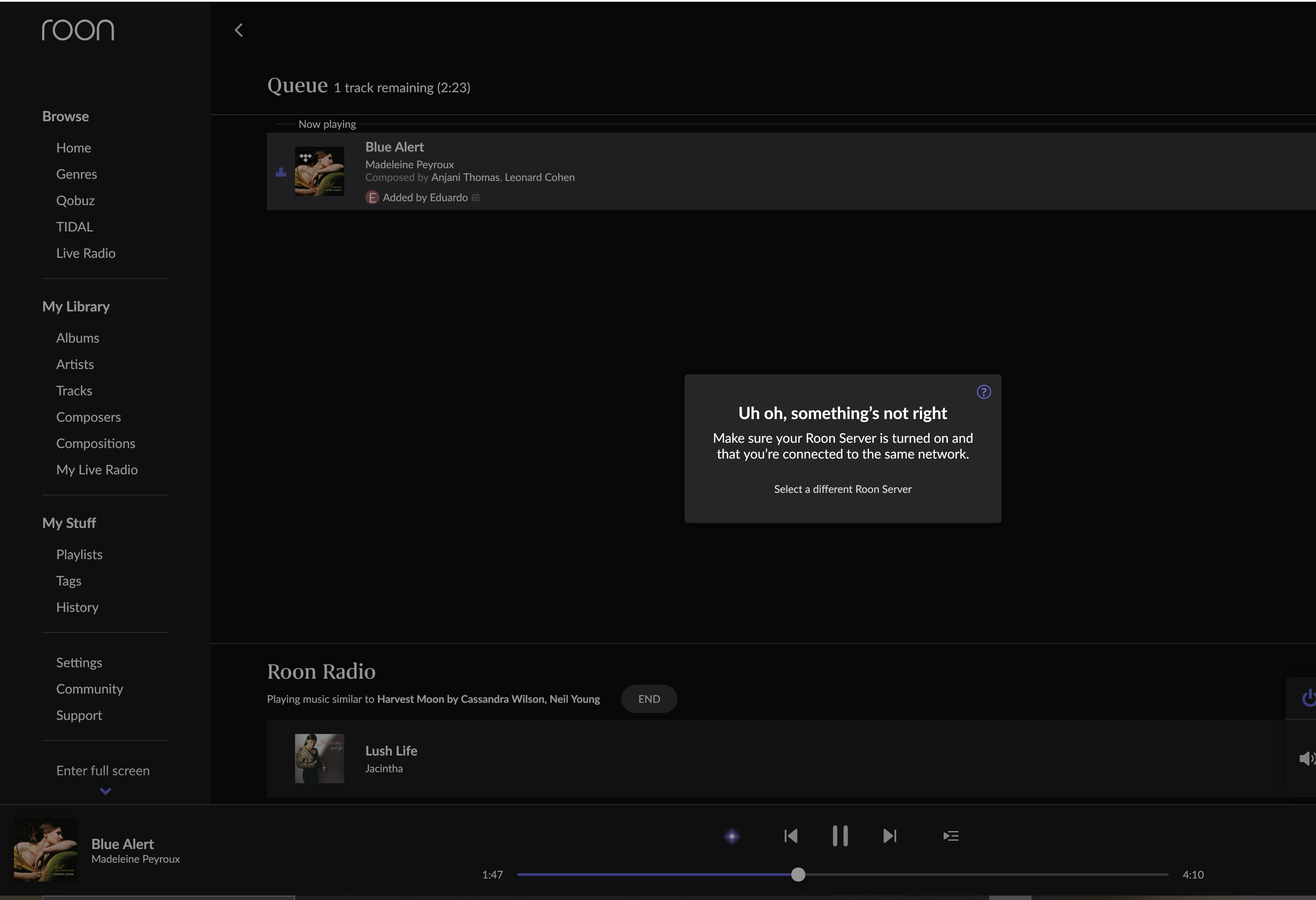

Hi @connor ,
Here is the error… exactly at this moment.
Disregard any previous event as it was under control.
I started playing 40 minutes ago
Again…
