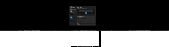

  • The screenshot below shows Roon failing to start on display 4. Note though that it also fails to start on displays 2 and 1. I initially thought that the lower DPI of my smaller screen could be the culprit, but that proved to be a red herring.

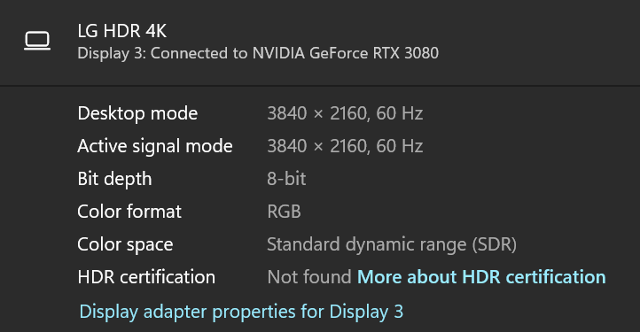

Main display info (same for all 3 top displays):

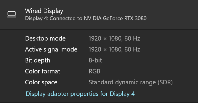

Bottom display info:

The reason I came to believe the lower DPI display hypothesis may be a red herring is because I am able to reproduce the issue on the two secondary displays (to the left and right of the primary display) that are identical to the primary display, and identically configured (same display resolution, scaling, color space, etc). I was able to reproduce the issue both with and without the lower DPI display connected.
For completeness, here are the current display configurations:
And this is the desktop configuration:
  • Display 3 is the primary display
  • The scale for Displays 1,2, and 3 is set to 150%
  • The scale for Display 4 is set to 100%
