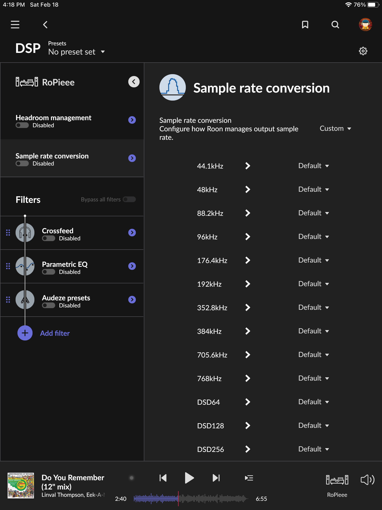

Without more information I can only guess but this can happen when playing to a DAC and the sample or bit rate is different between tracks or when going to/from MQA.
Unfortunately this is a consequence of the particular DAC architecture and not Roon.
If this describes your use case there are some work arounds:
In Device Settings try adding Resync Delay.
Start small and gradually increase and see if that helps.
If that doesn’t help try going to DSP settings and configure Sample Rate Conversion so everything is converted to the same value.
I’d suggest 44.1Khz to start with as higher values can be more demanding on your Roon Core and could introduce another issue.
Edit: It just occurred to me there is an easier method to accomplish sample rate parity rather than setting sample rate conversions.
I can elaborate if the issue is in fact occurring between tracks of differing rates.
