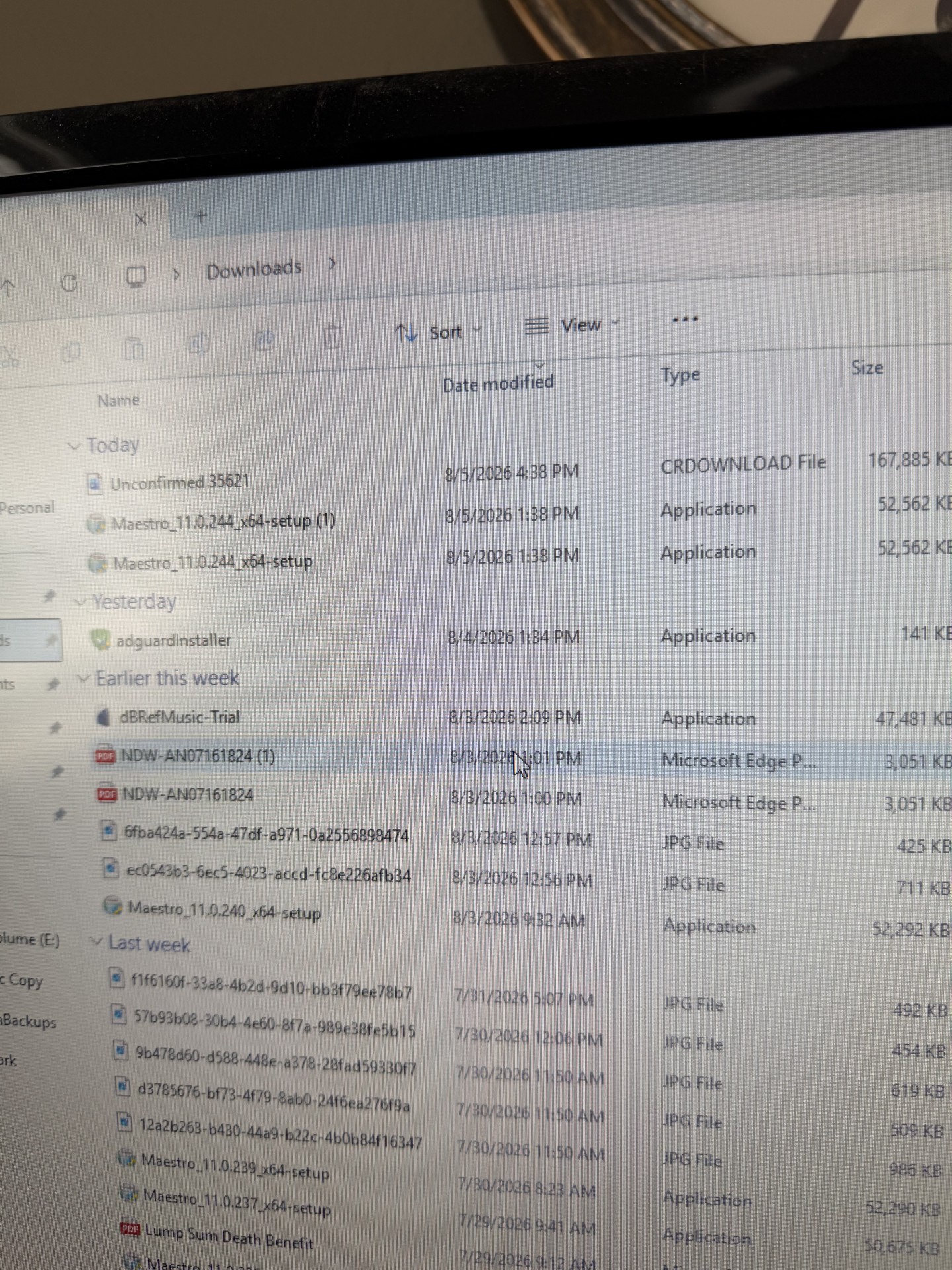

· Had much trouble uninstalling ROON as I thought it was corrupted. I finally got it removed from Windows 11 hoping a new download would work. It didn't. I keep getting the "unsafe" warning when it is downloaded and the pictures show the garbage that is in the download. Never had any serious problem with Roon until now when it wouldn't import my files on a USB hard drive and now I can't even get it installed again

We think we can answer your last question, and the answer is in the screenshot you sent us.
Look at the top line, “Unconfirmed 35621”, 167,885 KB. That is not a Roon installer. It is a partly downloaded file that your browser never finished and never renamed. So the unsafe warning and the garbage you saw are the same thing: the download is not arriving intact, so there is nothing complete for Windows to install.
As for what changed when you changed nothing, look two rows down. AdGuard was downloaded on 4 August, and your failed Roon downloads start on 5 August. AdGuard works by inspecting encrypted web traffic as it passes through your machine, and tools that do that are a common cause of large downloads arriving damaged or being flagged. We cannot prove that is what happened here, but the timing fits and it is the first thing we would rule out.

Please open AdGuard, switch its protection off, download Roon again, then switch it back on.
If you would rather not touch it at all, please download Roon in a different browser instead. Microsoft Edge is already on your machine, and it will not be going through the same filtering.
