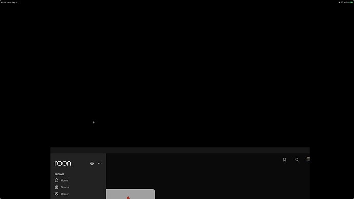

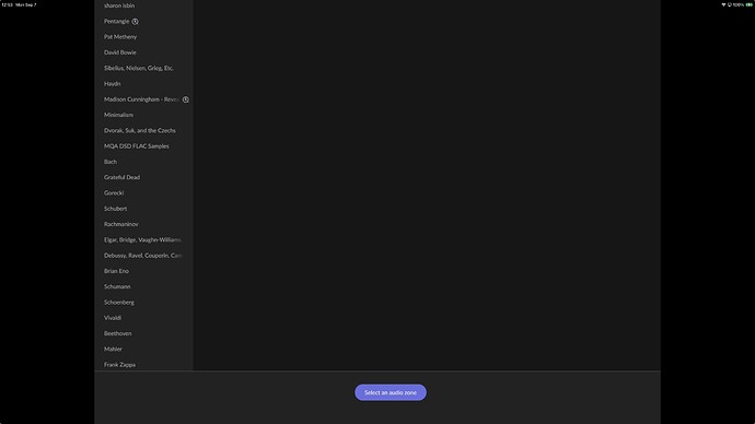

· Roon iPadOS client behaves strangely when iPad Pro is connected to external monitor. Specifically, it adopts the resolution and aspect ration of the connected monitor, fails to render the home screen, and presents an incomplete navigation bar on left. This happens whether the client is on the iPad display or the connected display. This is just a bug report for future prioritization.

I’ve added some screen shots showing two variants of glitchiness:
