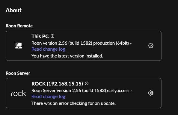

Sometime between either the update to 1582 or 1583 Roon stopped connecting to Tidal and is extremely slow to load anything server side, search stopped working and doesn't display artist info or metadata. It became and local-only offline player (albeit a very expensive one at that). Trying to reconnect Tidal works authenticating but Roon never leaves the "Waiting for Tidal Login" dialog. Even Settings > About times out while checking for updates and goes "There was an error checking for an update".

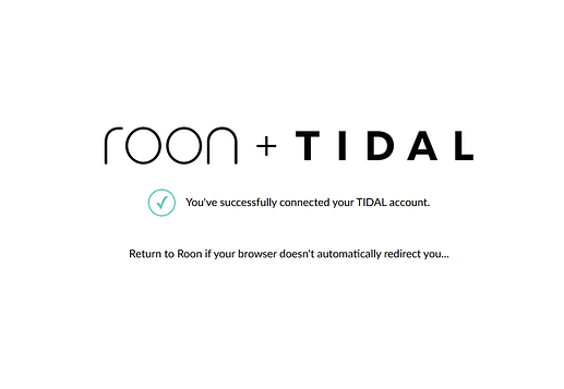

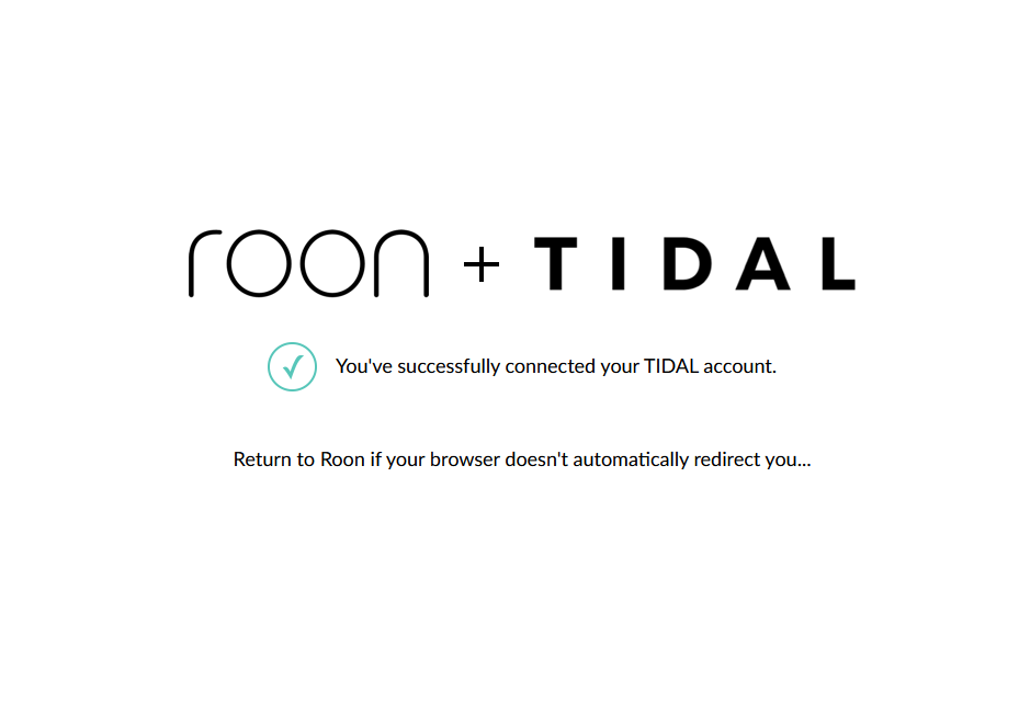

Of course. It’s logged out of Tidal in Roon. I can’t log back in. Even thought the login process works:

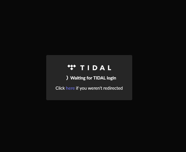

After returning to roon, it never leaves this dialog:
This happened every single time I tried for a few days now, the latest right now at Nov. 3rd, 8:05am.

To recap: nothing changed in my network physical or config setup, I can still access Rock’s storage perfectly fine, such as to add a few albums bought last friday. And to go to \ROCK\data\reinstall to place roon-production.bin in order to reinstall into production edition to see if it solves it. It didn’t. Search doesn’t work. Streaming doesn’t work (even with Qobuz, apparently still linked). Can’t link Tidal. Live portions of the home screen doesn’t refresh anymore (Roon mixes and such). Settings > About times out while looking for an update.
The only variable between Roon working and my current state was a dreadful 1583 update.
