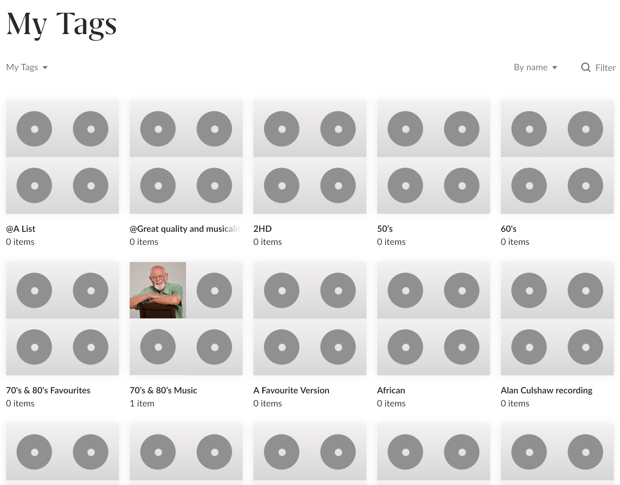

I recently had to restart my router, which changed the IP addresses for my devices (always a pain). When I reconnected my Synoptics music server to my NUC and the Roon client on my Mac, the Roon library was empty. It rebuilt overnight (I have about 17TB of stored music...), but the Tags, etc. that I had set up were not populated. I restored an earlier library, which was on Build 1368, not 1382, which also brought the old IP address and I needed to upgrade the software release and the result was - no Tag population, just as before. I do not have a backup on 1382 that holds the populated library.

Yes, I understand the need to edit the IP address after the restore, but that does not address the problem. The status shared is after that has been done.

Let me repeat myself. After the router restart, I reset the IP address to the music server and, for some reason, the Library was not showing correctly. I reinstalled the latest copy that I was sure was prior to the router restart, which was the prior Roon version. To my surpise, the reinstall of the library also returned the old IP address for the server, which I again reset, but only after Roon had required me to install the latest Roon version. As I write this, can you tell me if there is an option to not upgrade the Roon version whilst this is resolved? The Roon version on my Mac is also the latest version.
IMO, the issue is this entanglement of having to recover a library from the old Roon version. I’m not sure what role the IP address change is having.

I set static IP addresses on the router and the server to the settings previously being used and I have recovered the library. :grinning:
