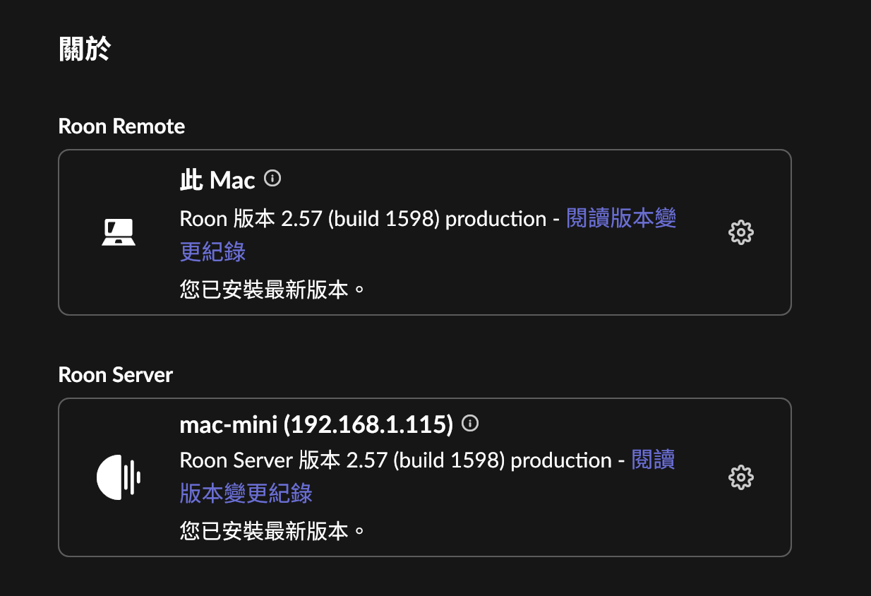

Thanks for the detailed analysis.
I’d like to clarify one important point regarding the environment:
My Roon Core is running natively on macOS (Mac mini), not inside Docker.
In Roon Settings → General, the active Roon Server is shown as “mac-mini” (this Mac).
There is no Docker installation on this system, and Roon Server is not containerized.
Given this clarification, the behavior observed (endpoint loss after pause / stop / track change) is occurring in a supported, native macOS environment.
Please let me know how you’d like to proceed from here, and whether you’d like additional diagnostics captured under these conditions.
