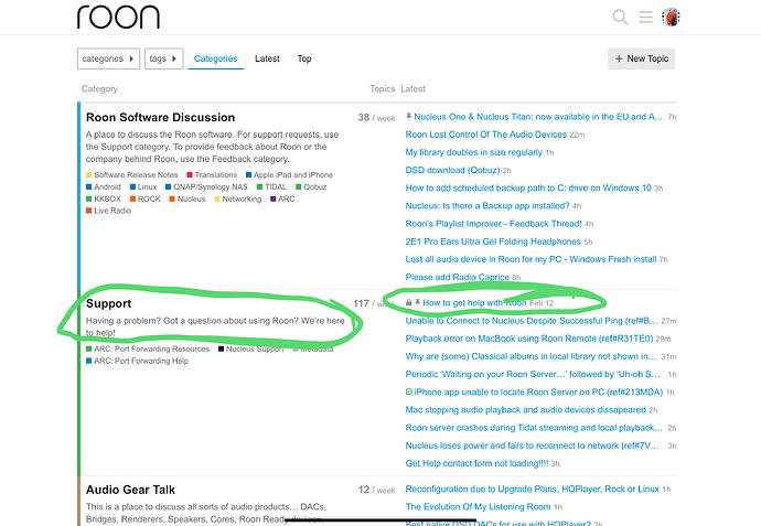

As for the issue, there are repeatedly posts about issues with Sonos - I don’t have Sonos devices, so I don’t know details. If you have issues with Roon that you need help with, it is best to post in the Support section of the forum, not under Roon Software Discussion. This collects more information for support staff to work with, and Support is monitored by Roon Labs.
