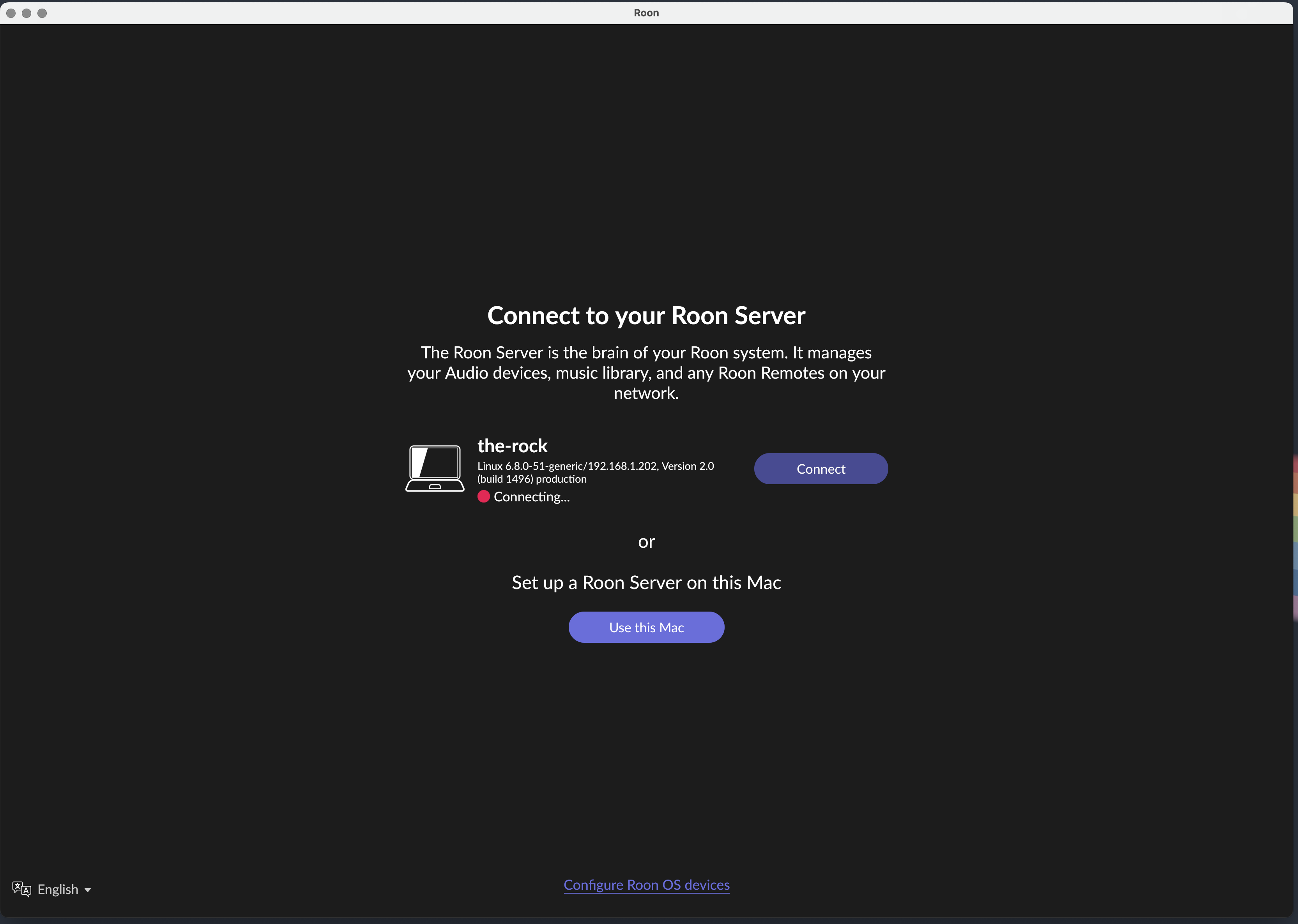

  • Happened after latest Roon Server update.
  • No changes in anything from working condition - that is, basically, roon server update was the only thing changed in the setup, then it stopped working
  • Running on ubunt 24.04 server, Client on Mac OS X Sequoia 15.2, Mac Mini M1 2020. 16GB, Firewall inactive, tested both wired and wireless.
  • UPDATE AFTER CREATING TICKET - just occurred to me to check other devices - working fine from Samsung phone on the same network.
  • Roon Client
  • Restarting the server makes the client find the server but still unable to connect, as depicted in the screenshot
  • Endpoints connect to server no issue

Unfortunately, NO. It failed again, same symptoms. Proceeded to to the remove Library and re-install. Worked right exactly ONCE. Android app on the same network still works. Again ISSUE STILL VERY MUCH PRESENT.
Update after a shutdown of the Mac Mini, it is able to connect again. I won’t be marking this as a solution until I am sure it doesn’t re-occur. If you have other suggestions in the meantime, they will be appreciated
After reboot of the Mac problem reoccurs - I can safely say that removing the Library and re-installing did nothing. Any ideas? This is annoying.
