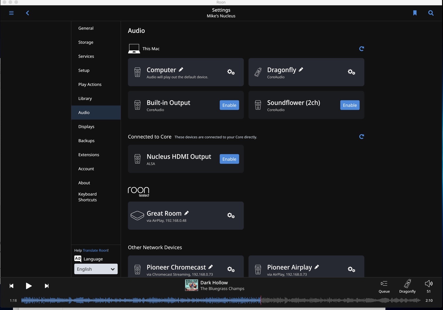

Hi @Zoren,
Can you please share a screenshot of your Roon Settings -> Audio tab? Are these devices missing from multiple remotes controlling your Nucleus?

Switched the core to my computer and it found those devices, switched it back to the Nucleus and they were gone again.
Ok, I fixed it by plugging the Nucleus straight into the router vs the Netgear switch I have most of the house routed through. Don’t know why this suddenly mattered when it has been set up like that for months.
