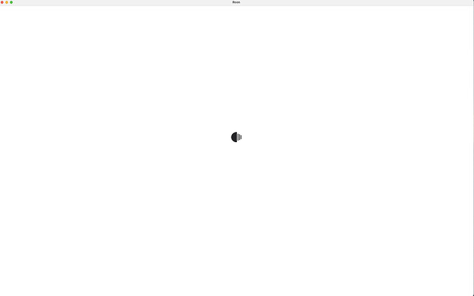

This has been the screen since I opened Roon several hours ago

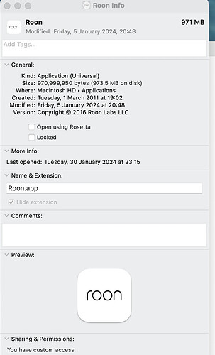

So - as far as you can be sure - you are using Roon version 2 build 1359; in the Finder Cmnd+I should show a date close to January 10 2024?

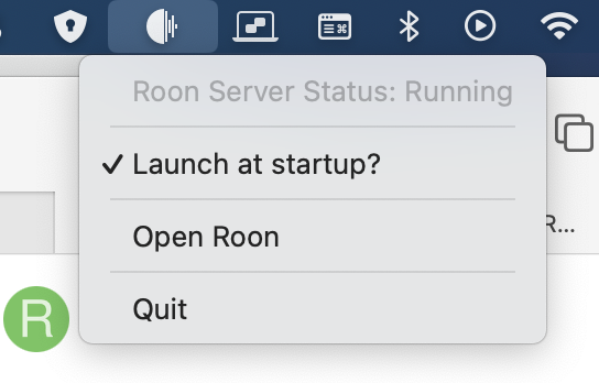

Is Roon Server running in the taskbar:
Server Running?

and yes, the Roon menu bar appears at the top of the screen - but whatever you select - nothing happens
and the Roon service running - is Ghosted

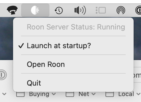

Screenshot 2024-01-30 at 23.40.26

Ray,
Your screenshot suggests that the Roon server is running.
What happens, though if you quit the unresponsive Roon, restart your Mac Studio, and then single-click on ‘Open Roon’ from that menu in the taskbar?
Just to clear up two other things: as far as you can be sure - you are using Roon version 2 build 1359; in the Finder Cmnd+I should show a date close to January 10 2024; Yes?

Hi, it Ghosted as it’s not selectable … but the shown status “Running” will be correct.
