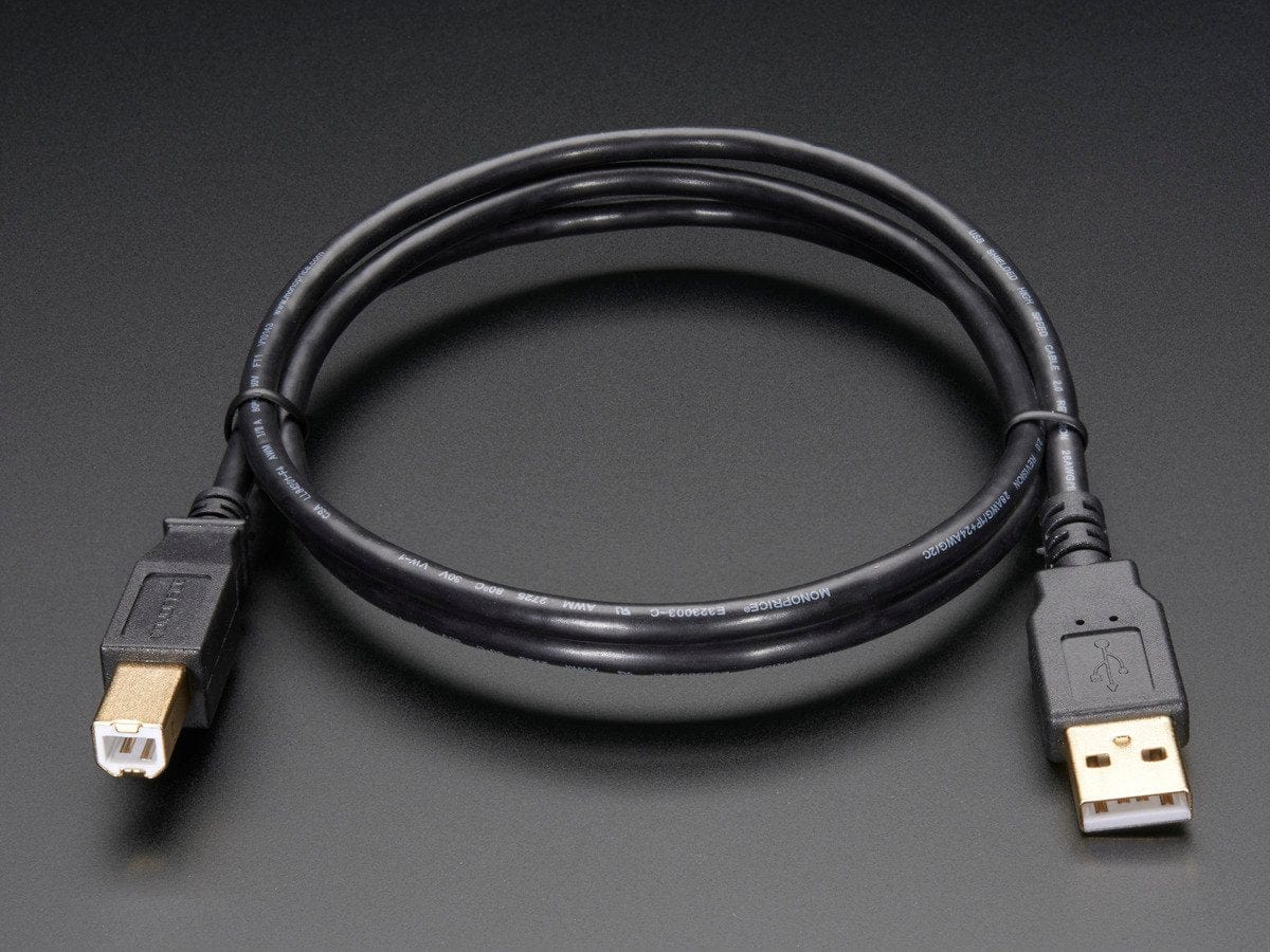

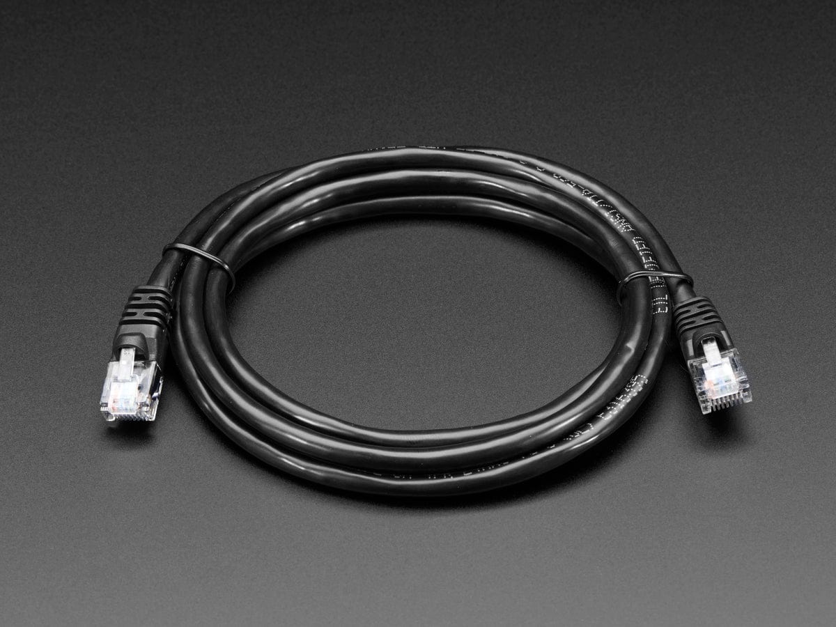

All you need is the following:
Once this arrives, assemble, i.e. put it in the case, download RoPieee and copy the image to the SD card using Etcher. Then insert SD card in the Raspberry Pi. Finally, connect the Pi to your network and the CX81 using the USB cable, and power up.
You’ll then need to open a web browser and point to http://ropieee.local to configure the endpoint.
