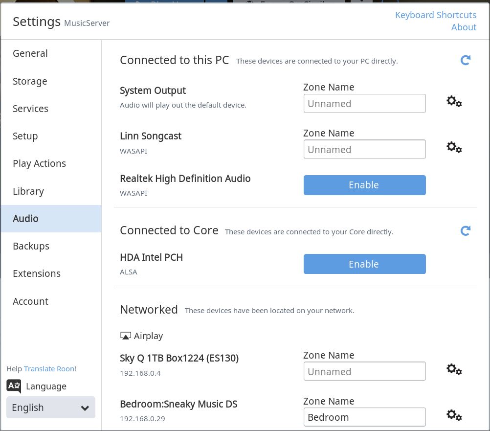

Can you share a screenshot of the Networked section of Settings > Audio, like this::
