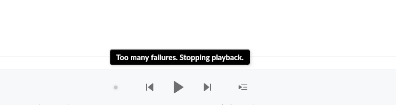

When it is plugged in I get the dreaded “Too many Errors” prompt…

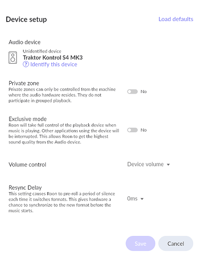

In Roon > Device Setup, disable Exclusive Mode for the S4MK2 and see if that frees it up.

So, this is the error. Received when the Traktor S4 mk2 is plugged in A(and either choosing the laptop or Traktor as my sound zone)

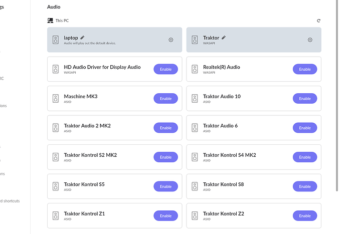

And I have these options under Audio. The Traktor selected in the Traktor S4mk3 in WASapi mode.>>

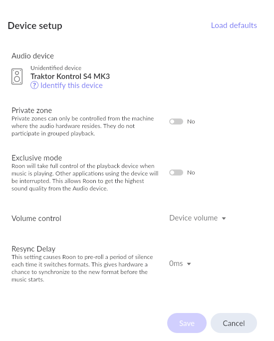

The settings for which are as follows…

I don’t have the ASIO option for the S4 mk3 for some reason (I do have it in Traktor when running that software).
