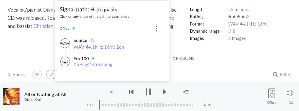

Roon will play to System Output and to one of my Sonos speakers, but not the other two. They are all on the same wifi network. The Sonos app and Qobuz are able to play to all three. This happens with music from my laptop hard drive (where I am running Roon) and from a NAS I have to store CDs. It thinks the song is playing (i.e. I hit the play arrow and the pause symbol is available), but the song doesn't progress. The Signal Path is high quality. I can't see any way in which the Sonos units are set up differently. The one it works on is a Sonos One, and the others are an Era 100 and Era 300. Thank you.

Do you see the same issue when streaming over the Sonos protocol rather than airplay?

How do I change from airplay to the Sonos protocol?

There should be two listings of your Sonos device in the Roon settings → Audio page; one for Airplay and one for the Sonos protocol. Simply enable the Sonos protocol entry and you will be able to use it. I advise editing the names of the two entries to denote which one is Airplay and which is the Sonos protocol. Please let us know if you run into any trouble doing this!
That worked! Thank you!
