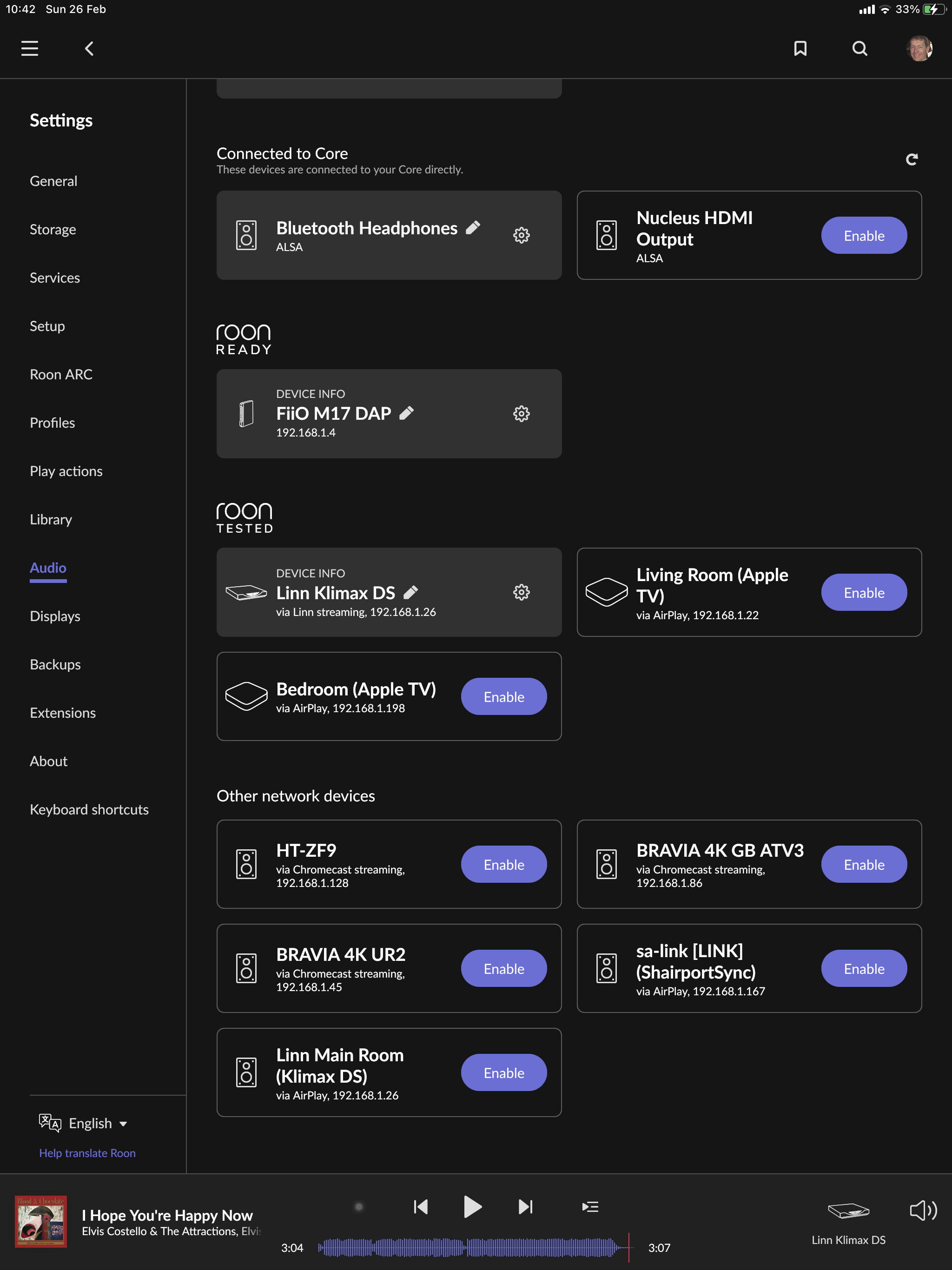

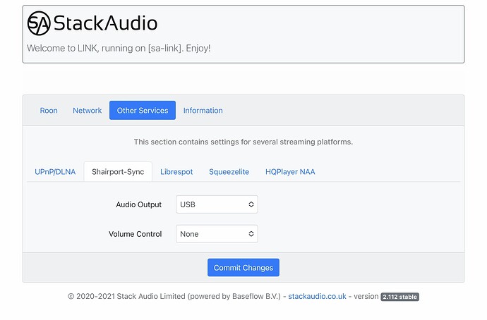

Roon no longer detects my Stack Audio LINK II.

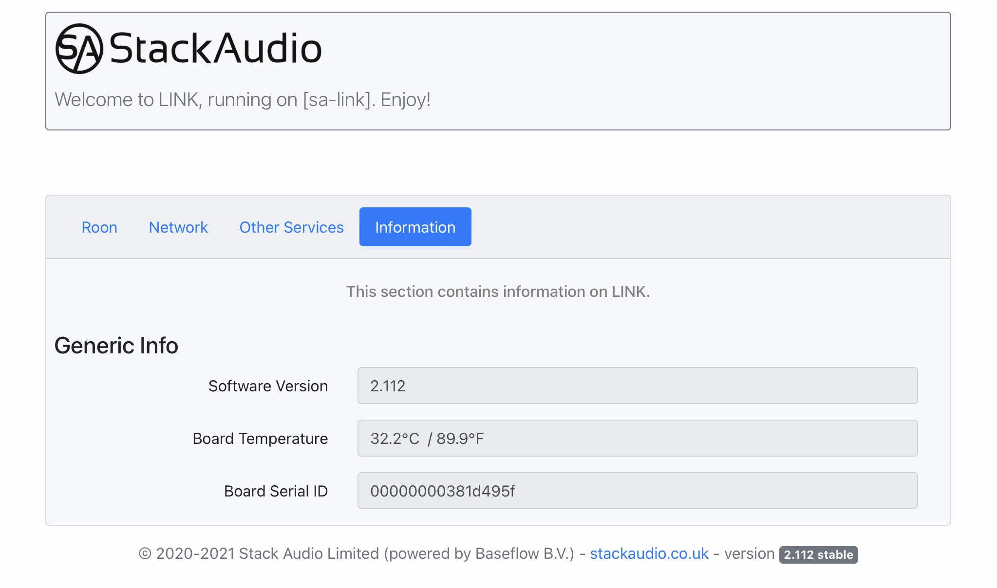

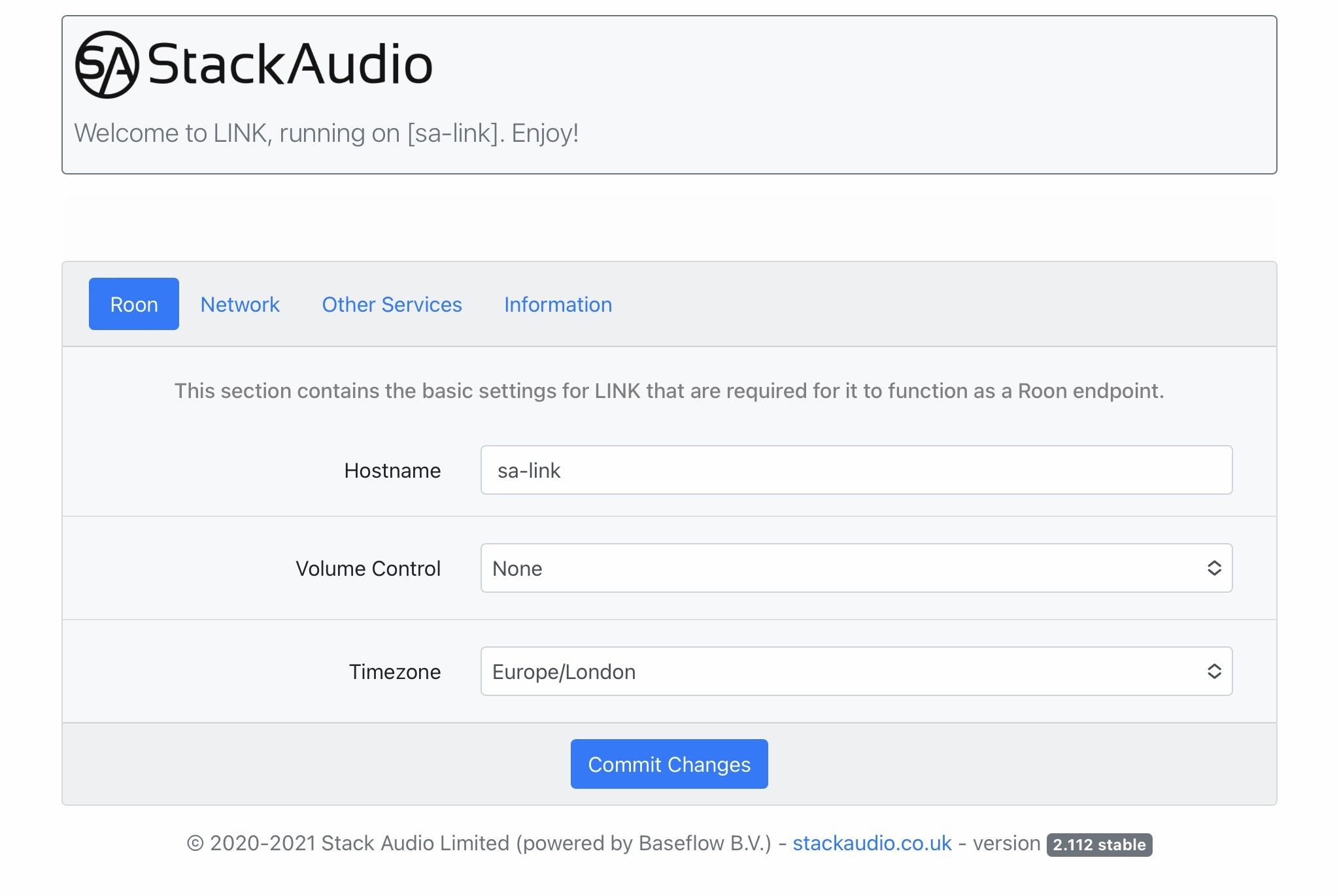

It is clearly visible on the network via Stack Audio’s interface, but Roon fails to detect it.
I’ve tried rebooting my gear in the following order: Router, Nucleus and I’ve even reinstalled StackOS onto the LINK, but Roon still won’t detect the LINK. @StackAudio

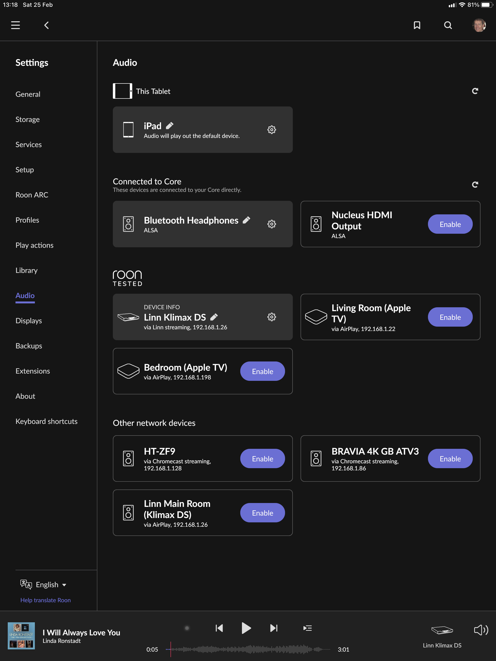

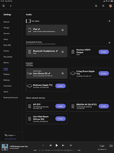

Does the Link show up in Settings=>About?
No. Unfortunately.

Have you tried enabling squeezebox mode and Squeezelite to see if that shows up?

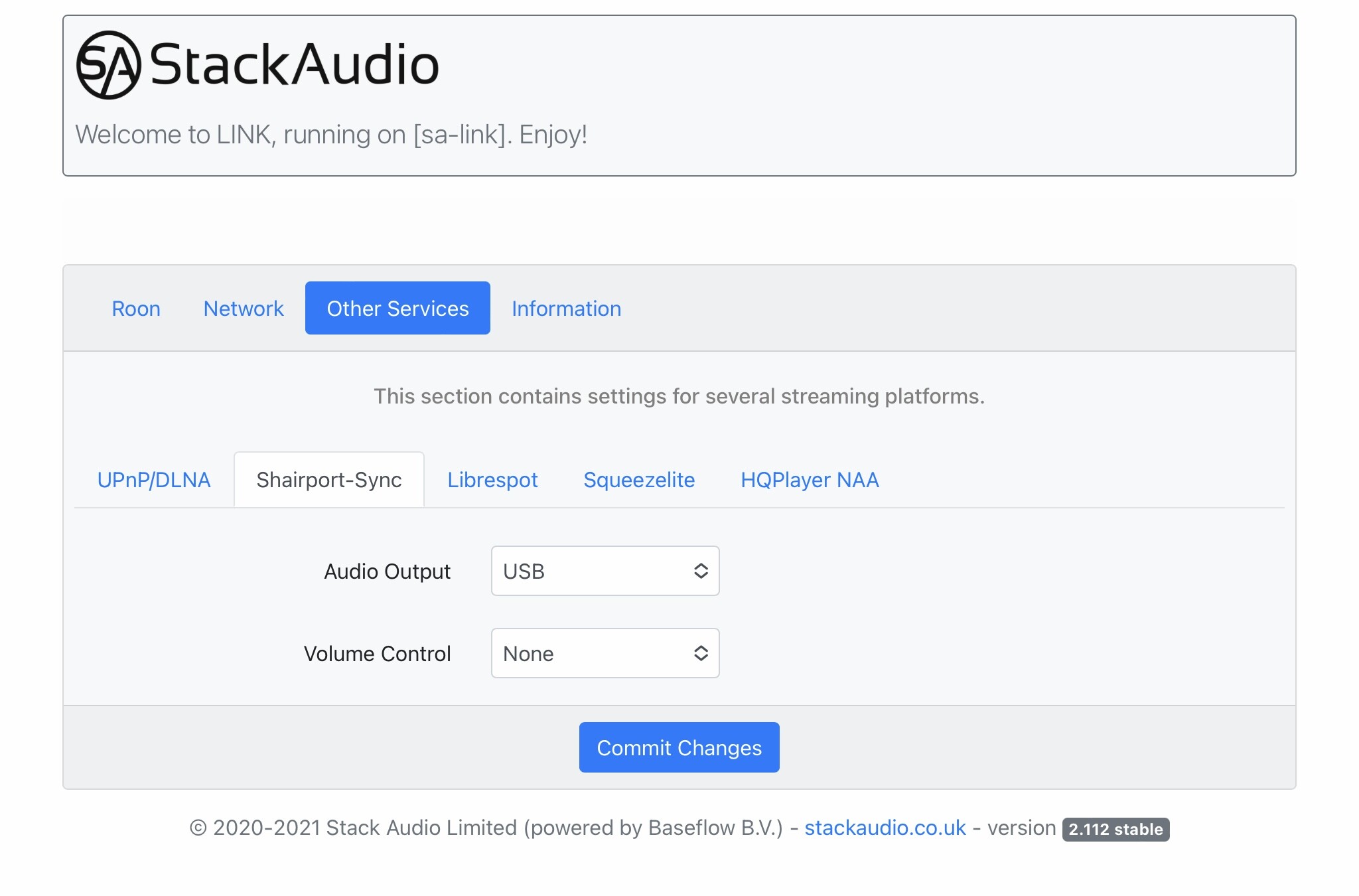

If I enable Shairport-Sync it shows up as an Airplay device.
But still not showing as a Roon Ready device.
I’m not sure where the problem is? With Roon or StackOS?
AirPlay uses a different discovery method to RAAT. How is it connected? To a switch or direct to router? Is the core on same switch or direct to router.

SOLVED!
In order for Roon to detect the LINK as a Roon-Ready device on the network, a DAC MUST be connected via USB AND powered-on in order that Roon can send files to the LINK. Without a connected/powered-on DAC, Roon will not ‘see’ the LINK.
